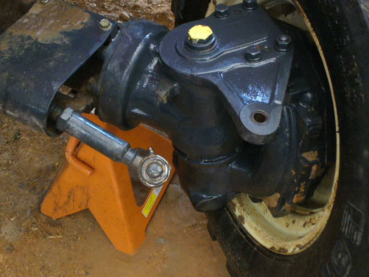

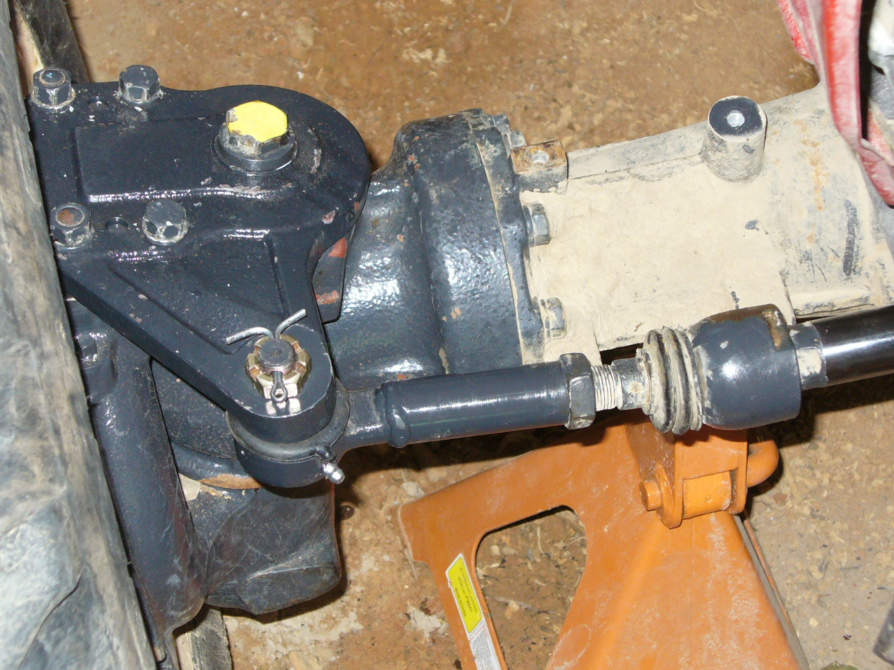

Installed the tie rod upgrade kit today. Figured I'd pass along some of what I learned. The upgrade kit involves changing both the tie rod ends and the axle top plates. The front axle was pressure washed before beginning as the axle is open for this change and I didn't want any crud to migrate in.
I changed the tie rod ends first. This requires removing the tie rod end guards. The new ends share the same end to center dimension as the old ones. I backed the lock nut off a quarter turn and then threaded the old end off. I threaded the new end on with a little thread lock tape until it was tight against the lock nut and then tightened the lock nut back the quarter turn. Note: There is a right and a left end - learned that one the hard way.
To remove the top plates I put the front axle on jack stands so the wheels where off the floor. I figured this would 'unload' the joint a bit. Since the top plate indexes inside the top pivot bearing and also appears to support the entire wheel assembly and the lower bearing I put a floor jack under the joint knuckle and lifted to keep the pivot assembly in place.
Removing the top plates took some patience. Ours were held on with a lot of the 'original' Lock-Tite, RUST. Repeated tapping with a mallet and wooden dowel worked them up and off. Liberal applications of Royal Purple penetrating oil also helped. I suppose a gear puller could be used - but it wasn't necessary. The top of the knuckle did not move when the plate came free - suggesting my floor jack idea was pure dumb luck. If you must pry the plates up get a set of brass machinest wedges - the surfaces are machined and the inner ring is a sealing surface.
After cleaning up the top surface of the knuckle and the new top plate (paint overspray and runs) I slid the seal ring on with a little oil. A 1-1/2" PVC pipe coupling worked perfect as a ring in the press. The top plate dropped back into place with only a few gentle taps and the bolts were taken back up.
The tie rod ends were made fast to the new top plates and greased. And while the gun was out the entire tractor got greased and the radiator screen cleaned - I could see it from where I was sitting in front of the tractor.
Total time - 3 hours. Now I have to get some Branson Gray touch-up paint.
