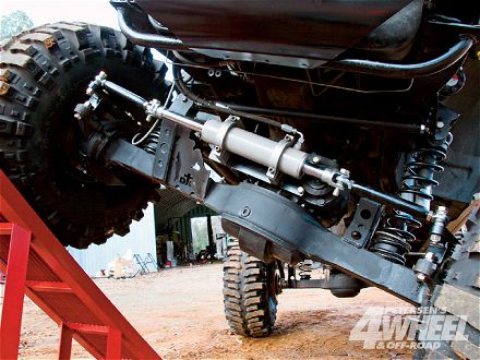

Keep it simple guys. It has two pumps, two sumps (both filtered) no remotes. In short, steering hydraulics are completely independent of main hydraulics. It's not a conventionally anchored DA cylinder either, there is no drag link. The TS steering cylinder is a smaller (but imbedded) version of the one in the photo.
