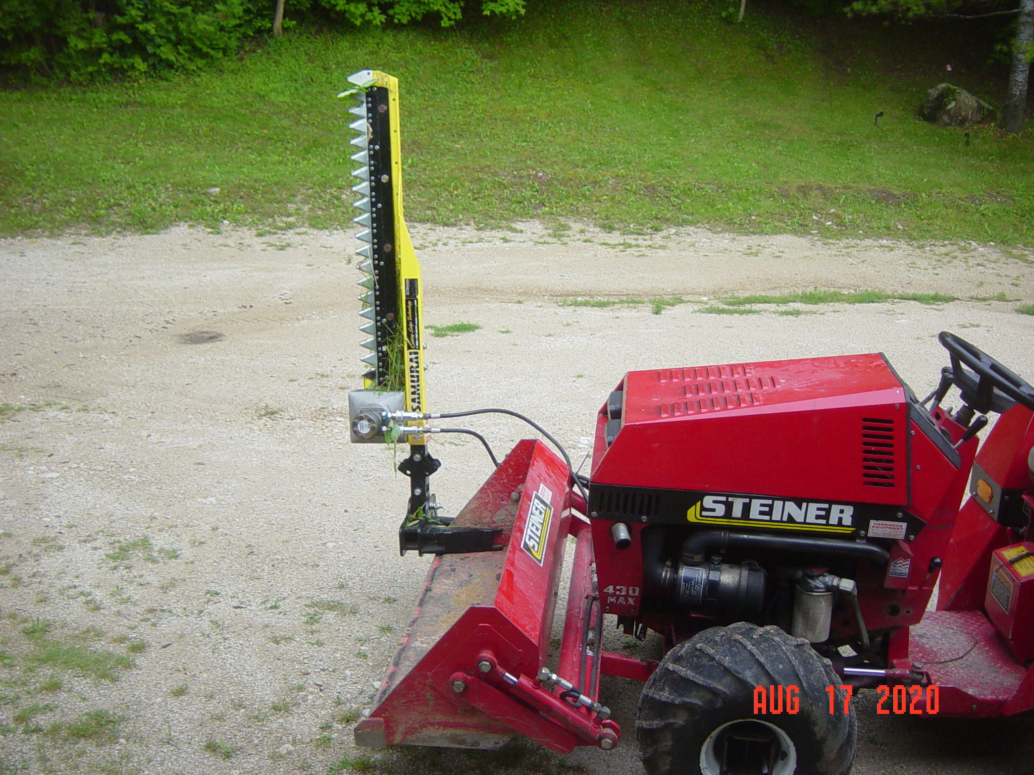

Let me start by saying that manufacturer suggesting this Samurai sickle mower can cut 1-1/2" branches is like saying a VW Passat can mow down 4" Hardwood. It's NOT a LIE! It's possible with GREAT DAMAGE!
I have always wanted to try this on the 430 MAX, that has little hydraulic power to spare.
First step was to see if Steiner would even move the sickle. Borrowed lines off a snowblower, to avoid much investment in this experiment. Machine required full RPM to get close to good sickle speed. Not the mowers fault, but unfortunate.
Tried on some weeds with poor results. Knives had been damaged from attempting to cut branches much smaller than advertised. Found some knives bent, making for poor scissor action. Dismantled sickle and straightened some knives.
Went to Pond, which is where this configuration would have been ideal.
The mower really needs a way to angle the sickle. Had this worked out, I would build a special carrier with an electric actuator for angle adjustment.
BIGGEST issue, is that the sickle gets choked by heavy, typical pond side vegetation. Probably not helped by damaged knives, but I don't think this is the whole problem.
It cuts maybe 5% of the vegetation and flattens the rest, making another kick at the can unlikely.
I would have LOVED for this to work.
Does anyone else have experience with this mower?
END of Experiment. FINISHED WITH ENGINES!

A sickle bar can be a fickle critter,
that samuri wasn't built for flat grass mowing that raised reinforcement behind the sickle will collect grass and plug.
Also it looks like your angle on the sickle bar was nose down it should have bee just slightly nose up.
A sickle bar works completely on shearing action the finer the material the more critical the shearing action,
the knives and guards must be in contact with the hold down bars keeping everything snug so as to be shearing,
other wise it's like trying to cut paper with scissors if loose they will not cut.

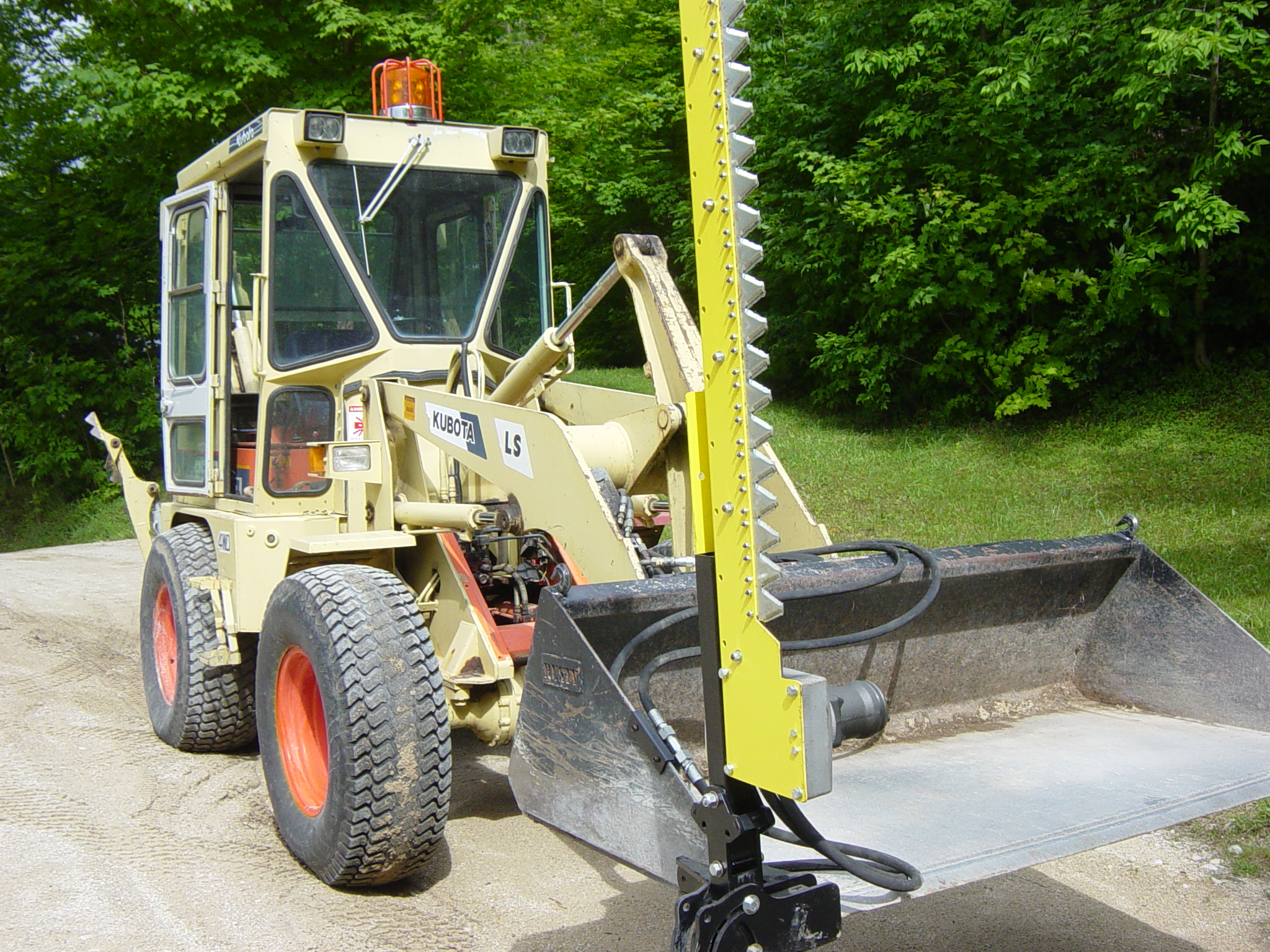

I did buy it for my loader. I see it more as a hedge trimmer and it does trim back soft Cedar branches quite well.
I would have liked to use the STEINER as I don't like driving larger equipment at ponds edge.

Interesting when I enlarged your picture I can see that they didn't use the finger type guards,
it looks like they have bolted on sickle sections for lowers and then the sickle sections on the bar.
I couldn't see haw many hold downs they have.
