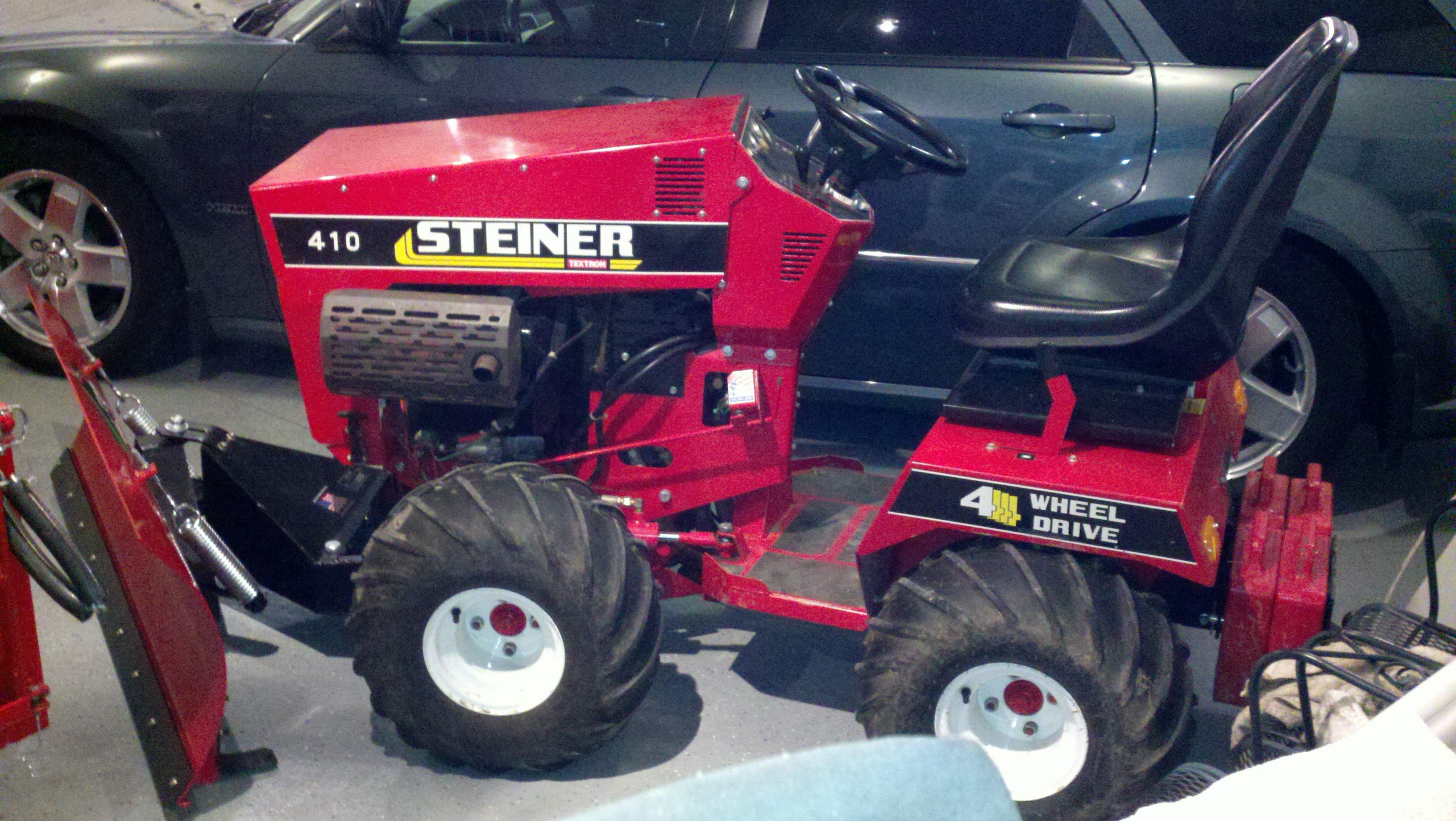

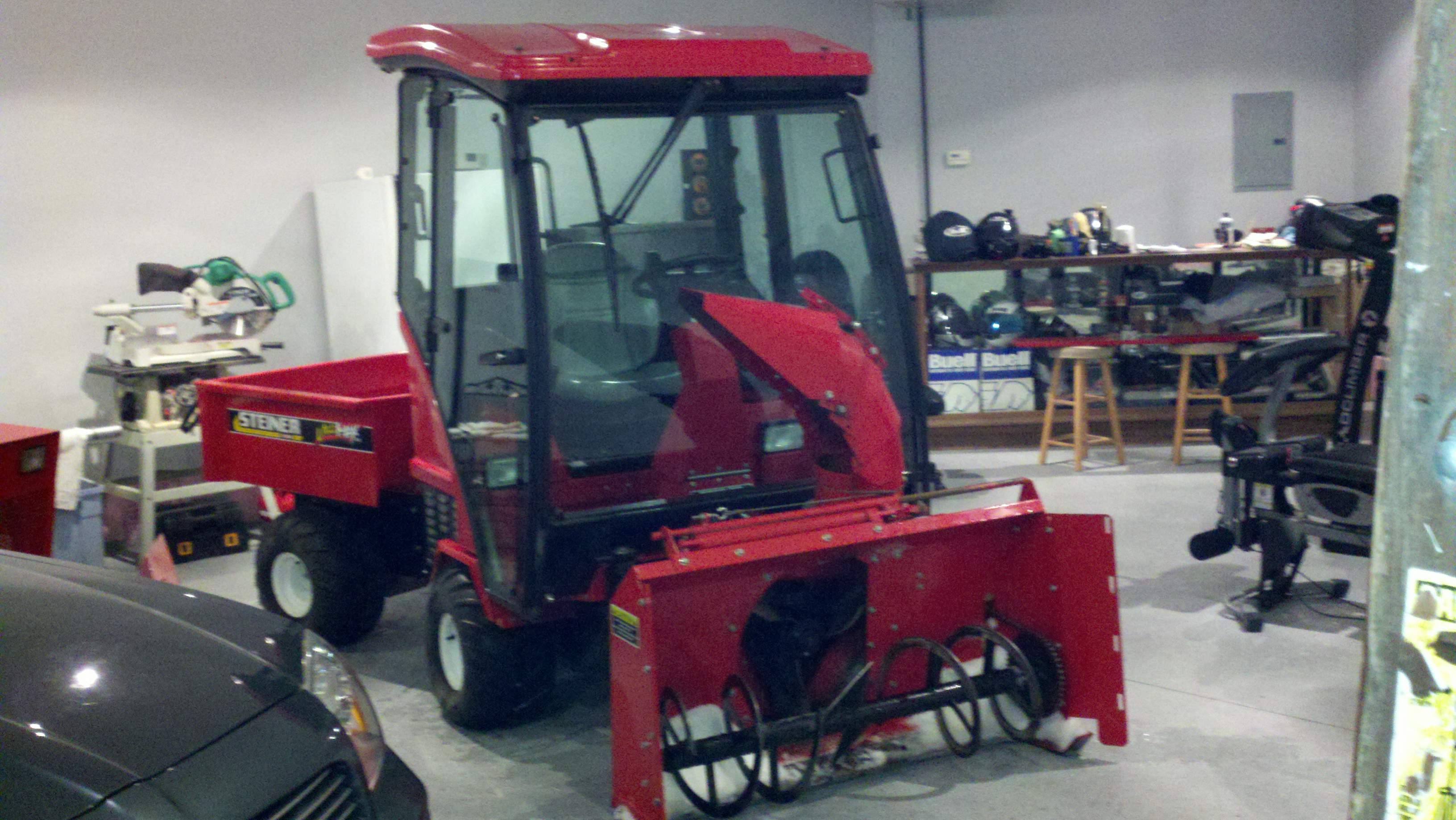

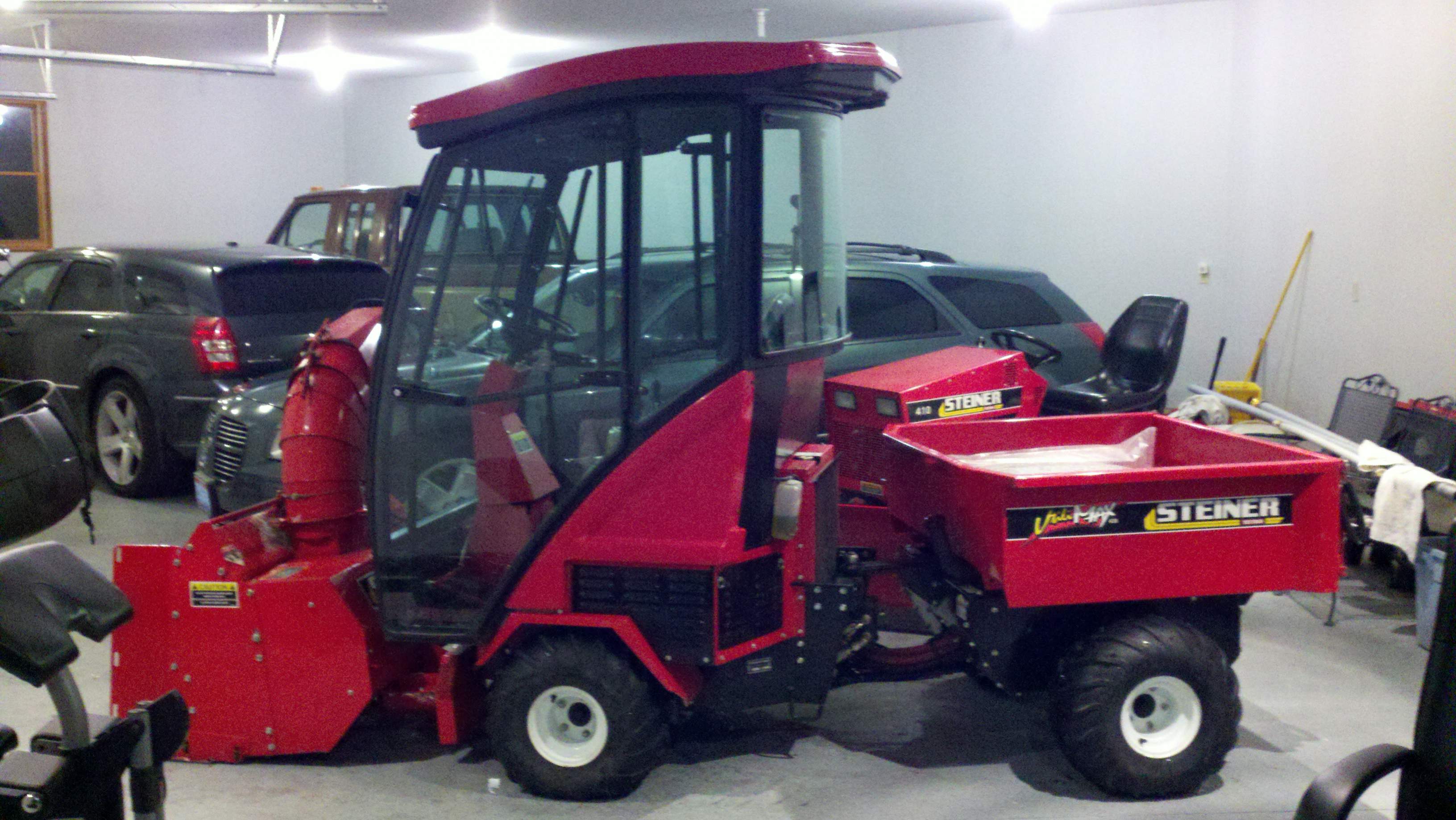

I like both my steiner's, each have different controls that are model specific. I think the utilimax was best built. Here are a few pics of my 410 and utilimax.
