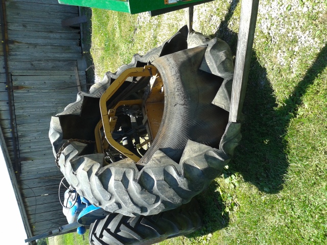

I'm using a 38 inch rear tractor tire and need to turn it inside out to use it for a flower bed. I already have the sidewall cut out and have spent 4+ hours on attempting to invert it. I am using an 80hp JD 2930 with FEL and adjustable pallet forks.
I will try to explain my first 3 attempts: First I tried chaining one end to the top of my 3 ph dirt scoop. See attached photo.
Then I tried standing the tire up on its end in front of two round hay bales and trying to push the tire into the space between the two bales. I was able to turn half of the tire inside out, but then I placed it on the ground and attempted to finish the job, but it righted itself.
Then I drove onto the tire with my Ford 4000 and attempted to use chains to lift the cut edges and chain them into position.
Any other suggestions? I also have Case 530 backhoe that I can use in the process.
I have read on other websites about how you can place the tire in a concrete culvert and pull it through using chain tied to a rim (but I have no 48" culvert). I have also read that some people use a front end loader to invert a large tire, but I can't find a video, photo or a good description about how it is done.

YouTube has videos on turning a car tire inside out. Maybe some useful ideas there. Just have to use bigger tools :)

Mossroad- thanks for the link- I had seen that video but this tire is too tough to manhandle (by hand) and even begin the folding process.
The pics in this article have given me some ideas of what to try next: FARM SHOW - Simple New Rig Turns Tires Into Feedbunks

WOW! :laughing:
Looks like he's cutting off the bead on the top side of the tire, chaining the top down over the outside of the tread, then pushing the bottom bead up and through the tire. Pretty neat! Thanks for the link. :thumbsup:
