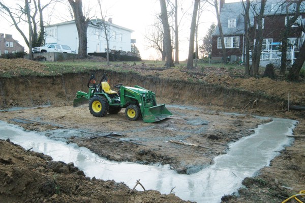

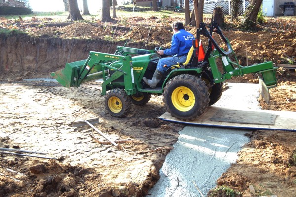

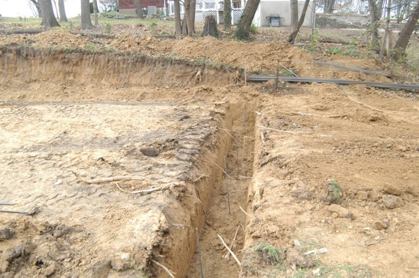

well the hill moved back footing dug and poured. On Monday we are setting walls and hope to pour the walls too.
The garage is 26x34 and the cement truck shut would not reach so the tractor took the cement to back. could not ge above the hill as it is some ones eles yard.
Whish me luck in getting the walls set not the mentioned poured. I will have to find a pump truck.
Hope you all enjoy the pics.
Roger
