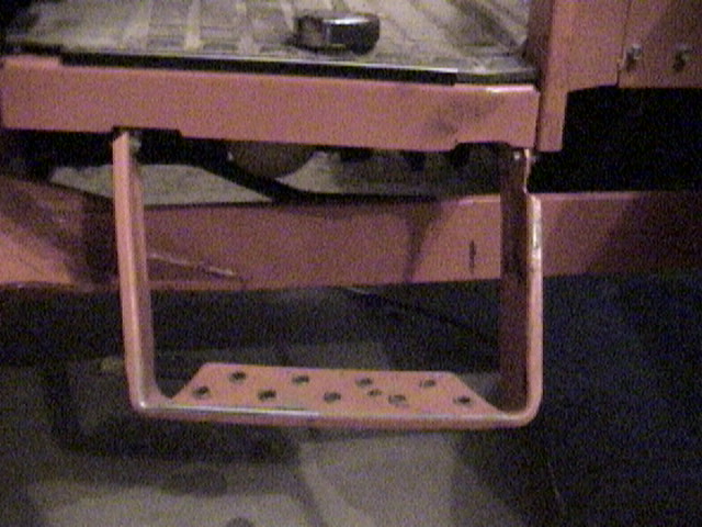

I have a B7500 and am fairly short (5'3") and my knees arn't getting any younger. Some mornings when my arthritus is acting up I find it hard to climb into the seat of my tractor. I was hoping one of you fine folks might know if there is a 'step' I can have added to the tractor to give me a leg up?
   / Step for Kubota #2
Thumper, I don't know of anything ready made to just bolt on, but I sure know of several metal fabricators/welders who could make one if I couldn't make it myself. I'll bet there are several in your area, too. If I were you, I'd take a picture of the left side of the tractor and stop by a couple of welding shops and ask. Or simply ask your tractor dealer. I would expect them to know of some shops that could do the job, it they don't do things like that themselves.
   / Step for Kubota #4
thumperjb
attached pic of step off of L series. probably available thru your dealer. it's not heavy duty, so keep it out of the rough stuff like stumps and rocks. 12"wide x 8" high. maybe could be mounted w/ couple pcs. angle iron.

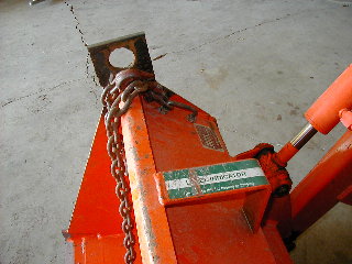

Thanks, I will look under the FEL braces this weekend and see if my B7500 has a hole there. This sounds like a job I could do w/o hauling my baby to a welding shop, I don't have a trailer and I was looking to avoid that as long as possible. Now if I can just think of something other than 'Gorilla Glue' to attach hooks to the top of the bucket. /w3tcompact/icons/smile.gif
   / Step for Kubota #8
Thumper, how about drilling a couple of holes and attach a hook with a U-bolt. I did mine like the picture shows so the hooks lay back out of the way of putting the fork lift forks on.
