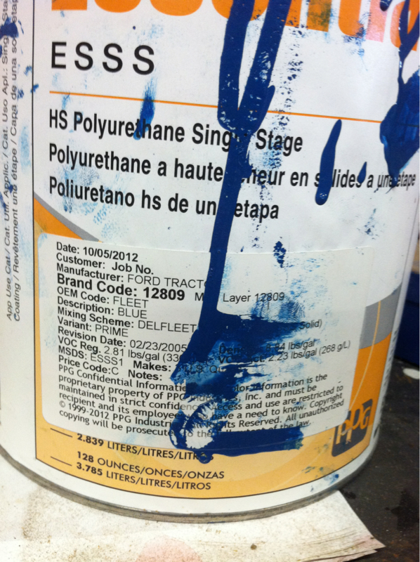

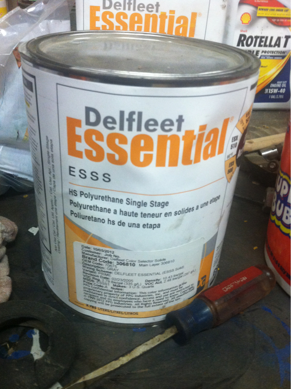

Back in 2012 when you posted it looks like you didn't get any input on how to prep. Sorry about that. Do you mind telling how you went about it?
No worries I just kept reading up on stuff from different forums till I felt comfortable with which route to take. It came down to wanting a very adhesive paint and one that would last a long time while still looking nice. A friend of mine did all the work I just did the research to help him get started. He basically took everything apart and cleaned using a degreaser, sanded where needed cleaned again and again till it was right. Then proceeded with primer etc per PPG's directions. Sheet metal and wheels were sand blasted and prepped. He actually had a friend thats into auto body work and paint do all the sheet metal so it was a group effort. The kicker though to the entire deal is that both guys took a personal interest in the project to make it as perfect as possible so i cant say enough about their efforts. I know a great deal about correct paint colors, and specifics of these tractors right down to the correct colored zinc coated wheel bolts etc so was responsible for these type details. I have collected tons of literature, manuals, original brochures etc which helped greatly. So it was definitely a group effort.
   / Steps for painting tractor #19
We could all use friends like that. I would say that that it looks better than new. Congratulations!
#20
Here are the paints and color numbers. Ford tractor blue and gray
