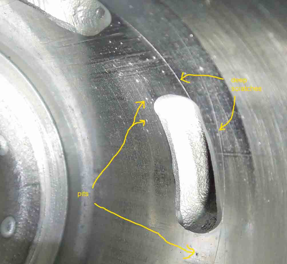

I am in the midst of a few Husky refurbs, and I just had my first cylinder rejection. It is a FarmerTec Chinese
unit for a Husky 371, and it is a bit too rough for me. Others have been fine. This is a big-bore kit to
upgrade to 75cc, and I plan to modify the ports a bit, as well as increase compression. I should have the
new one from China in a week or so. For this saw, I can remove the cylinder in about 10min, mostly cuz
you do not have to remove the handle/tank assembly first.
On cheaper saws, the jug bolts are often accessed from the bottom, not the top.
