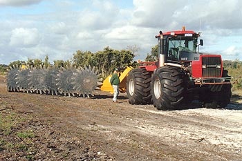

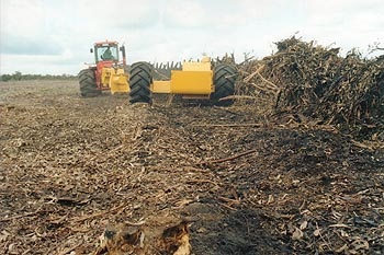

Hey guys, been staying pretty busy here lately. Iv been doing some thinking and I need some advice. We use a 13 foot root rake in our dozers. It works pretty good but I feel I can be more productive with something else. So I did some digging and found some pics. The first few are a called a rotary stick rake.
This looks like it could be promising for decent sized job with or without shearing involved. Seems rugged too!

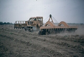

Now I think this is a root plow, not sure. But it's clear to see its a Aussie design.
I guess I'd be good at maybe grubbing small stumps? Or pulling i front of a planter?

Fello's up here use the as you call it the stick rake. We cal it a root rake.
It is used after the stumps are plowed out to rake the debrie in windrows to burn them.
It'll windrow the smaller stones as well.
