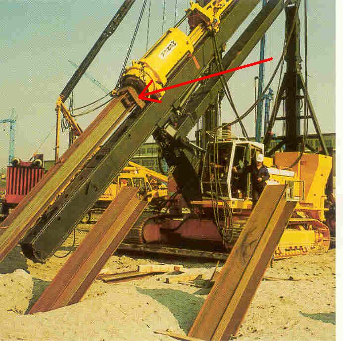

I use to get a steady diet of repairing pile driving followers. All cast steel. Trust me these things take a beating!:D Company would buy Super-Missle Weld by the 50-pound can. If you want to go cheaper 312 stainless steel is pretty much the same thing.

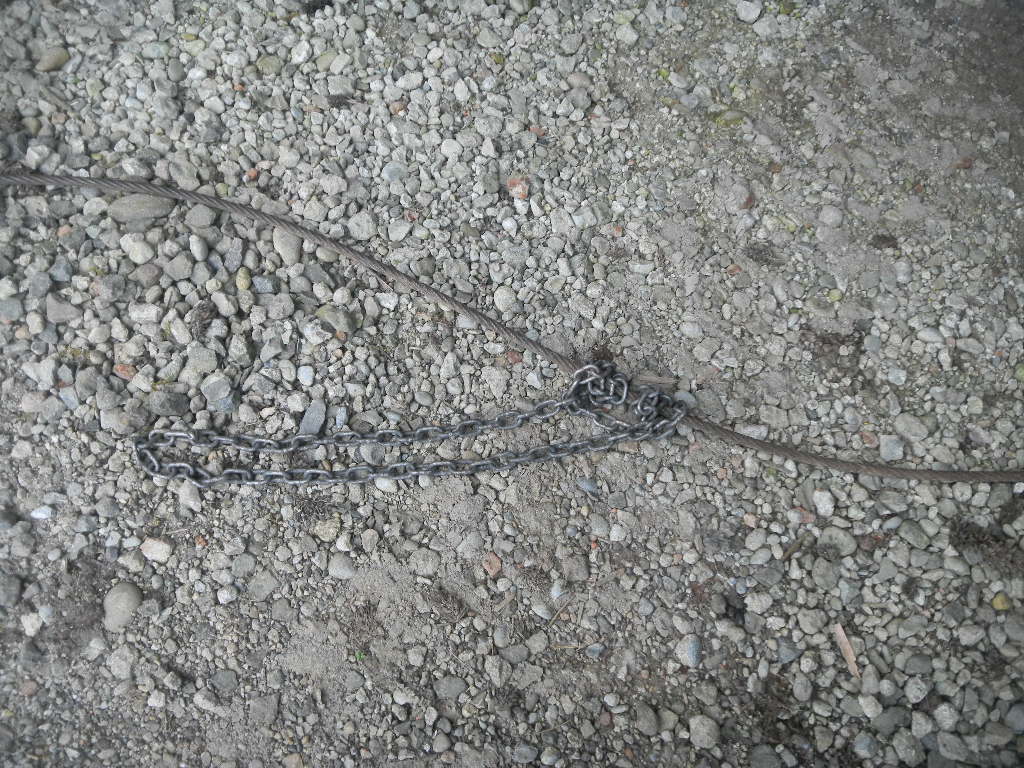

I've also had real good luck with 309 stainless steel for welding chains together for handling wire rope.
