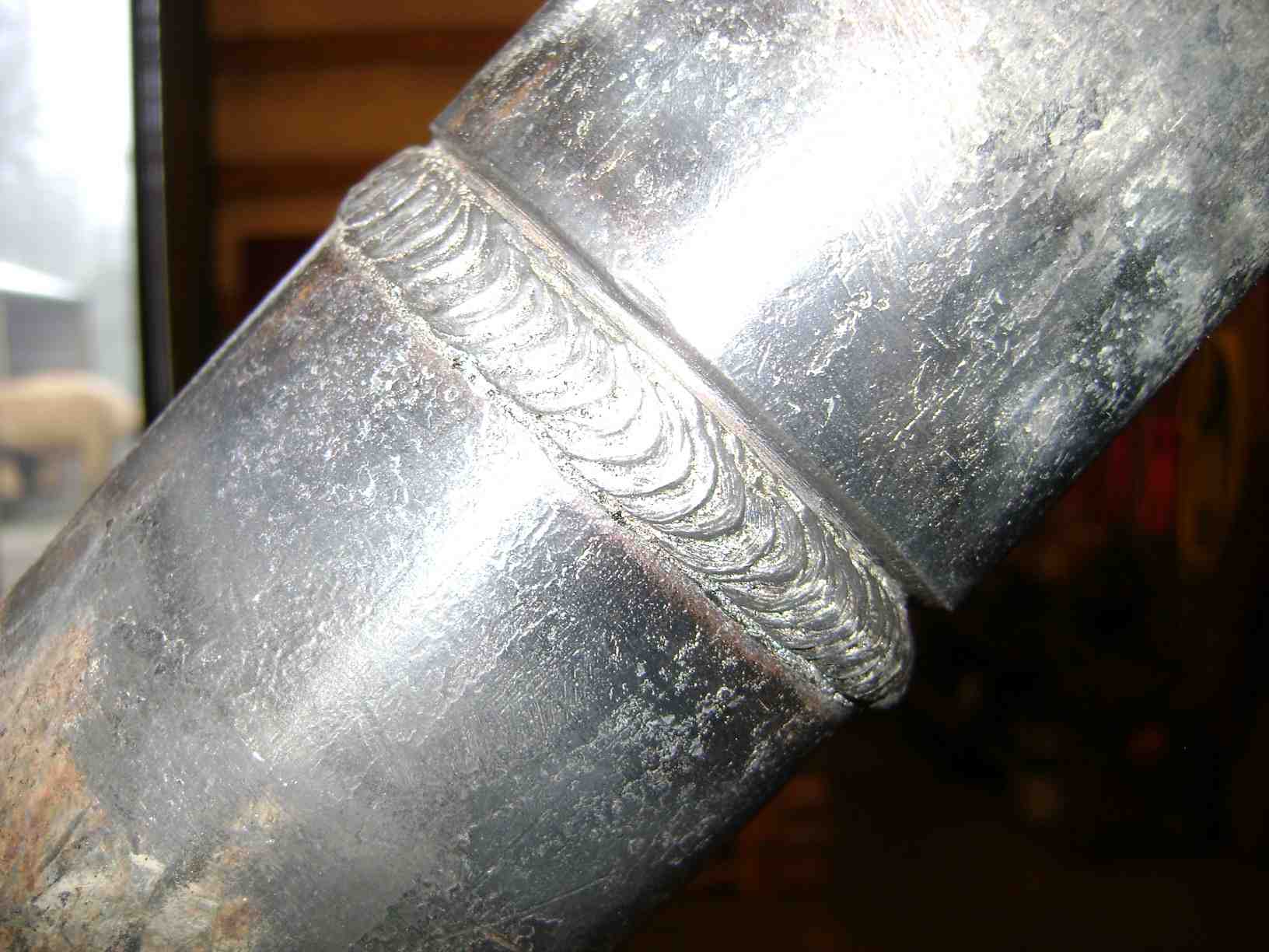

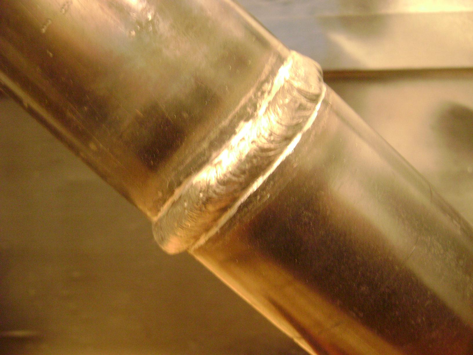

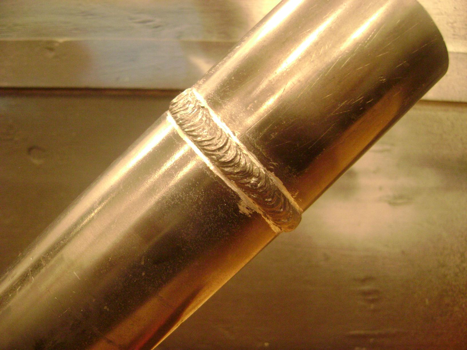

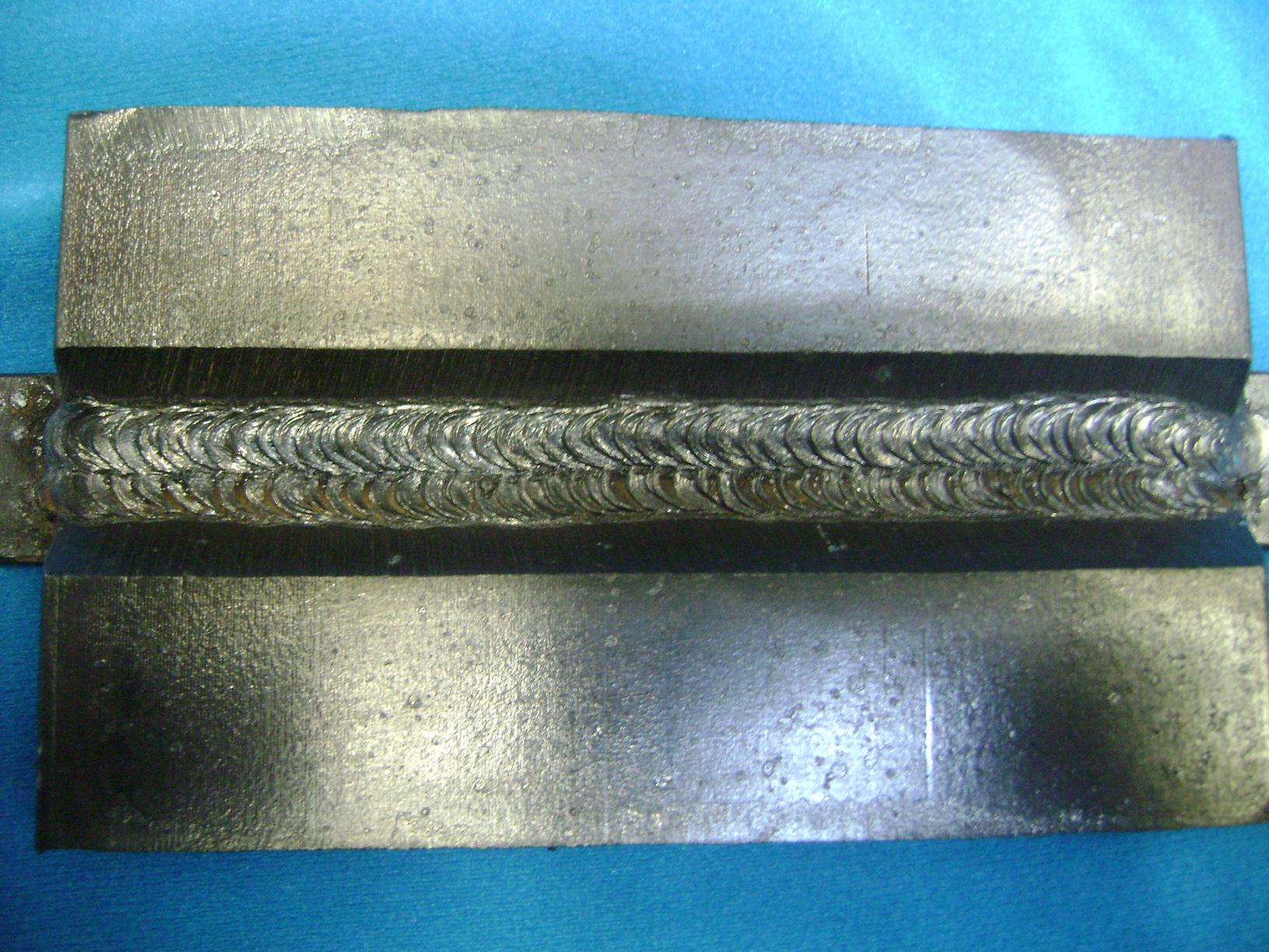

arrow my Everlast PowerArc 200 is the 220-volt only version. This is what it will do with ESAB's Atom Arc 7018, and ESAB's 10P-Plus 6010.
Shield, how hot were you running these rods and were they 1/8"?
/ stick welder question #36
Oh God I hate these questions.:eek: Yes they were 1/8-inch rods. Now remember the pipe welds were made on small dia pipe, and were loaded with heat from the welds below, so I'd guess the 7018 cap pass was made somewhere around 110-amps, and the 6010 welds around 75 to 80-amps.
Thanks Shield. I do not know what it is to run a good welder. My machine runs so cold that it could never acquire this bead and will stick 14 times before it connects. So, this is what they mean as "a pipe dream"
/ stick welder question #38
Well I'll tell you, that PowerArc 200 is the best arc for the dollar I have ever seen!:cool: But like I said, I'm new to this welding thing!;)
