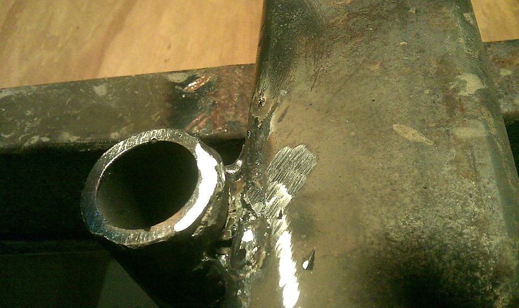

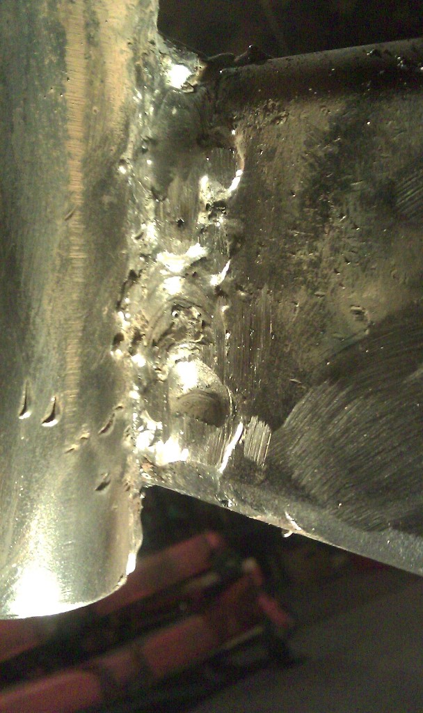

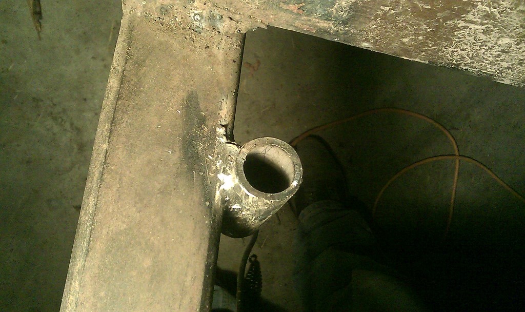

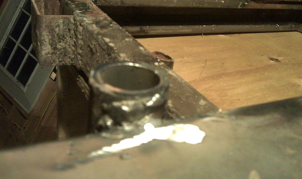

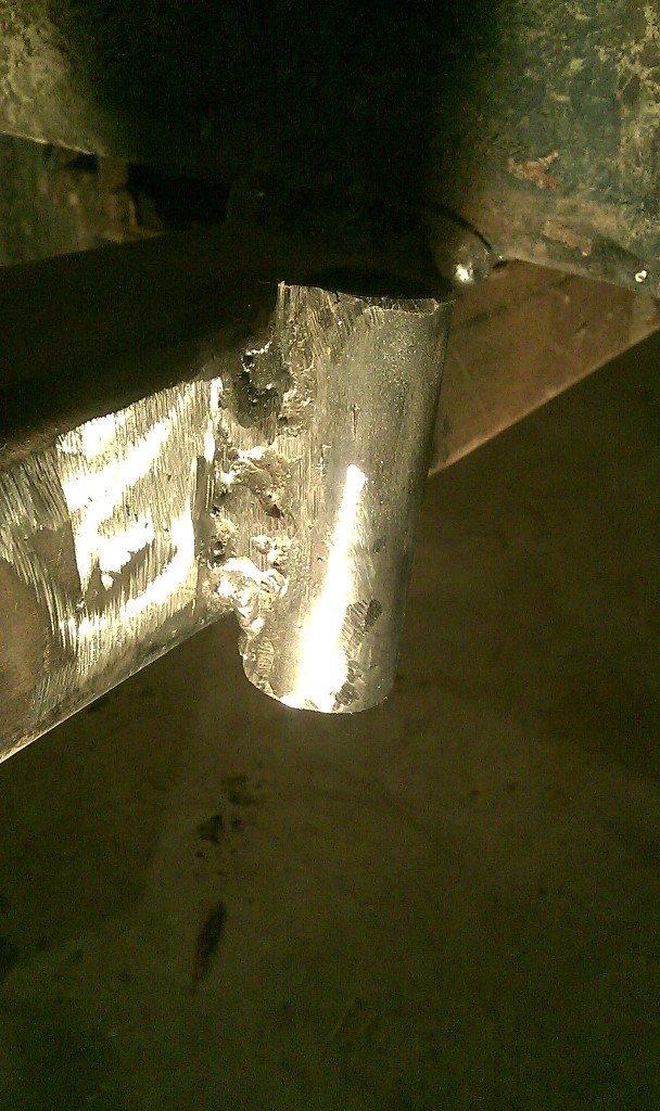

Welded a piece of pipe to the tongue of our RTV trailer tonight to store the hitch pin in.
I ran a pass of 1/8" 6011 at ~115 amps, peened it, hit it with a wire wheel in the grinder, then ran a pass of 5/32" 7018 at 225 amps.
Top:
Bottom:
Front:
Back:
Aaron Z
   / Stick Welding 101 - AC Buzzbox and 5/32 7018 #29
It sounds like you're running too hot for the rods you are using. The dial on the machine is only for reference but 1/8" 6011 at 115 amps is about 5-10 amps too hot for most applications. 225 amps for 5/32" 7018 is really, really hot.:shocked: Normal range for 5/32" 7018 would be 160/170 amps. You should do some practicing on scrap pieces so don't have to grind so much on your projects. It makes it very hard to tell you how to improve your welding, when we can't see what your welds actually looked like.
