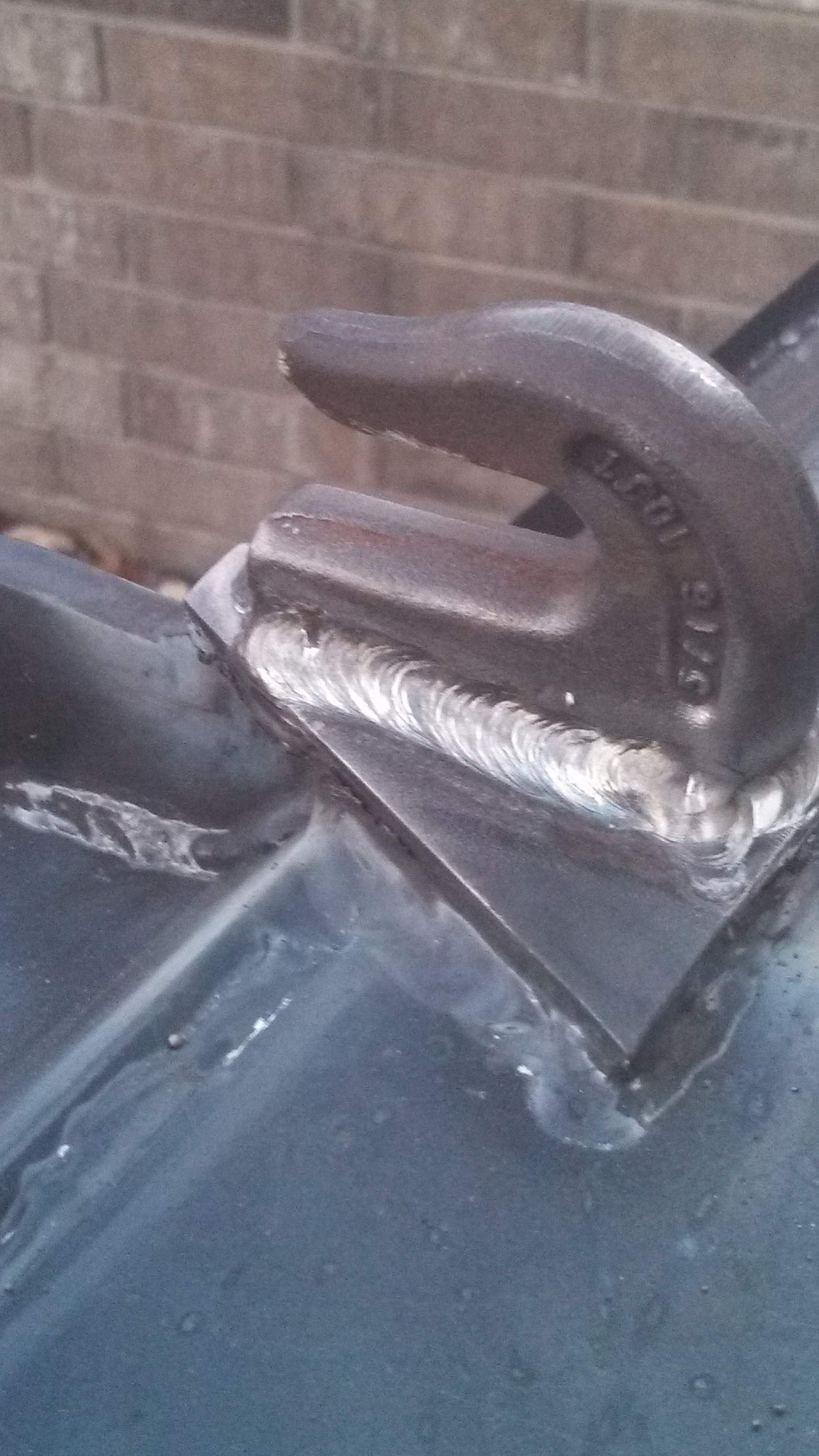

I prefer 7018 to either one of them. Once you figure out how to break off the "corn" on the end to re-strike them, they weld as smooth as 6013 with much better looking welds than 6011, and stronger than either one of them. Here is one of my 7018 welds. The hook on the pad. The pad was factory welded with a MIG, and it doesn't look that great.
