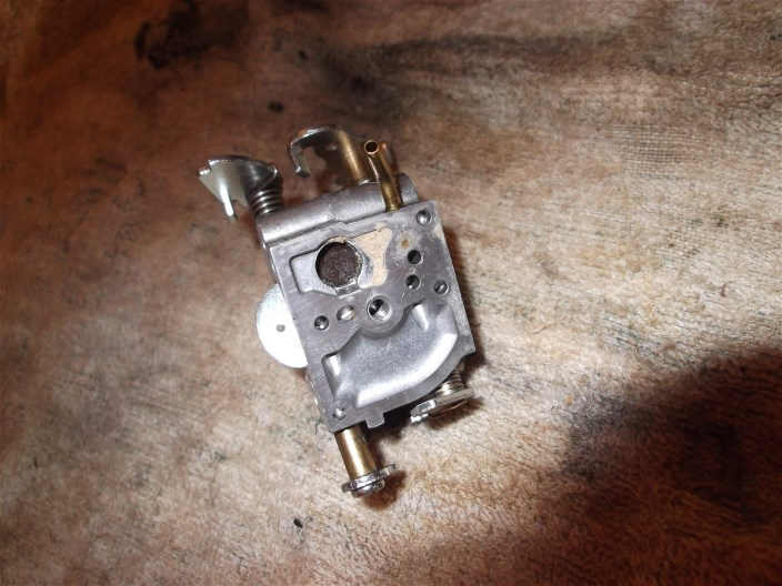

Ran perfect last time. Now, starts first pull and will idle forever. BUT as soon as I pull the trigger it dies. Restarts first pull, idle but can’t pull trigger.
Ideas?

Change the spark plug. Most likely not the problem but worth a try. I’ve had one spark plug fail and it was a Stihl MS 250. It would also idle but not rev up well. If you have the muffler off take a look in the exhaust port and make sure the piston isn’t scored. After that I’d take a look at the carb, take it apart and look for dirt and put it back together.
/ Stihl 194 #9
IPL shows 2 mufflers. 1 has a spark screen behind the deflector held by 1 fastener and hinge.
If that checks out I still think open L some. See it so many times when the diaphragm starts getting old and stiffing up.
Little stihls I even see it on new ones as tune is so lean.

Something that happened so fast and is very consistent in idling well but sec you hit throttle it dies, it's a carb issue.
You stated it was just under 2 yrs and you do not run it much, plus you use E based gas...if the H2O separated out, then rust, your carb is prob clogged somewhere....
My recommendation is to buy a new carb and replace, Then you can troubleshoot the current one as a back up...
Good luck and let us know how it goes/

OP HERE. Thanks for all of the replies and YouTube. Took the carb off, and the plate that has just one screw(at least on this carb) there is a super fine screen, about the size of a pea. It was COMPLETELY clogged over. Dental pick and some air and all is well. Just got to tinker with throttle screws that got out of wack with early on fixin.
/ Stihl 194 #18
Actually fairly common with all brands of saws. The in carb screen is finer than the fuel filter in the tank. Basically the internal screen is 100 micron and the fuel filter is 175 micron.

OP Filter seemed to be in good shape, changed anyhow. There was an honest 1/16” thick crust completely covered the screen. Used a dental pick to scrape out, then blow gun.
