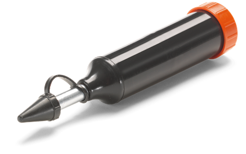

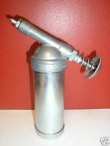

So, back to greasing a Husqvarna clutch bearing and bar tip. Greased mine yesterday using a basic grease gun, but I see Husky and others sell a "special" grease tool for this purpose. Any benefit to getting/using one of those? The grease didn't seem to go in real well using a standard grease gun. I ended up using my finger to push the excess in a la spreading caulking if you know what I mean.
Husky Version
Aftermarket Version
   / Stihl Farm Boss 20" v. Husq Rancher 455 20" #76
CHDinCT, Lubing the bar tip bearing requires one of those "bar tip grease guns" to get the grease down into the bearing properly.
Benefits? You will do the job in 5 seconds. Also you will hear a "pop" as the new grease goes into the bearing, and the old crud is pushed out.
I have two types, one, the Husky Version which is very messy to re-fill, but otherwise works well. The one I like better is a syringe type, not unlike the one that you show as Aftermarket Version.
As for the clutch bearing, if they haven't provided a lube hole, then packing the bearing the old fashioned way works!
Thanks - gonna see what my local dealer gets for the Husqvarna version. I think it runs about $5-$8 on-line so if his price is close, I'll pick one.
