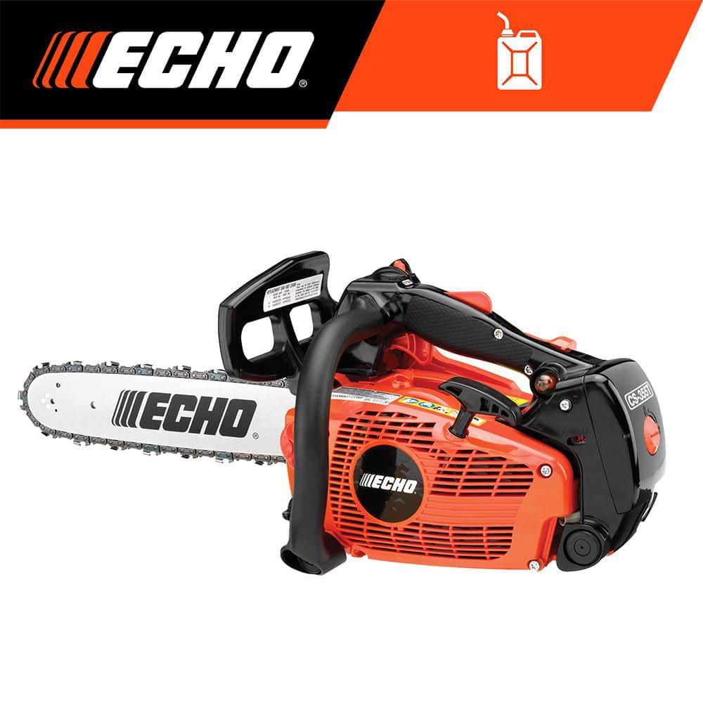

Have ran the 355 and own the 2511. I would choose the 2511 any and every day over the 355.
Seemed like a toy when I picked it up???
   / Stihl or Echo top handle saw? #65
Yup, it's considerably lighter than pretty much every other saw out there and makes limbing an absolute breeze. It will out cut a 355T in 10" wood all day long. To me, a top handle saw should be light weight, easily maneuverable, and fast cutting through anything 10-12" and under. That's what this saw does and it does it better than most. The 2511 is Echo's pro series and the 355/271 are a homeowner series...

Didn't even know about the 2511, how can it be 10cc less and be considered a PRO saw?
2.5 pounds lighter than the 355. Nice if up in the bucket all day long limbing.
How does the 2511 stack up against the Stihl equal?

The CC's dont determine pro or not, its about power to weight ratio where pro saws normally shine. Plus build quality and performance. The Stihl 194 is the closest in comparison to the Echo but to me felt clunky and much heavier than the 2511 and from guys Ive talked to that have run both they are comparable in power output. I generally do not like Echo stuff but that 2511T is one awesome little saw.
Good to know. It was sitting at the dealer and when I picked it up I almost laughed at how small & light it was.
