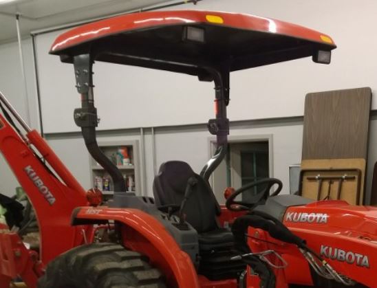

I have a Kubota Canopy and am trying to think of a good way to add a storage shelf for gloves and stuff like that and looking for some good ideas. I can rig something up between the support bars somehow but want to know if anyone else have done this.

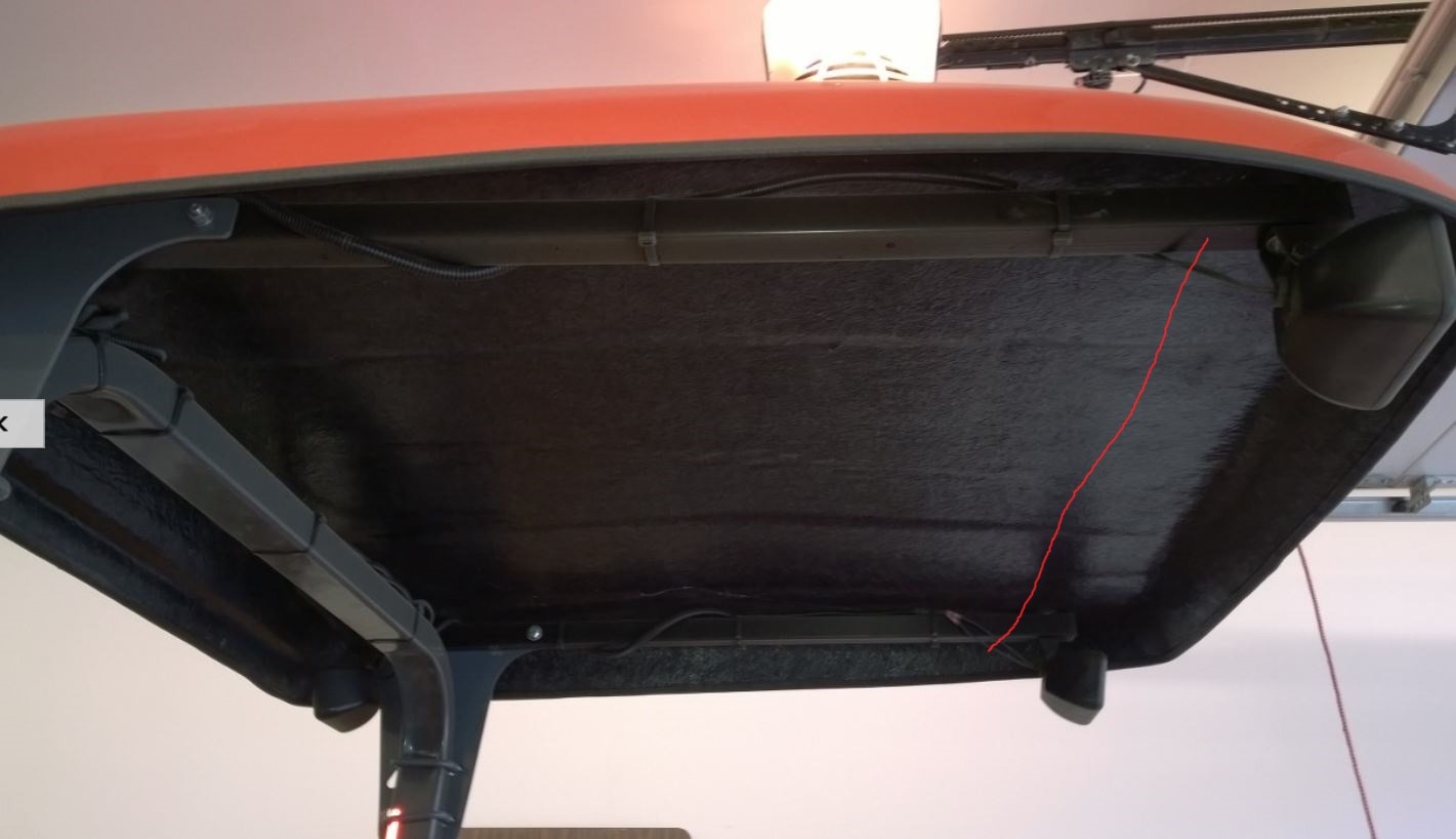

I could run a crossbar from the left to the right behind the headlights for support and mount some kind of a storage shelf above it. See the red line I drew for the support bar. I could use square channel for this, the same size as the canopy support arms and bolt it on the bottom. I need ideas what I could use for the actual shelf.
   / Stoage in Kubota Canopy #4
I haven't gotten very far with my canopy yet but have been planning on building one myself out of aluminum diamond plate with the same sort of framework underneath, and a box of sorts dropping down in the front, framed out of the same tubing. I had envisioned closing in the bottom of this box with expanded sheet metal grating type material to make a compartment like what you are talking about. I wish I had a way to draw it out, it makes sense in my head at least. But I had a lot more plans to go along with it. It may seem silly all by itself. I have LED lightbars front and rear, so the front one will accompany this box, and I will probably also add a radio, fan, and "switch board" for all of these accessories beside this box. So it will be sort of a "console" across the front edge of the canopy, just behind the light bar that will line the very front edge of it.

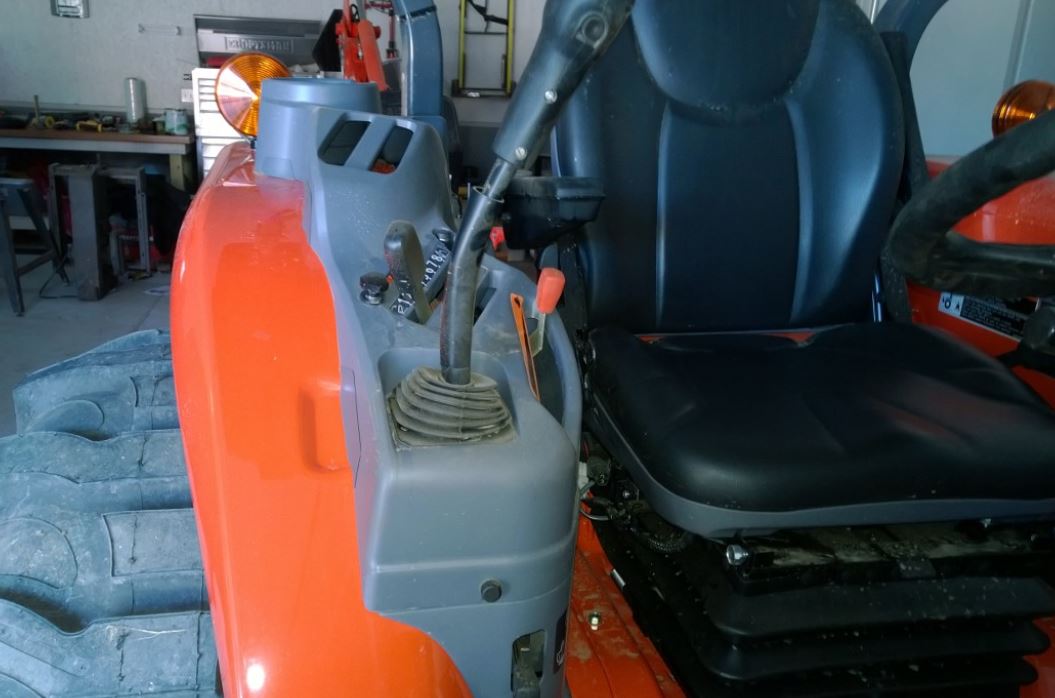

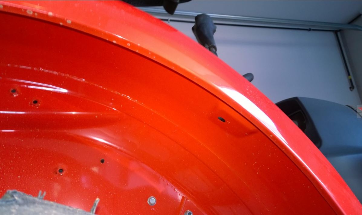

I have a favor to ask. Could you possibly post a picture of the bottom side of your back fender? I have a Kubota L3301 with the FEL joystick mounted up front by the steering wheel, eliminating the possibility of exiting from the right side of the tractor. I have been thinking of relocating the valve under the fender and mounting like yours is. I assume thats where your valve is anyway, and not some sort of linkage setup. I would appreciate it. Also, your sig says its hydrostatic drive. Where is the pedal? Thats something else I may have to change since the pedal on mine is rather large and right in the middle of the right foot pad where you would enter and exit. Not sure yet if it will be in the way.

You got it. When I get home I'll take some pics and post them. Even with the joystick mounted in the fender, I still exit to the left. It gets in the way, not as much, but it does. My pedal is on the right. I'll take pics of that also. No need to apologize.:thumbsup:

There is nothing under the rear fender below the joystick. The linkage must be under the plastic covering around the drivers area. I also took a pic of the HST pedal. I hope this is what you wanted.
   / Stoage in Kubota Canopy #10
Hmm, thats very intriguing! Not at all what I was hoping to see, but not because of you. Your pictures are perfect, thanks! Thats a good job by Kubota to keep it a clean install, but now I'm very curious as to how the plumbing is set up for the hydros. I was hoping to duplicate it without too much cost other than relocating my existing valve and extending hoses. Clearly that won't be the case.
