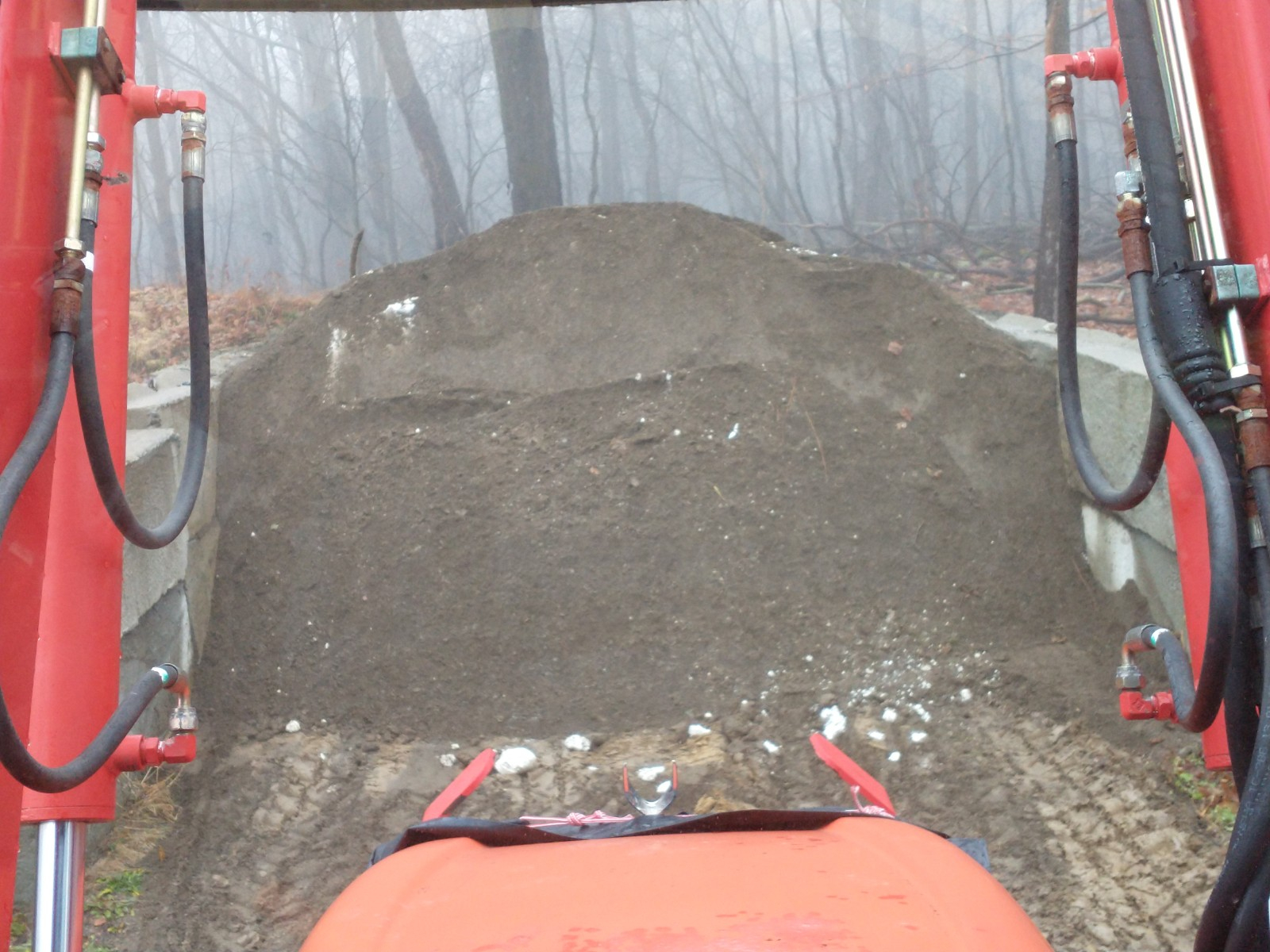

I use pit run sand, I get a triaxle load every couple of years, it has some salt mixed into it to slow down the freezing in the pile.
This year when I got my load I added 500 pounds of more salt to the top and mixed it in a bit.
I also use coal ash most years to as a good way to use the ash.
The last 3-4 sacks of salt spread out
mixed into the top layer and all pushed back

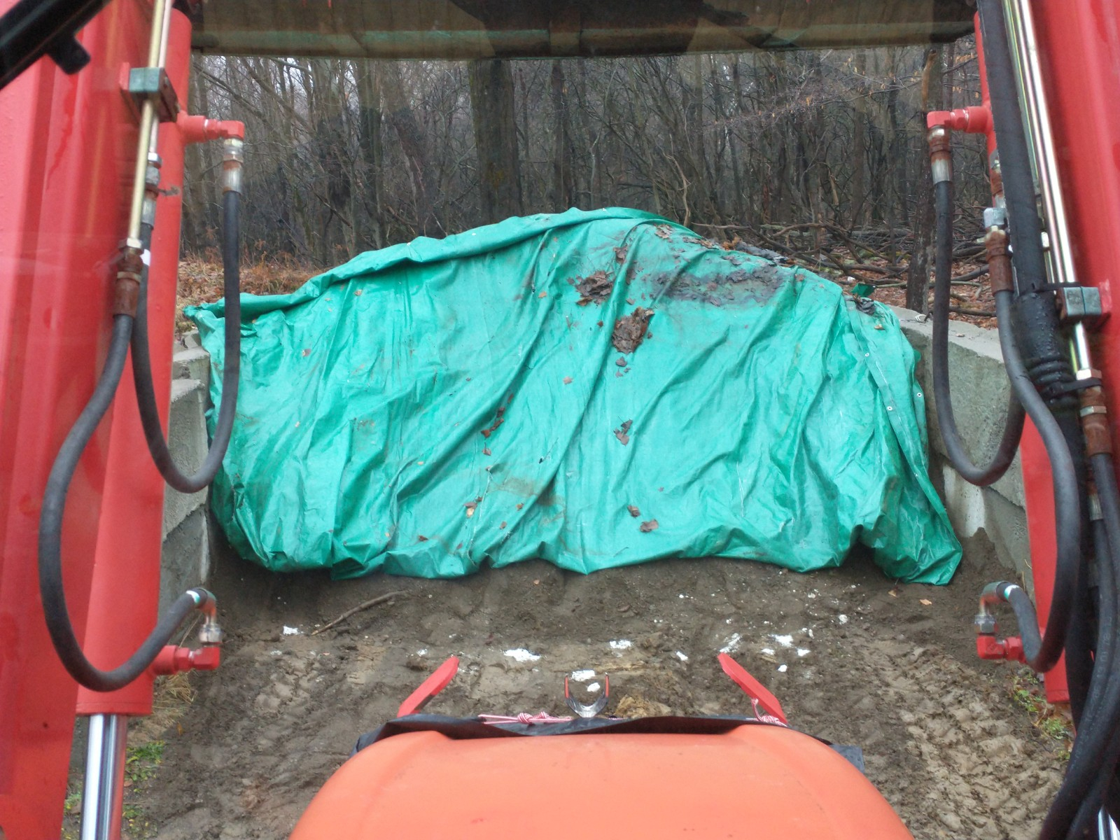

Tarped and ready to be uncovered and loaded into the sander.
