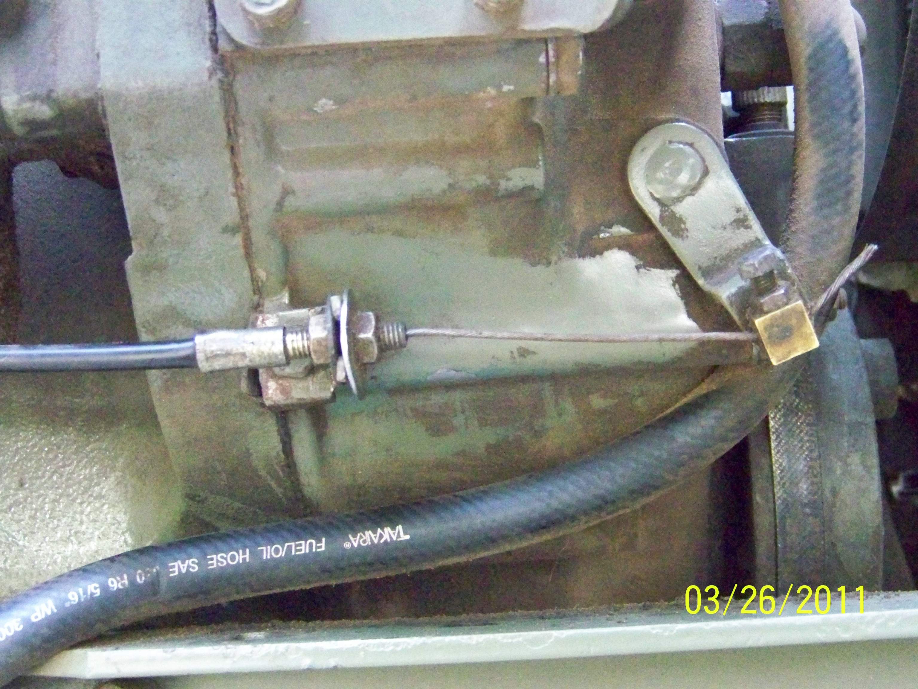

I have an old YM2202. I am trying to get it to crank, I am not a mechanic, I am not much of a tinkerer. There is a push/pull cable? at the bottom of the dash, it says STOP. When I am trying to crank the tractor should this be pushed-in or pulled-out? AND what exactly does this thing do? Shuts off the fuel? Releases the compression?

So which lever are you referring to? yoiu can bet Yanmar did not put "stop" on yuor gray market tractor, but a lot of guys mistakenly use the decomp lever to stop, That can ruin your engine.
   / Stop thinger on a YM2202 #5
He has an aftermarket Tractor Supply cable installed. It is red with a "stop" written on it.

I am aware of that, but so far he has not determined by his posts whether he is using the fuel lever or the decomp lever. (What does the lever actually do?) On both, with lever in, runs normally, out, will not start.
   / Stop thinger on a YM2202 #10
This is where the stop cable connects. Just how it is hooked up inside I don't know. Pretty sure it just closes the rack when pulled.
