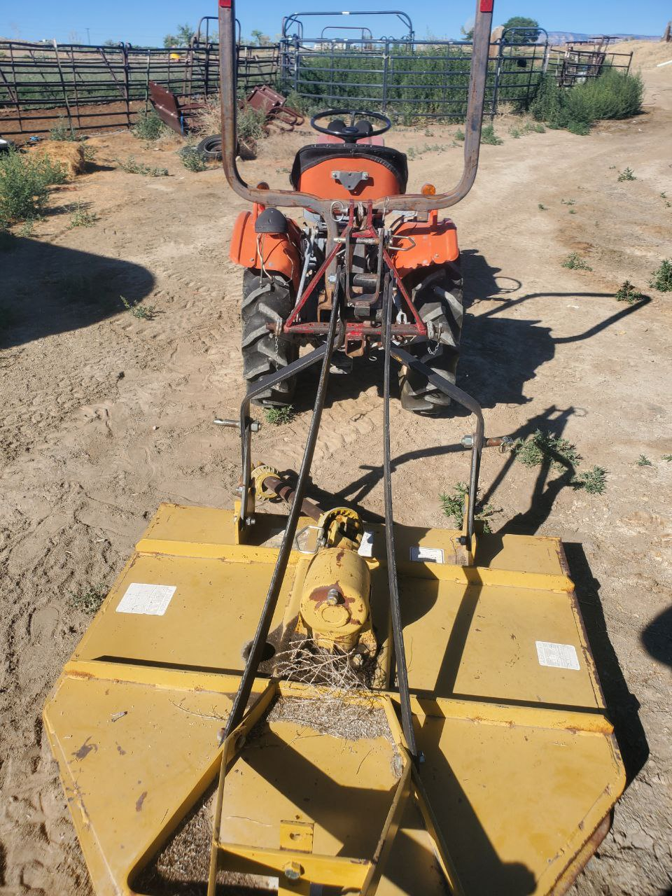

B7100 HST also, but it has a fan behind the Radiator.
Has not run in 10 years, lots of wiring issues.
got it started today, and ran it a bit, tried to hook up a brush hog that was given to me, but the hardware on the Brush Hog is almost twice the diameter as the pins on the B7100, and the frame is way too wide for the 3 point hitch.
would take a bit of reconfiguration on the Brush Hog to make it work.
