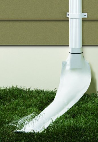

How about a "46-Inch Automatic Recoiling Downspout" made by Raindrain?
Amazon.com: Raindrain 46-Inch Automatic Recoiling Downspout - Green URD46GR: Patio, Lawn & Garden

Okay, I've got ideas now, thanks.
Don't want too use any kind of filtration because of pollen in the spring and other unavoidable suspended fine particles. I thought of a trap but it would freeze in the winter. I think what I'll go for is the Mozzie Stoppa (funny name but it looks like what I want). Thanks!. Their web site did not give dimensions so I will contact them tomorrow.
