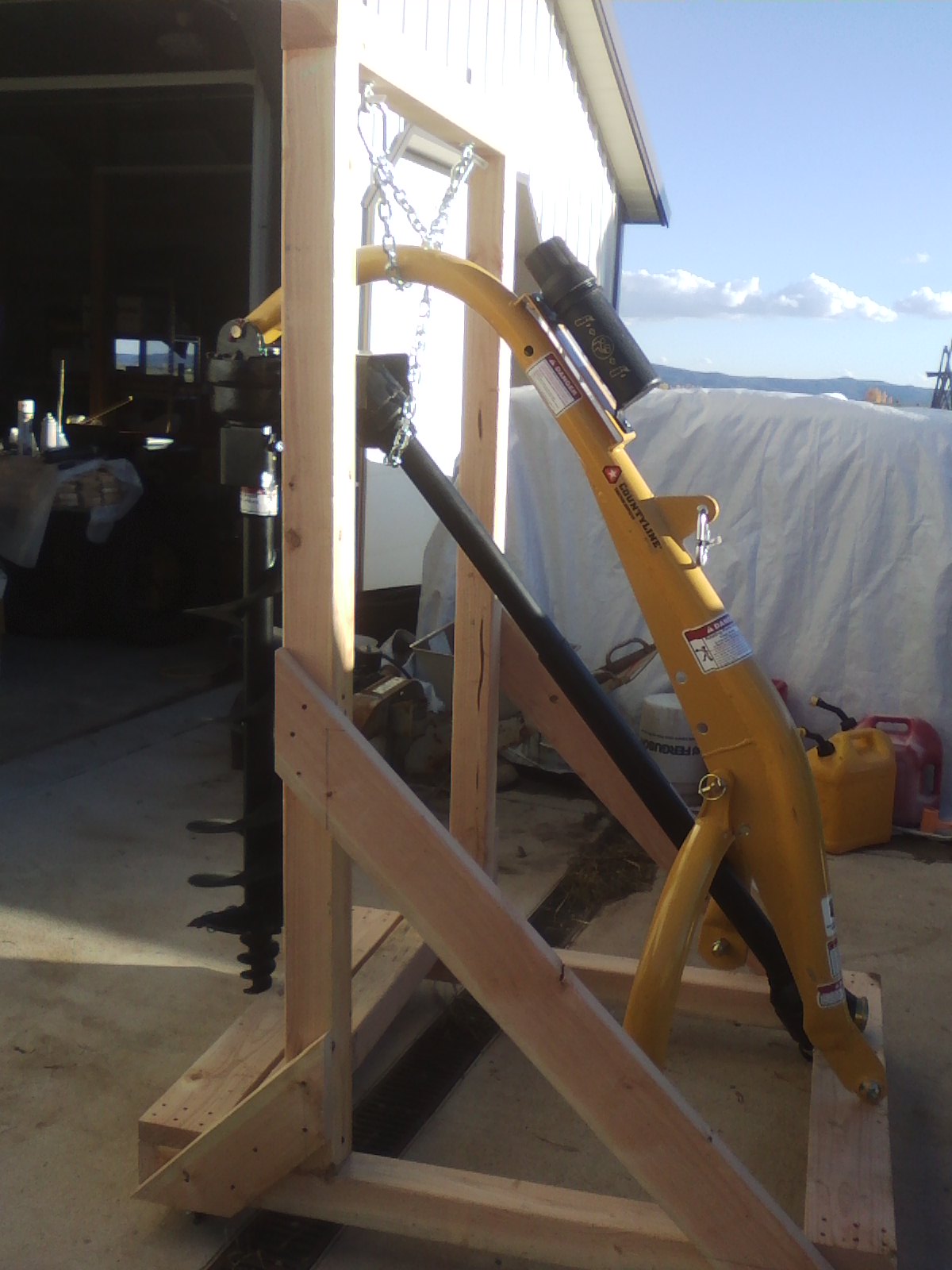

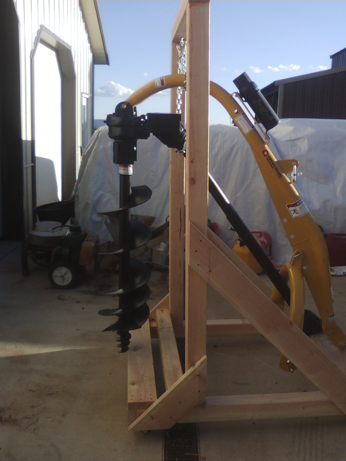

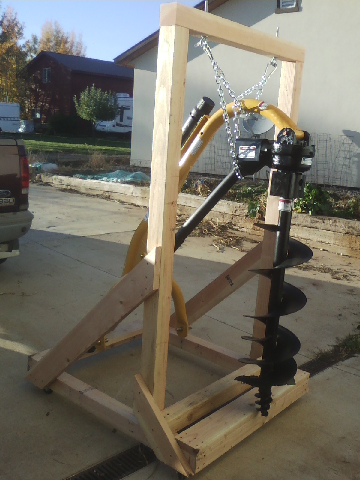

I built this tonight or of some scrap wood I had. Its kinda crude but I'm thinking about using the measurements and building one out of metal

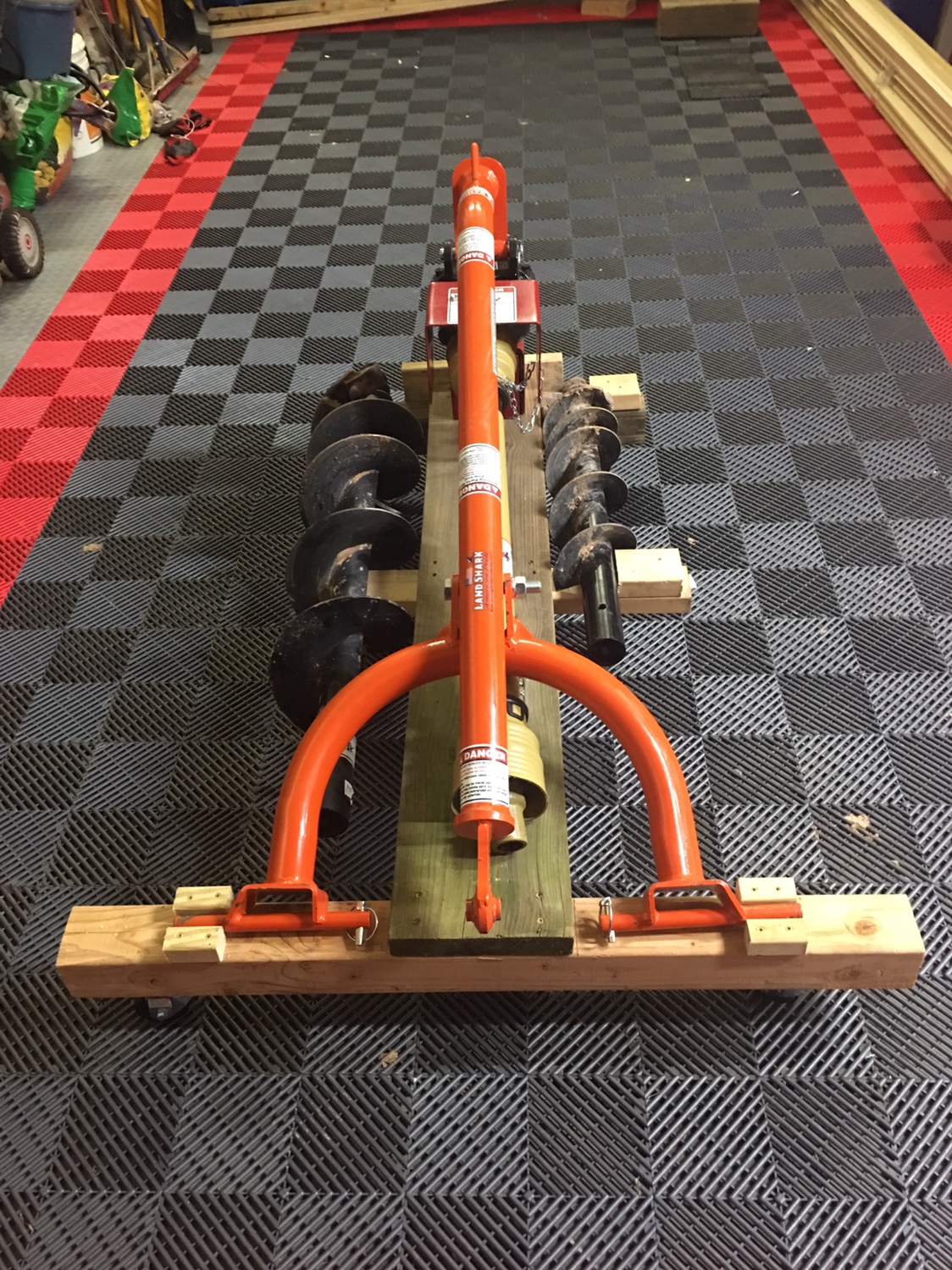

My last PHD was a cat 2 with the hydraulic down force cylinder and was a PITA to handle as it was big an heavy. I hung it from a chain off a pipe gantry for a while and finally ended up removing the bit to make it easier to handle on a pallet as I didn't use it for a while. I finally sold it to a neighbor my move and have regretted it as I needed one almost immediately at the new place. So I decided to invest in a new one and after looking around ended up with the Titan 60 HP model.
I immediately noticed how much smaller it was than my last PHD. Assembling was a breeze as nothing was heavy. I added a few bushings for my cat 2 hitch and put it together in a few minutes. It's very light duty and I am going to have to be careful not to break it with my tractor as it has down force in the 3 point which makes PHD's work much better and I know I could snap the pipe if I wanted to. My take is if you have one of these little light duty PHD you might consider just taking it apart and storing it inside. I thought about leaving it out but broke down it takes up little space and it's easier to hook up in pieces than assembled.

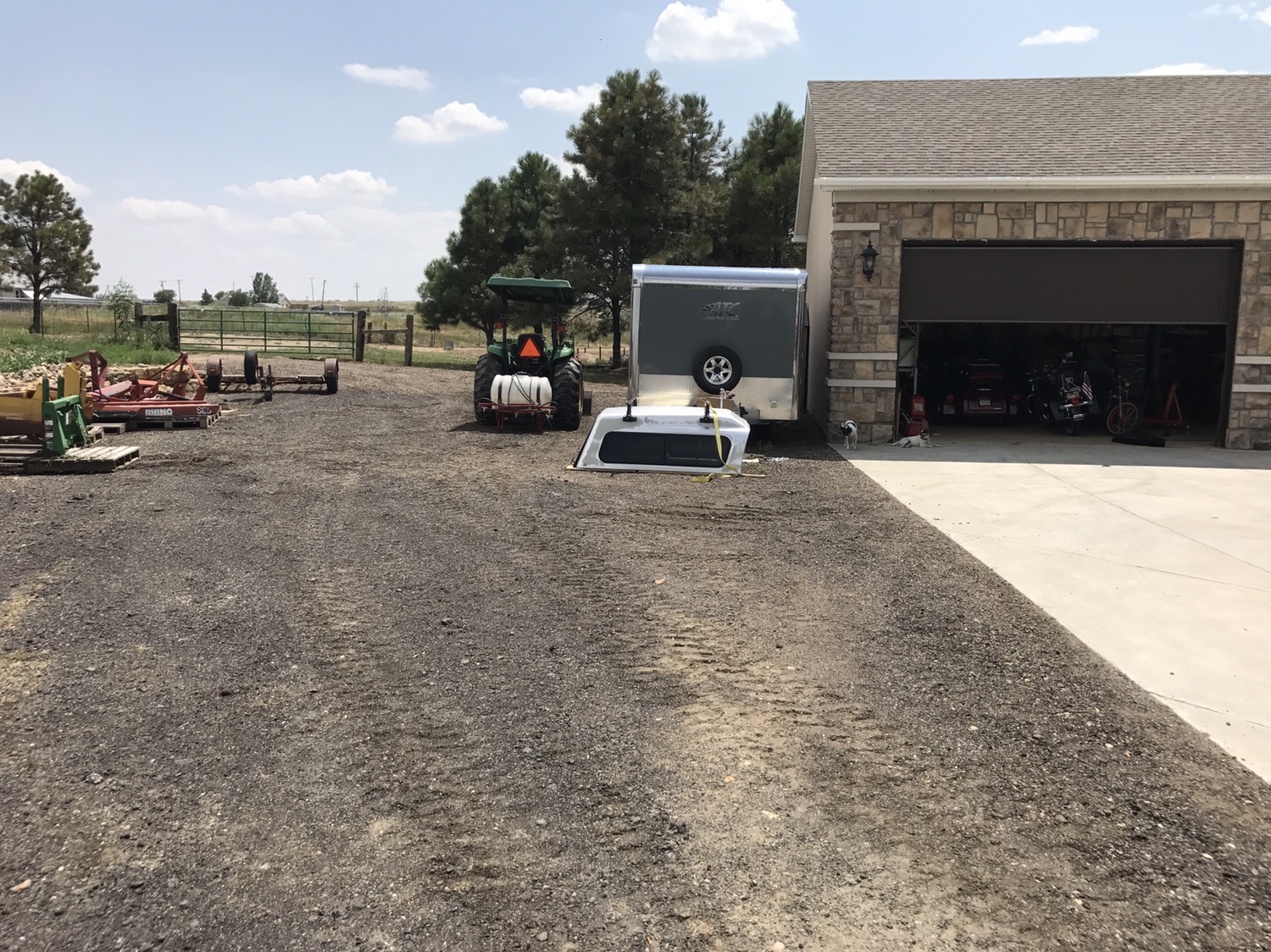

I solved my storage problem by trading my PHD for a truck load of boulders and an hour of excavation. This allowed me to double the size of my parking area.
I have never found the digger of much value in anything other than loose dirt. IMG_0973.JPG

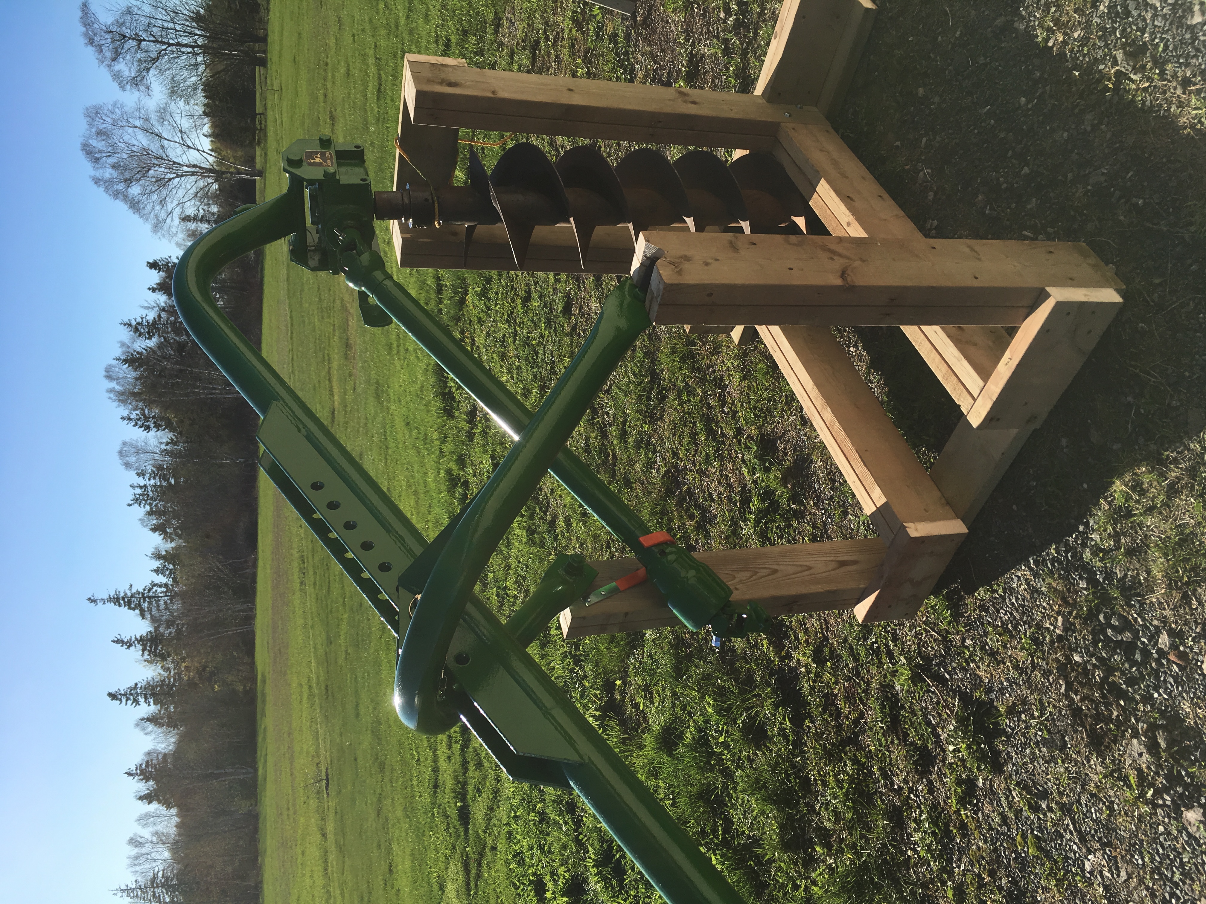

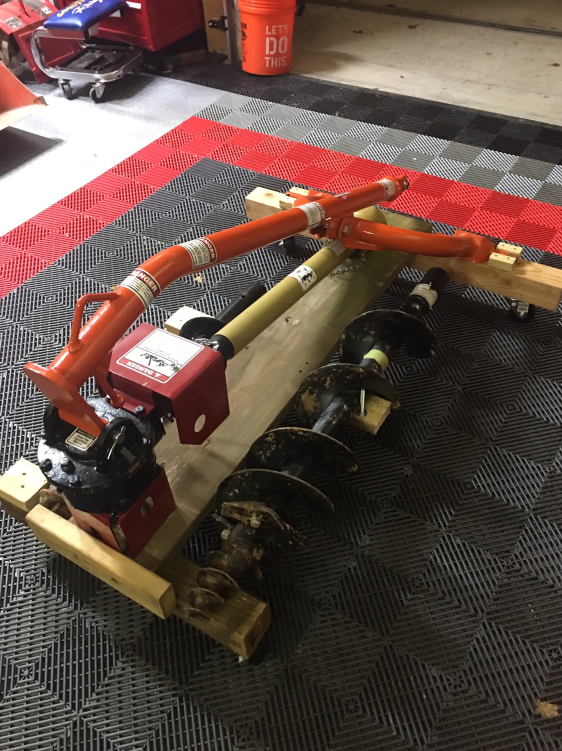

This is the stand I built for my PHD out of some salvaged PT wood.
   / Storing 3 pt post hole digger #20
This is my stand
I have added a bolt for the PTO shaft to sit on, and plan on bigger casters to use in ny gravel barn. So far it is easy to use - just roll up behind tractor, install boom, then side links, lift and undo chain and away I go. Stores just as easy - back into it and raise boom all the way up, secure support chain, take the weight of and just disconnect.
