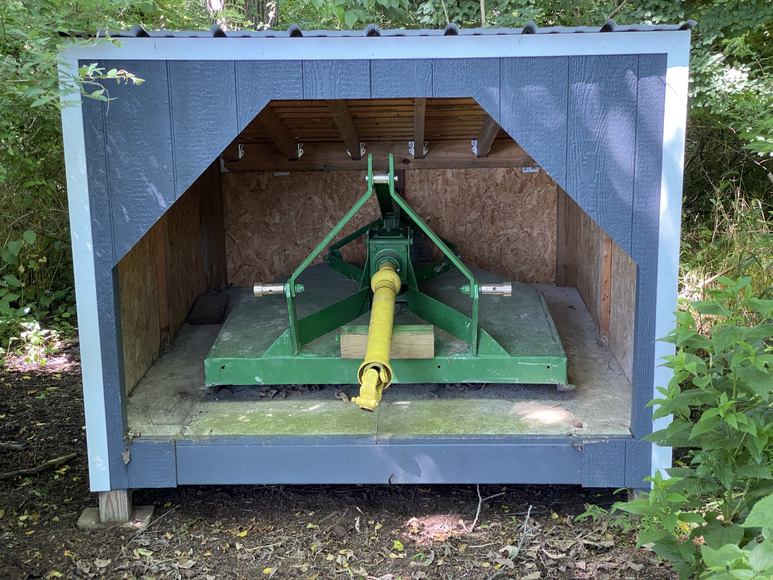

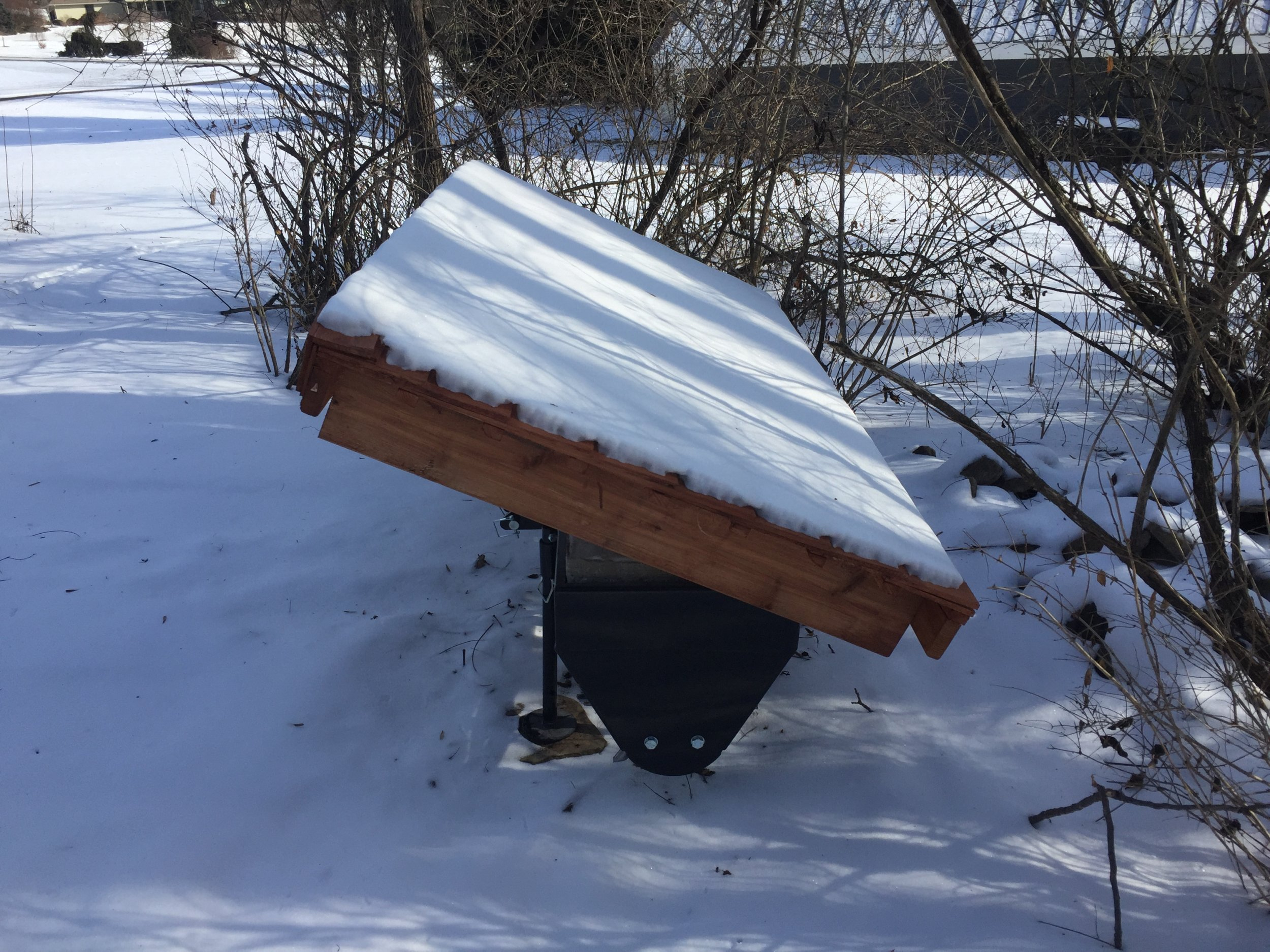

I try to keep everything inside, but what must sit out is:
1. Kept up off the ground, preferably over a paved surface.
2. Has some sort of roof over it. Tarps are bad if draped directly on the equipment, as they can trap moisture. But a roof, even a sheet of corrugated fiberglass just tied in place, is nearly as good as being indoors.
Here's how I store my aerator and brush hog, both which lost their spot in the garage to more expensive equipment:

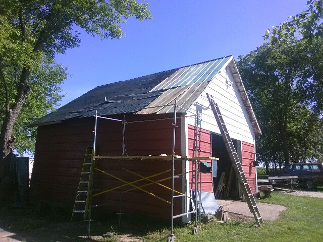

I fixed the torn open roof on a converted corn crib this year. It's 24 x 24, and was about 1/4 open to the elements for probably 20 years, before I bought this place. Sill plates, rafters and wall studs were rotten. I don't have a bunch. It's ugly, but all my implements are now in a dry place.
Feeling good about that.
