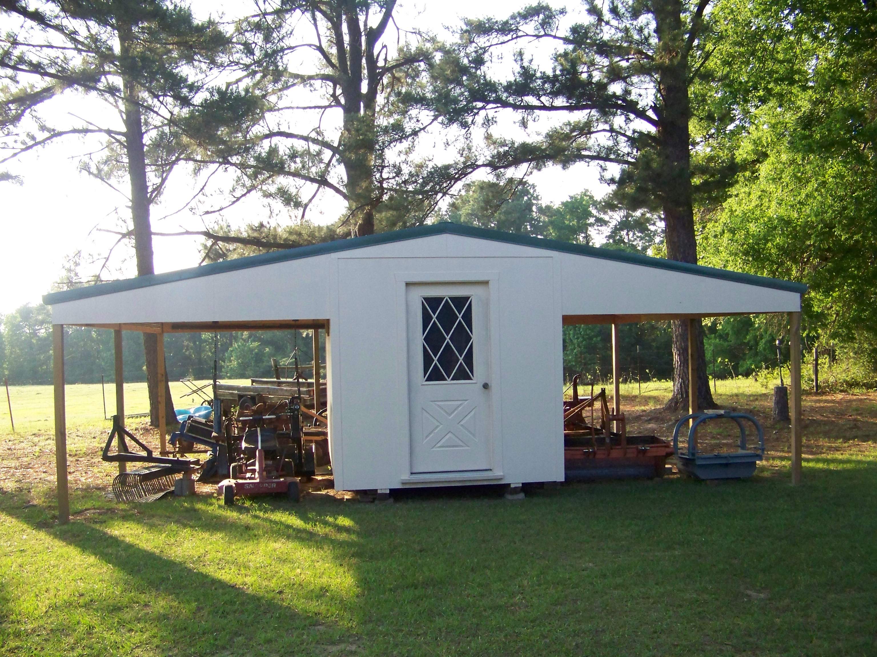

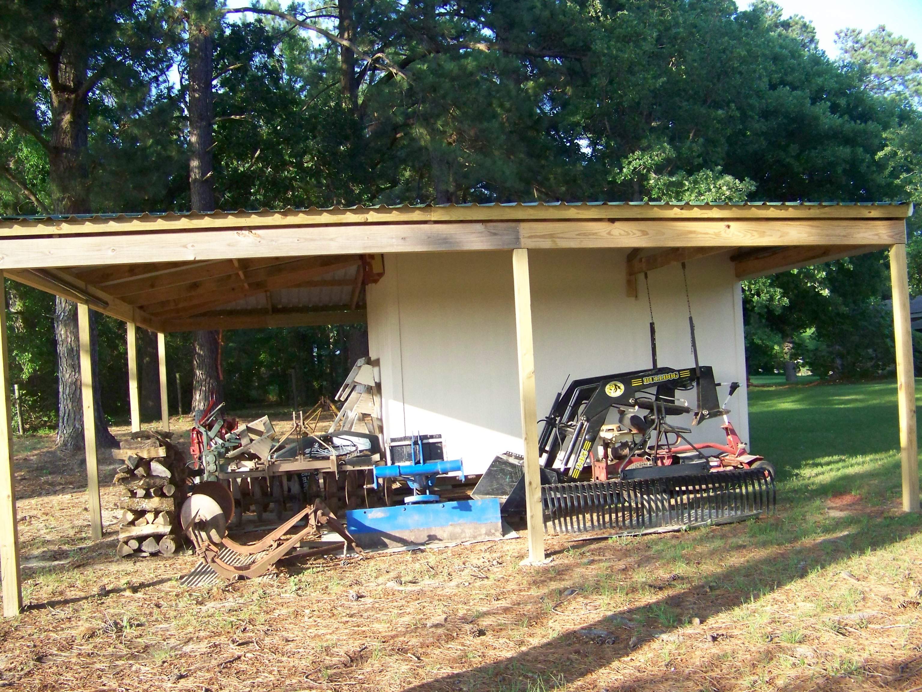

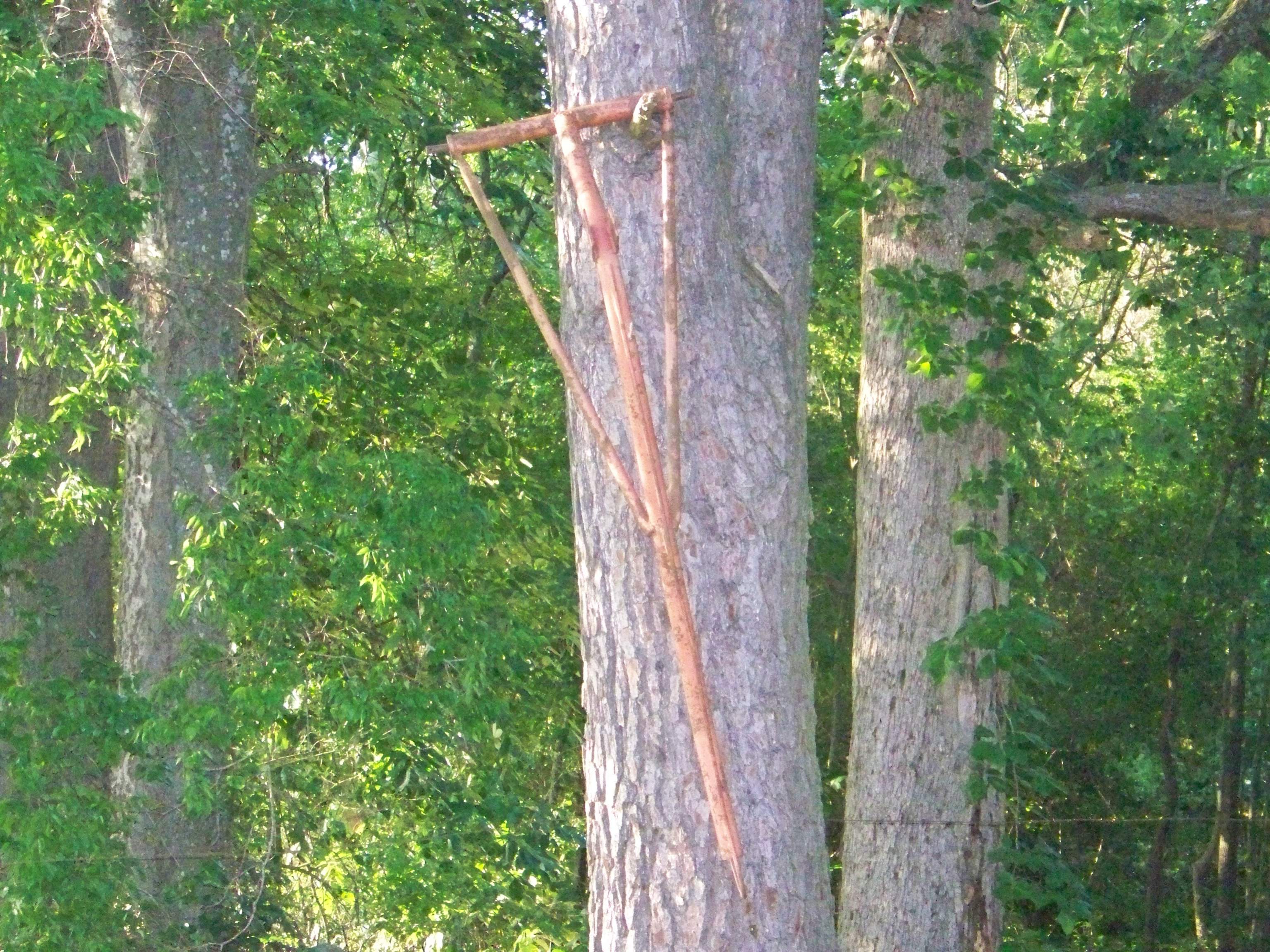

I built a little 8 x 12 storage bldg and put some sheds off 3 sides. One implement hanging in a tree.
