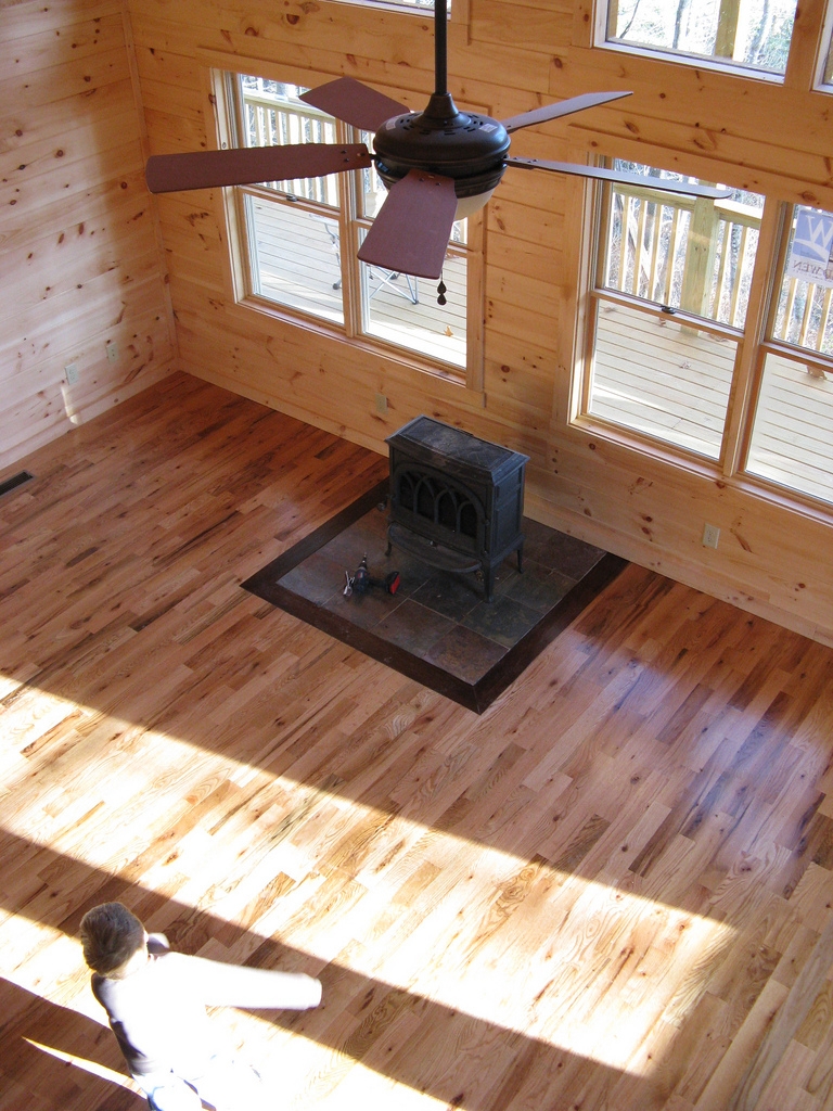

Our cabin has red oak flooring that is called cabin grade due to extensive worm holes and other defects. I think it looks great - we get a lot of compliments on it. That said, red oak is very nice to split. Love the smell. Cabin Floor.JPG
   / Storm: What to do with downed Red Oak Trees. #15
Our cabin has red oak flooring that is called cabin grade due to extensive worm holes and other defects. I think it looks great - we get a lot of compliments on it. That said, red oak is very nice to split. Love the smell. View attachment 276973
Looks nice. I like wood with character too.
