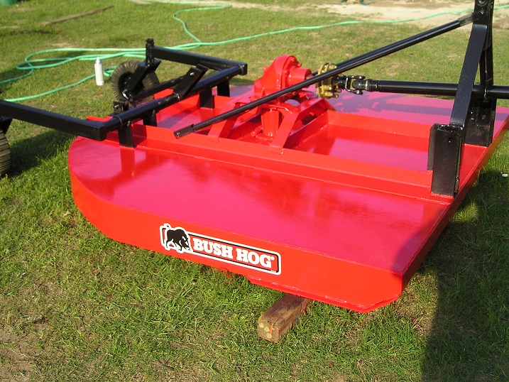

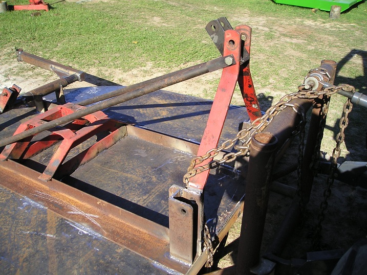

This is one that I got rebuilt using Bushhog 307 gears, stump jumper and shaft. It is all 1/4" checker plate which is a bit thicker and heavier than regular 1/4" plate. I had the heavy dual plate type 3 PH put on and dual wheels on the tail to help it track more level on my mostly hilly terrain. Also you can see the swivel at the top link that was added to the original 3 PH frame. finished 7ft 001.JPG7ft #2 002.JPG

The squealer 172 is in the same class as the woods bb72x,land pride 1872 or 2072, and the rhino 172. However after seeing it in person and then seeing the woods there's really no comparison. The woods and land pride are just a lot beefier especially in the hitch. Nice rebuild on that old Hog. I don't think my tractor would pick it up but I like the way it was done.
