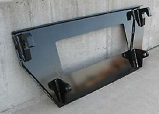

Does anybody make a plain straight blade for the Quicke Euro-Global quick hitch? I know they make snow plows that hyd angle, but I am looking for a plain straight blade. A BACK BLADE FOR A FRONT LOADER.

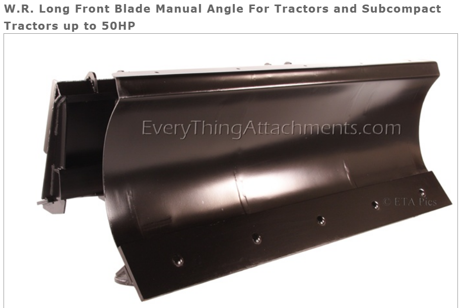

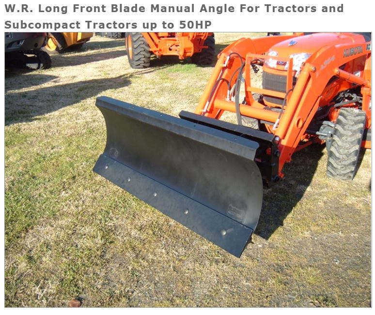

https://www.(Temporarily blocked du...l-Angle-For-Tractors-p/wrl-front-blade-ma.htm
   / Straight blade for FEL
That's what I had in mind but I need >80 inch and for a 70 hp utility tractor. Can you buy just a blade and weld the hooks and eye on it?

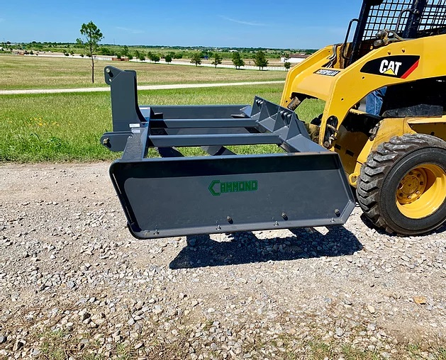

What are you going to do with the blade?
If you have a three point box blade or a land plane it can be mounted on the front with a Euro-Global quick attach:
These are SSQA:
I use mine with a 3 point adapter:

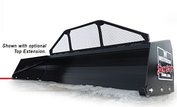

I am going to use it to push and pile snow and I may use it to move and grade dirt. Doesn't need to angle for my application.
   / Straight blade for FEL #6

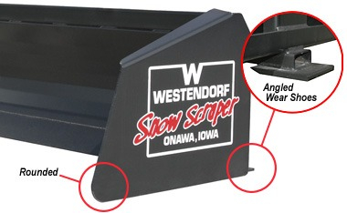

what you want is called a snow pusher
Westendorf makes a fixed blade, but I fear the price may be prohibitive. Are the snow pushers rugged enough to move/grade dirt?
