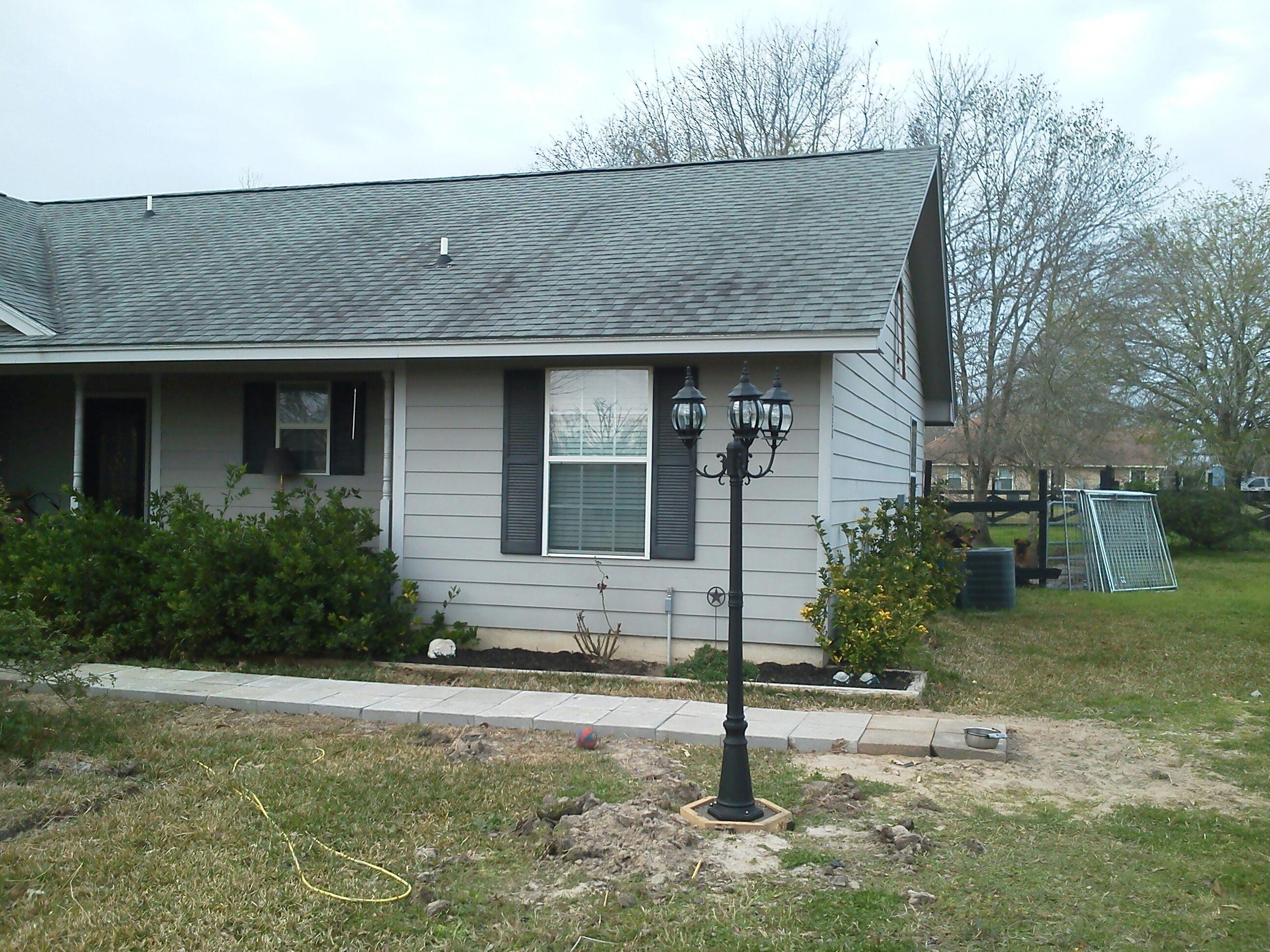

   / Straight Fence Line? Long Distance... #75
Oops, I have never known how to post pictures and my wife was showing me a few minutes ago. Used this pic as a sample (actually was gonna start a thread about the yard lamp my latest project). She suppossedly cancelled it but then it showed up on last post. I will figure it out eventually.
