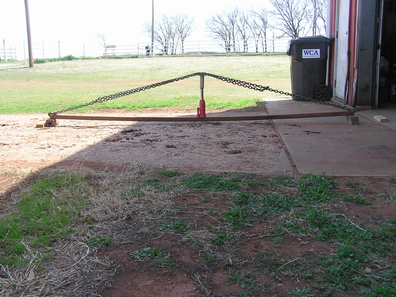

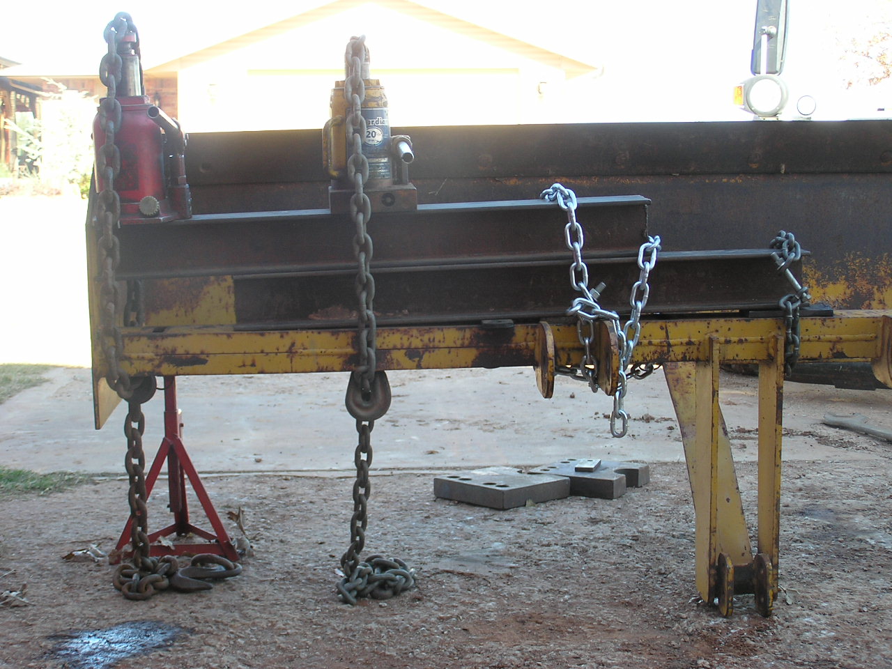

I have straightened many things with a jack and a chain. It just requires getting the pressure at the right place.
For the bucket, I would take it off, turn it over, set the base of the jack on the high spot and run the chain over the jack and under the lip of the bucket, one loop, connected to itself.

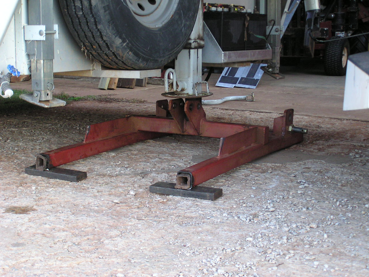

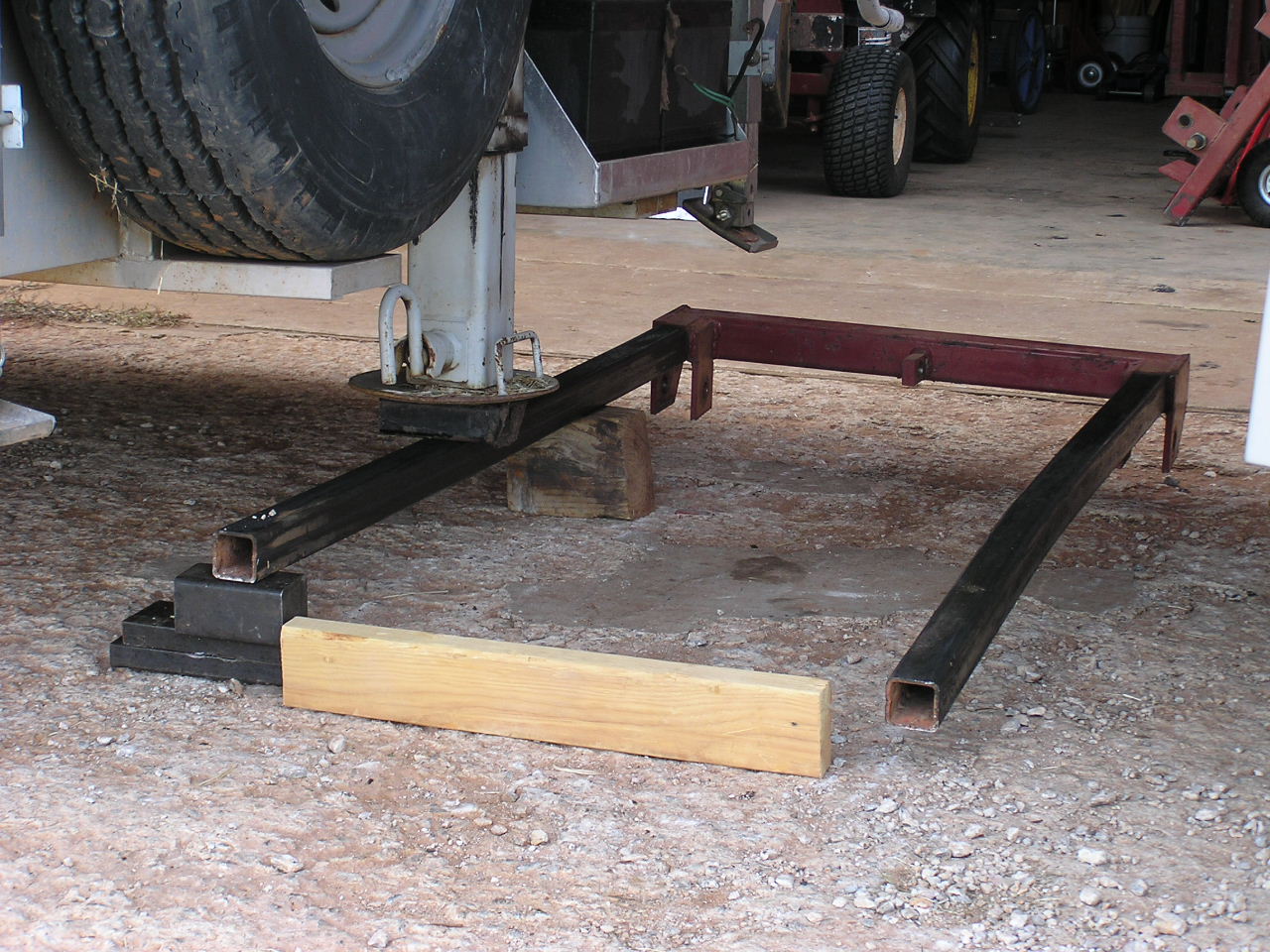

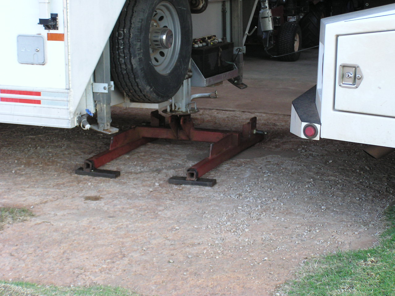

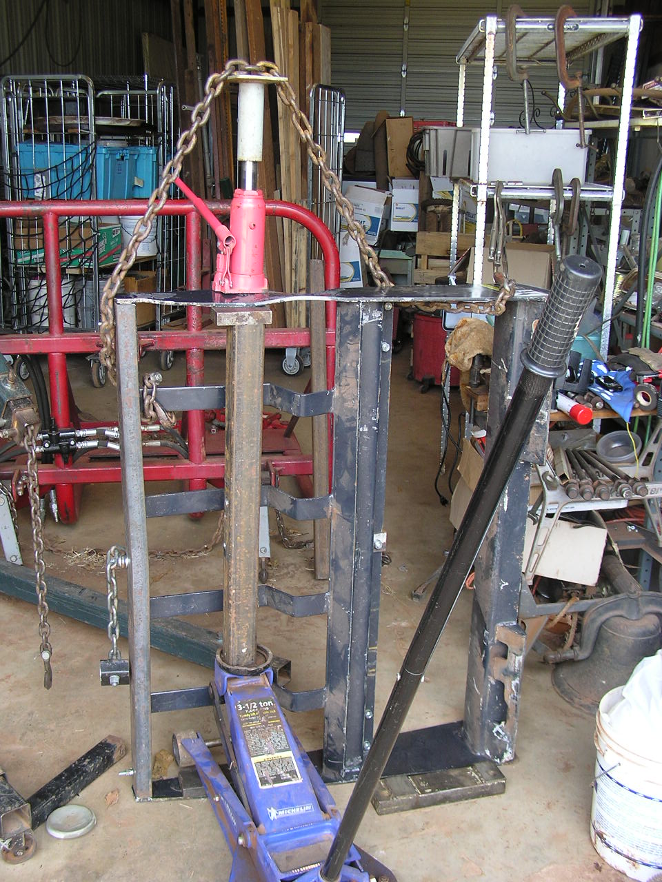

Here is another method for straightening large items, if you have a gooseneck trailer.

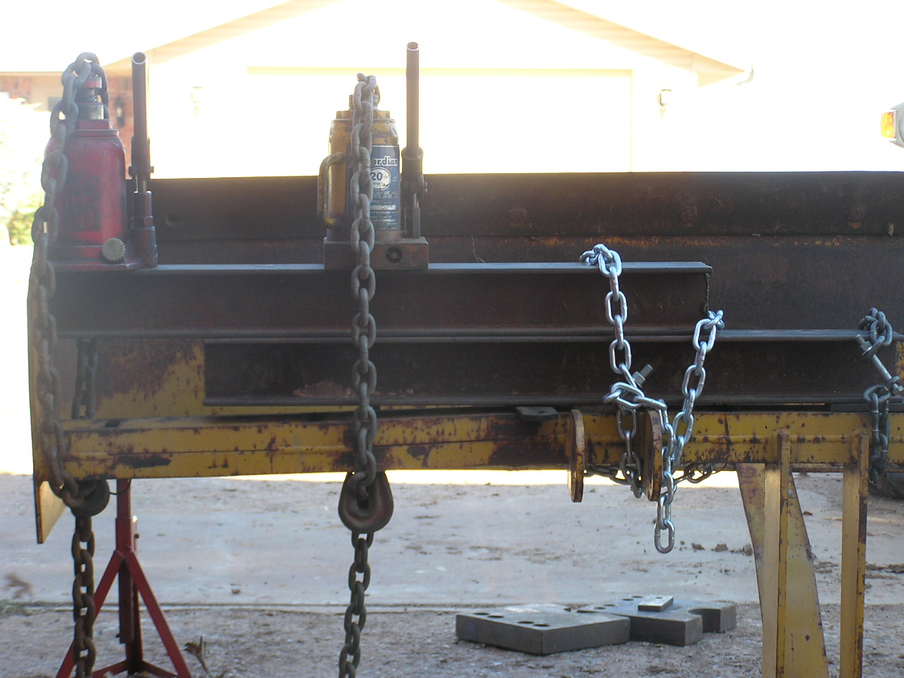

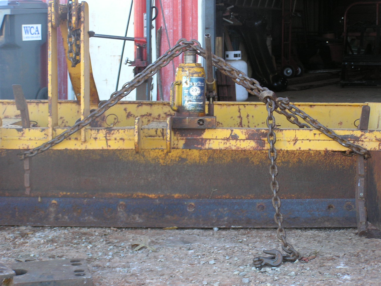

I'm trying to follow this. Would you put the jack under and against the bucket lip? Seem like jack would slip sideways as the chain gets taut, and/or you'd be pulling the chain down where it goes around the front of the lip? Would this counter the jack pushing up on the lip from the other side? Or would you put the jack on Top of the bucket, tighten the chain and hope the lip is the weak spot that bends? I'm really interested to see what works (i.e. what can turn my smile into a frown, or preferably just a grimace. Yes, it was clamp on forks lifting a stump ball/rear wheels. )
Xfaxman explained my idea perfectly in his pics. It would be easier with the bucket off and upside down.
