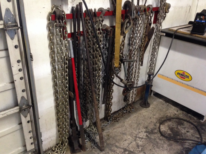

You could always hook a ratchet strap, come-a-long or even a chain and boomer to a tree or solid object and just pull it back. If you have a welder put some extra bracing/gussets on the skid shoe mounts. There just going to keep getting bent the way they are.

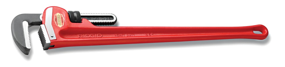

Here are my most used tools for straightening bent metal.
A 24" adjustable wrench.
A 36" pipe wrench.
Usually with a 4' cheater pipe! :thumbsup:

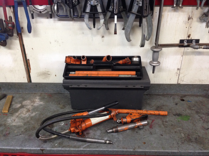

If you had access to a porta power unit, it and a little heat would prob do the trick.

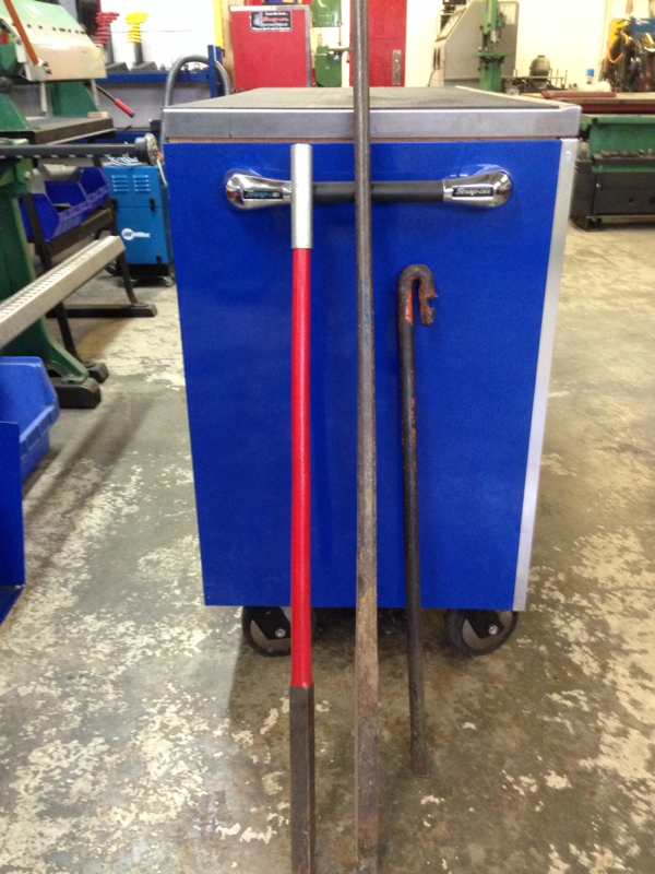

Mine has been well used over the years. Also start your collection of different size bars:
A 36" pipe wrench.
I forgot about my 36" pipe wrench but it's been a real charmer over the years. I have bent things back into shape that didn't seem bendable. If you ever see a used one, buy it.
