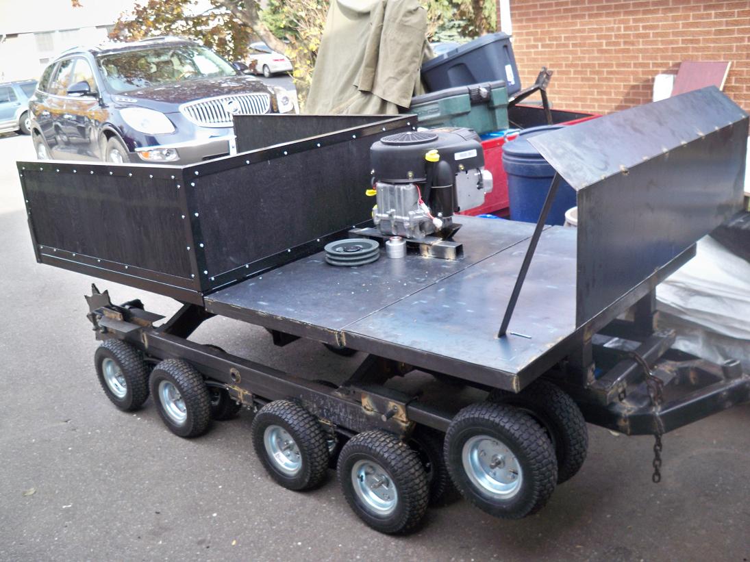

I understand the 2-3 x rule for tank size but realistically, I don't want to carry 200 lbs of hydraulic fluid on a 1000 lb machine. I have a large cooler to take care of the heat. Besides, I don't even know if this thing will move. While I bought a weld on fitting to install a larger filter screen, I think I will go without for now and use a 1 1/4 id suction hose.

Are you saying that you have a 18 GPM pump? A pump that size at 3000 psi, will need a 37 HP engine.
My Power-Trac, will pump about 22 GPM using all three pumps, and needs all of the 45 HP
My hydraulic tank holds 20 gal and the machine has a hyd radiator and fan.

Interesting that when I first indicated I had a 10GPM pump I was told in need 15hp. Then I see that someone using a 28gpm pump for a large log splitter needs 16HP? I realize a log splitter is mostly filling an unloaded cylinder and just a short high pressure cycle. I have a pump that is rated for 2500PSI and 10GPM at 1000 RPM (3,000 RPM max). I will be running this pump at 1650 RPM (Engine govnd at 3300 RPM) via 2:1 reduction. So in Theory thats about 16.5 GPM. My motors are rated for 2450PSI. I have no experience with hydraulic motors but the specs say it will produce 3,000 inch pounds intermittently. so if I run my system at 2450 PSI two motors will produce 500 ft lbs torque into 10 inch dia wheels. Anyway, I have seen so many different opinions, I will just have to try things. I will start with 2000 PSI and work my way up to 2450 if necessary to make this thing turn. If it still does not have enough power, I will consider further reduction between motor and drive wheel. If it lugs my 27hp engine but otherwise has power, I will change my engine pully.

Simple formula: GPMxPSI÷1714=HP. Your engine should be big enough.
