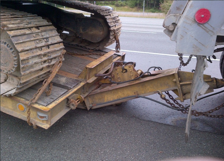

An excavator hit an overpass, causing the trailer tongue to break, or vice-versa.
PHOTOS: Truck pulling excavator hits I-5 overpass | Q13 FOX News
But this photo caught my attention:
I often see dozers and excavators tied to the tracks. This has never looked safe to me, but I see it a lot.
Bruce
