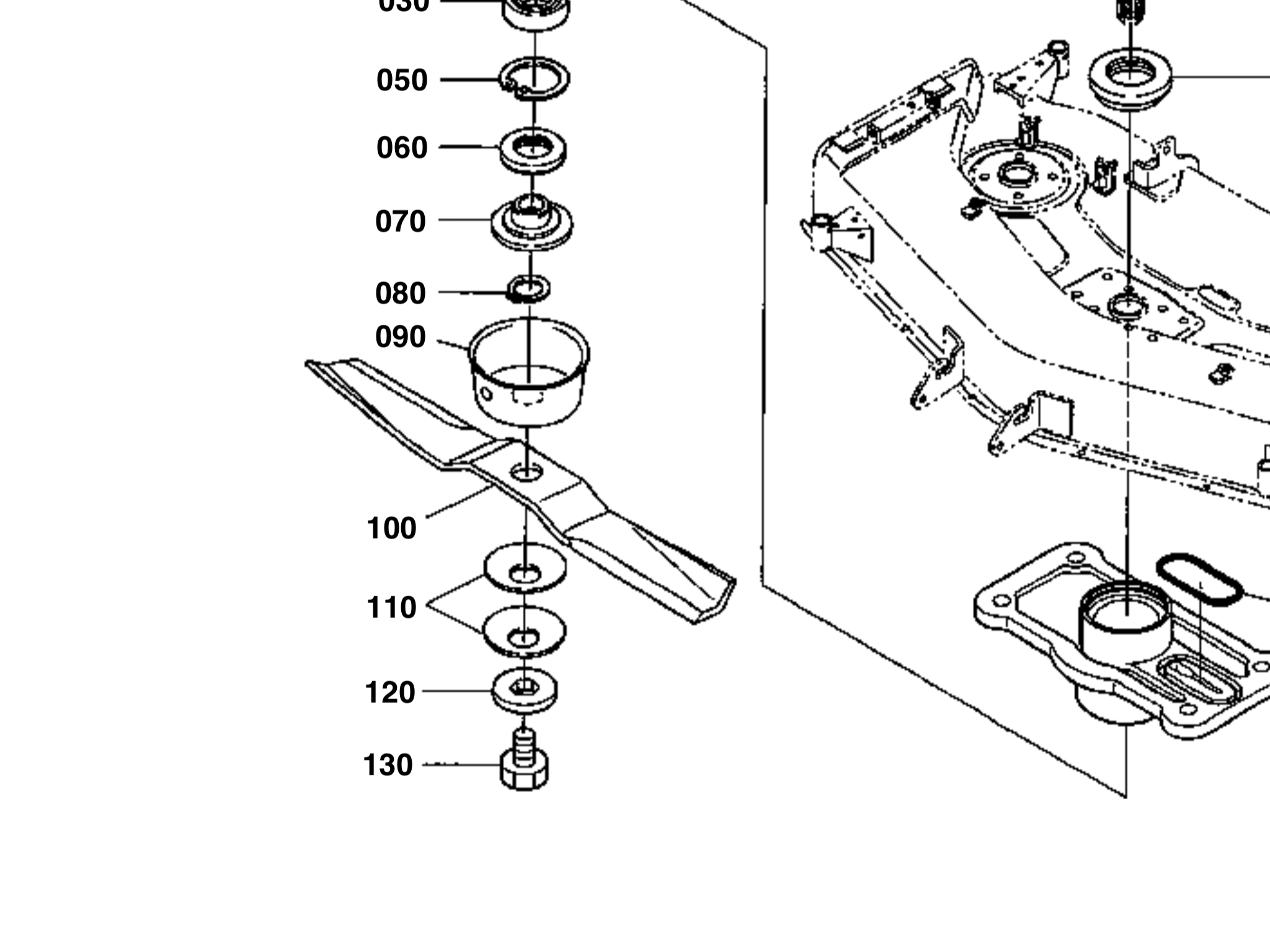

just an update - one spindle bolt became loose and now its not backing out. i ordered new bellville washers and it should arrrive tues. hopefully they should resolve my issue.

I think what happened was you stripped the spindle threads somewhat initially. Then you bought a tap to chase the threads, and restored them somewhat, but not to their original condition.
Apparently this one spindle now has threads that are further damaged. When you chase the threads again the result will be even less strong. The Belleville washers require a certain amount of torque on the bolt to compress them.
The question is: After you chase the threads a second time, will there be enough threads left to hold the bolt at the needed torque?
If not, you may be looking at replacing the spindle. Perhaps a HeliCoil could be used?
Another option might be to drill out the existing threads and tap to the next largest close size, be it SAE or metric.
If whatever you might try fails, nothing is lost, as you will have to replace the spindle anyway if the bolt fails to hold.

The height of the washer stack is extremely important. Too short and the bolt clamps only the washers leaving the anti spin washer and blade loose. Too long and you have a good clamp but the anti spin washer does not engage the spindle enuf or at all. That can let the spindle turn on the bolt, tightening and wringing it off.

In other words, are you saying that if the cup washers are flattened (deformed), the stack will be shorter and therefore the cup washers will not perform their function properly?
Are you also saying that if the spindle/bolt combination slipped on the blade, and then the blade grabbed the bolt for whatever reason, the bolt could experience excessive torque and snap off?

Actually it is the working/compressed stack height that is important. The anti spin washer has a hex shaped hole to engage the hex on the end of the spindle. You need good engagement but cant go more than the thickness of the washer because it will bottom out on the spindle hex and wont flatten the spring washers fully flat to then actually pinch the blade tightly. (Clamping force is way above the point that flattens the "cup" washers.) I have had to tailor my washer stack with a thin extra washer above the Belleville/spring washers - due to wear I guess.
. . . And yes, without the anti spin washer doing its job, blade slips can act to tighten the bolt and wring it off.

Are we talking about the same mower? I am out of town so I cannot check mine, but do have this screen shot from a parts manual I downloaded.
Looks like the dust cover is the only thing between the spindle end and the blade surface. On the other side of the blade are the two cup washers, a lock washer, and the bolt goes through the whole works and pulls everything tight against the spindle end.
I see no anti-spin washer. Am I missing the obvious? Would not be the first time. :)
Looking at this drawing it seems to me the important consideration is the state of the cup washers. Height of the washers would define whether they are satisfactory or need replacement I suppose. But this value is not given...:mad:

Part # 120 is what I am calling the anti spin washer. - - By its internal hex it "keys" to the spindle tip. Since the bolt screws into the spindle, any slip of the blade must be isolated from the bolt lest the slip force spin the bolt tighter and tighter. That washer provides this isolation.
The cup/spring/belleville washers spread the clamp force nicely on the blade but they operate totally flat. Older, well used cup washers dont spread the clamp force quite as well, but its the flat thickness of them in their position that is most important. Their spring force is trivial compared to the force applied by the bolt. That force must come directly to bear as a pinch on the blade before the anti spin washer and bolt bottom against the spindle nose.​

At the risk of beating this horse more than anyone would like...and since the conclusion by Radioman that he caused the thread damage by over torquing the bolts is likely true, I suppose there is no damage in talking about the mechanical set up a bit more.
I assume the spindle has a hex shape only towards the end, and the part where the blade fits is circular. If so, if one were to put the anti spin washer on the shaft end, there would be a certain space between the dust cover and the anti spin washer, when the anti spin washer hit the end of the hex portion of the shaft. The question becomes: Is this space greater than the height of the blade plus two compressed cup washers, or not?
Spyderlk, you mention you feel the pressure applied by the bolt pushing on the anti spin washer far exceeds the pressure exerted by the cup washers themselves. This could only be true if the cup washers were fully compressed and essentially acting just as flat washers would. If so, then why have them to begin with?
My guess is that the system is designed to operate with the cup washers NOT fully compressed, so that a blade will slip if it strikes something hard in the ground, thereby reducing the mechanical shock felt by the spindle somewhat.
Without looking back, I believe Radioman also mentioned there was only one cup washer on his spindles when two are specified. If so, there would be more of a tendency for his blades to slip than if two cup washers were in place.
I guess what I am thinking is that the anti spin washer probably bottoms out on the spindle end BEFORE the cup washers are fully compressed. And that the cup washers serve as a bit of a shock reliever if the blade impacts a solid object like a rock.
As I recall, the hex on the ends of the spindles on our bx2660 is somewhere between 1/2"and 3/4" tall.
Slightly taller than the hex washer and the two bellevue washers when compressed.
