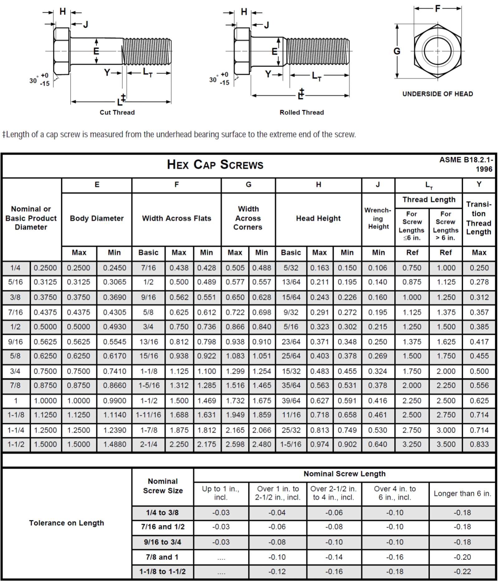

I feel like I'm beating a dead horse but figured I might as well pass this along. Sent Irwin an email when I started this thread. Just got a response today. According to Tim from Irwin customer service "you need to measure across the corners of the Bolt head, then pick the equivalent size for the Stud. In this case, the 3/8 Bolt head is equivalent to a 16mm Stud".
According to the chart below a standard 3/8" bolt measures .650 - .628 width across hex head corners. I did the conversion for 16mm to inches and it came out to .629". According to Irwin a 3/8" extractor would be used to remove a 16mm stud. Irwin says their extractors are sized according to hex size not nominal shaft size. So based on your experience (Vince) and the email I received from Irwin different manufacturers apparently base their sizing on different criteria.
