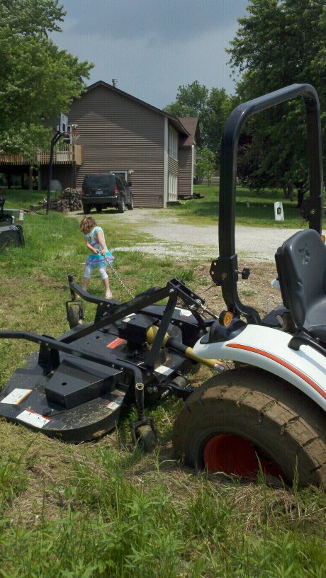

Managed to get my CT230 4x4 stuck in a sunk hole...will it hurt it if I pull it from the back draw bar...or do I have to pull it from the front
/ Stuck 4x4 CT230 #2
Take the mower deck off and attach the bucket and use the bucket to lift the front and inch forward, inch it forward in gear as well. Once you get the front out the big back tires should help you climb out. Use your dif lock if you have one.
/ Stuck 4x4 CT230 #3
Safest palce to pull from would be the drawbar. Get the mower off and out of the way, then put a clevis in the drawbar and pull from there. To bad you don't have the bucket on, you could assist with the pull by using the bucket to raise the front and use the curl to help push back a little.
/ Stuck 4x4 CT230 #4
Do not think that is stuck its buried. And yes you get my vote for pic of the month azop when I saw the little pic I thought it was photoshop'ed sorry and WOW.
Draw bar do not think there is anywhere up front that can take the abuse thats going to be needed to get that out you will either damage or bend the loader arms and I know the guard will fold like a napkin or just get ripped off. and same goes for axle you will rip or tear something up or off. Good luck let us know how you make out

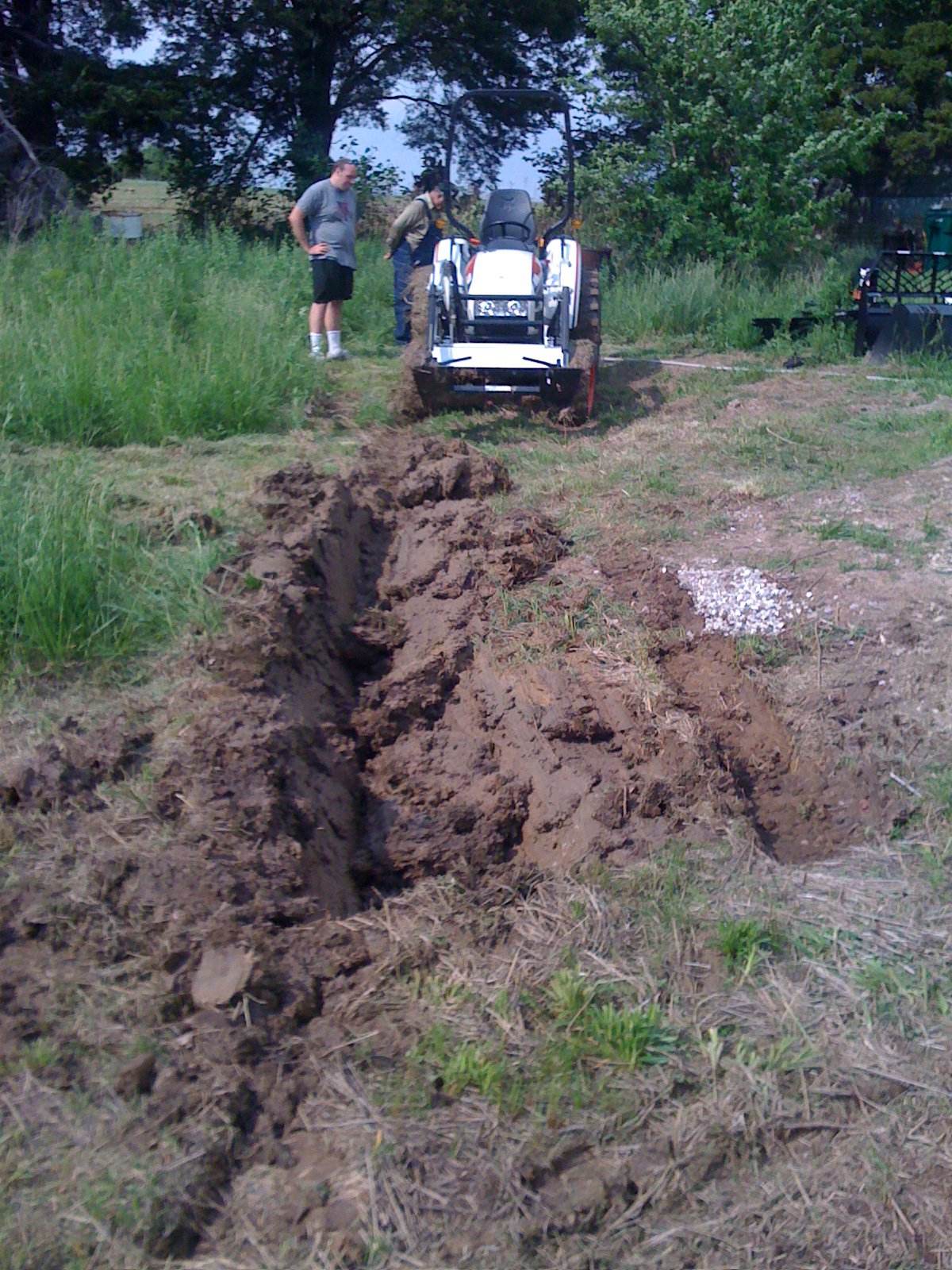

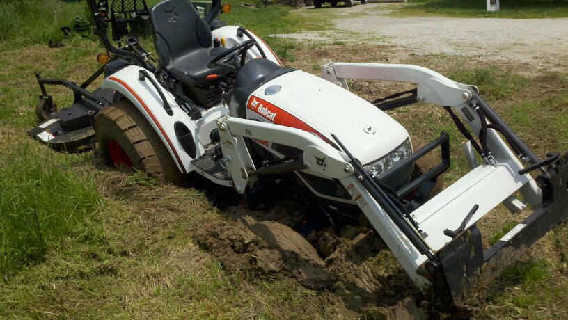

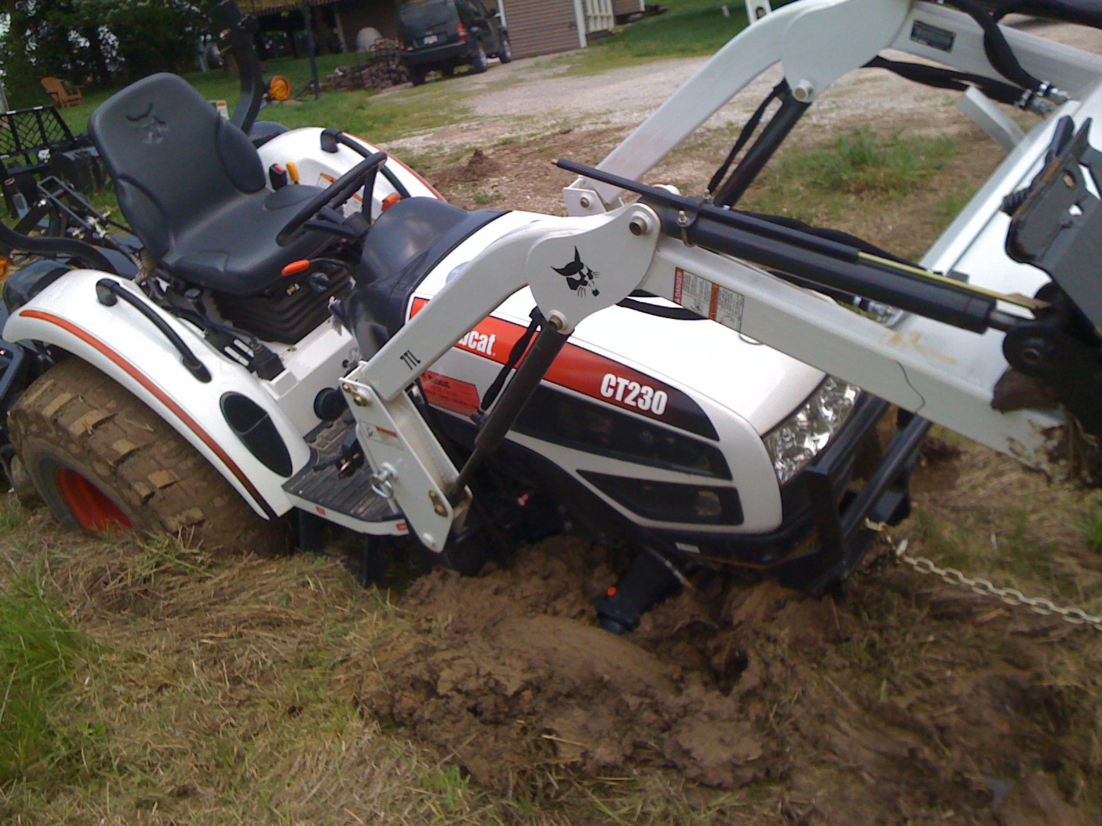

So.. here is the story. I decided to mow a section of a lot that was next to my house that nobody maintained. Turns out...I found a busted water main (which explains my neighbors not having water pressure for 4 months). I sunk *immediately* into about 2 feet of mushy clay, and tried to get out with the 4x4 and differential lock and just dug myself another in another foot.
After trying to pull it with my Chevy Z71 forward, backwards, and on the side the only thing I managed to do was move it forward about four inches, at which point the clay sucked the front tire off the rim. I was pretty pissed off when I saw that, but my father in law came over and hooked up a block and tackle to a tree and then drove slowly with his truck which pulled me right out.
All and all, it was a four hour "adventure" when I just wanted to spend five minutes cleaning up a small area of that lot. I'm not sure why, but the when I pulled it out the tire went right back on the rim and still had air pressure.

Glad you got it out all I can still say is WOW the Bobcat looks so clean in the pics then you see the bottom half.
just a sidenote nice too see that the guard stood up to pulling on its stronger than I gave it credit

Looks like your helper in the second pic has the situation under control:)

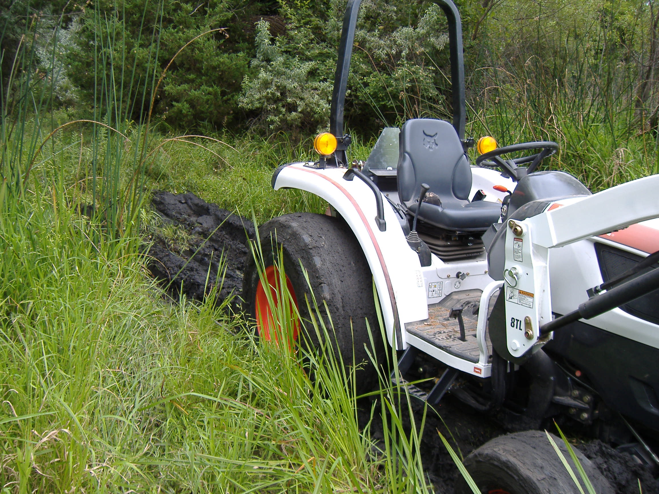

I also know the feeling of getting a perty new tractor stuck. here is mine
