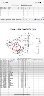

Hi. I’m a hobby farmer and new to mechanic inclinations. I replaced the leaking seal cap on the back of the shifter cover last week. It’s a simple round plastic piece. I got that all done. No leaks. I put my tractor back together and now can only use two gears. No reverse. When I put in reverse or first gear (both on same side of shifter) the tractor will stall. I took it back apart to make sure the handle was aligned properly and still the same thing. I’m really frustrated. Any help is greatly appreciated. I can afford to miss garden planting for our family. Thanks.

Could you post a picture of what you worked on, trying to understand what seal was replaced and being an HST how you could affected the gearing position in the transmission.

Fluid is good. Filled it up when I put all back together. Attached is a picture with the replaced seal cap circled in red. I didn’t move anything that I know of, but I’m not sure if anything moved without my help. Thanks so much.

Maybe the tractor was in gear when you took the stick and housing out, or you put it in gear while removing the stick and housing.
If you shifter has a H pattern and only has half of the left to right movement, than try this;
shift to neutral, take the shifter out,
put it back with the stick leaning to the other side and try if it feels normal again.
(if the stick is now leaning left, put it back in leaning to the right for example)
