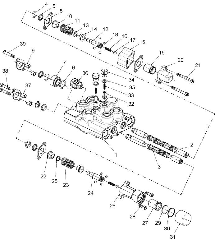

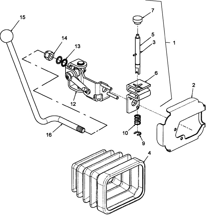

Dave, my tractor has a lock, but only only affects lift. Bucket curl/dump has no lock. What our tractors normally have with a joystick is a diverter valve. The diverter valve has two positions: one for tractors with no loader; one with tractors with a loader. I think I'd be tempted to rotate that valve to the non-FEL position and back to FEL just to make sure it is in the right position. I'm thinking that this problem is mechanical rather than a hydraulic lock and I'm just suggesting these hydraulic lock fixes because they are easy and don't require disassembly of the joystick.
All that said, I've attached two diagrams of the TC26DA joystick and its dual hydraulic valve. The joystick DOES have a lock as is shown by the assembly labelled "Item 1" in the first diagram. Also, on the joystick valve, there are two caps (item 34) that could be loosened to relieve any internal hydraulic lock, but for some reason, I don't think that will be necessary.

I called my dealer and told me that many of the FEL installed about the time I purchased my tractor had the handles screwed in too far. I backed out the handle 2 turns and all is well. Evidently with the handle screwed in so far it was bottoming out and preventing the valves from actuating. thanks for the help.
