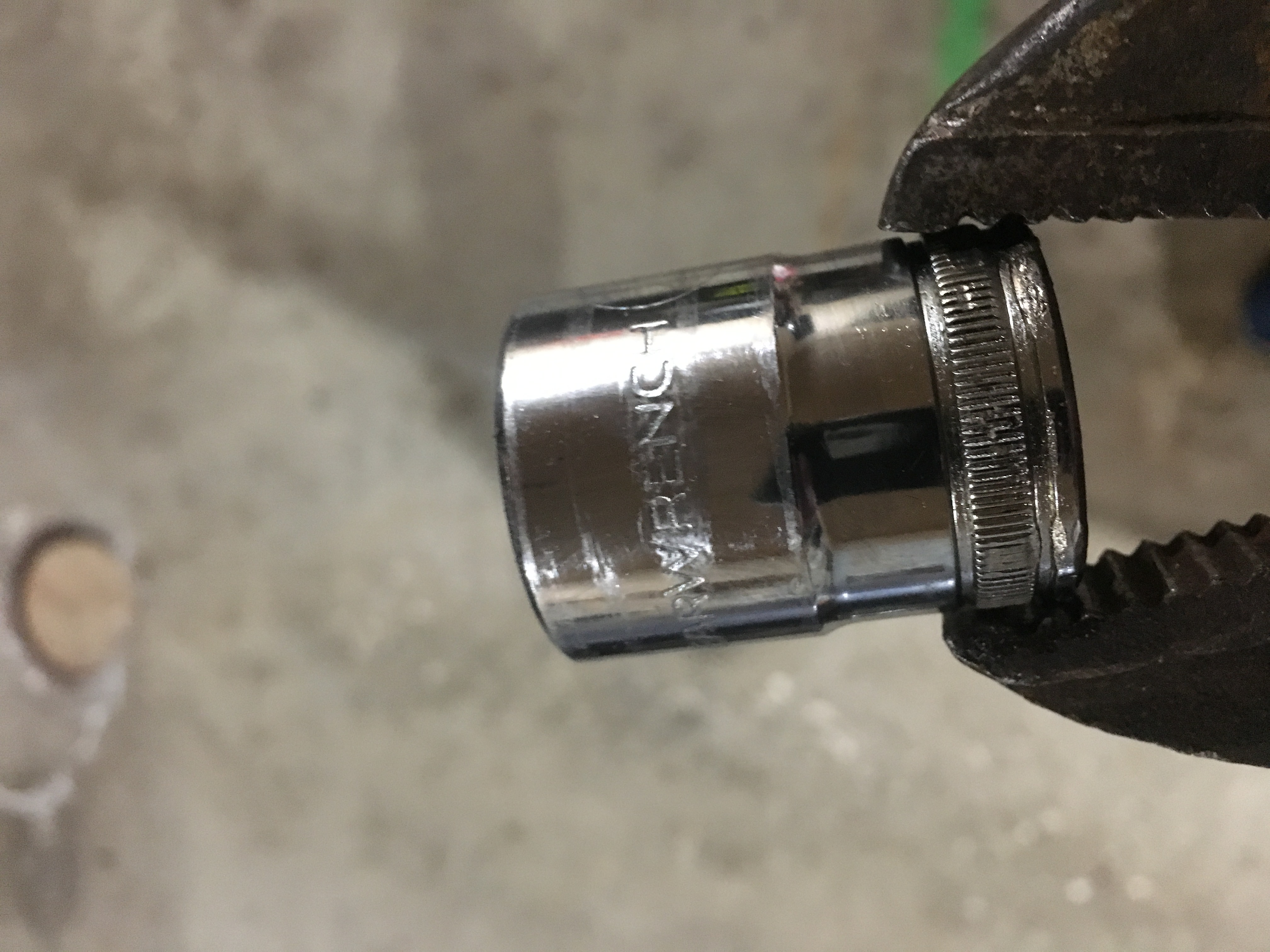

What a crappy day. Went to install my new wheel spacers and the socket stuck in the hole on the third bolt. I got it part way out but it痴 really stuck in there. Any ideas?

Can you loosen the nut? Maybe the nut will drive the socket out of the hole then?
/ Stuck socket in wheel spacer #3
Second reversing the socket and using the nut to drive it out. Squirt oil inside and out first so it will lesson the chance galling and put a big breaker bar or hd impact on it and let her have it!
Only problem is the socket isn’t touching the bolt... I was able to pull the socket part way out. I’m nervous about pounding the socket back in and getting it stuck more.
/ Stuck socket in wheel spacer #5
Put a long extension in it and work it back and forth sideways until it comes out, again squirt it with oil in and out. Other option is a slide hammer with a hook that can go in the drive hole.
Got it out! Charged the battery for the impact driver and sprayed lots of lube and Let it rip. Turns out the markings on the socket were the problem. BCF6B81C-FF47-47B0-A597-92C42BAB8E08.jpeg
/ Stuck socket in wheel spacer #7
Yep. Those knurled grooves were not going to help you out. The clearances on the spacers are so tight, you need a smooth-wall and/or thin wall socket for sure.
/ Stuck socket in wheel spacer #8
Look at the original picture and the marks on the second picture. It wasn't the knurls, but rather the raised edges around the stamped letters/numbers. Some emery cloth might help knock those down without degrading integrity of the socket walls.

Here’s an update. I originally thought the raised lettering was the problem. Today I ground all the lettering and knurled edge off the socket. Tried tightening a bolt and the socket wouldn’t come out, but this time I was smart enough to loosen the bolt and I was able to get the socket out. Not wanting to repeat last night, it was off to the parts store for a new socket but this time I take the spacer with me to make sure it fits right. Well, the new socket didn’t work either, at least not until I ground it down a lot, tapered the front and smeared it with oil. Then it worked okay as long as the socket was lubed. I think the holes in the spacer are all out of spec and something is preventing the socket from coming out when the bolts are torqued down. If I loosen the bolt a bit I can remove the socket, strange.
