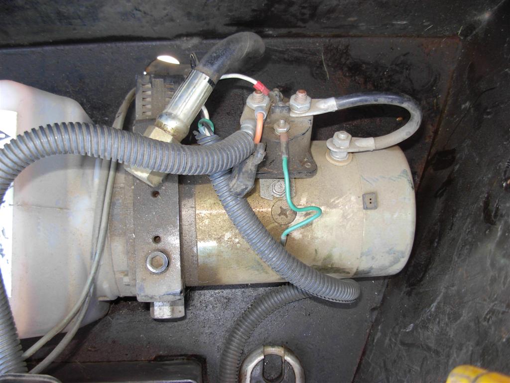

I was at the dump today, pull the tarp off the trailer, open the tailgate, push the button and watch the dump bed raise all the way to the top, drive the truck forward tell I clear the load, check that everything is out, then I push the button to lower the bed – nothing happens! OK that’s odd, push the button again, still nothing.
Oh boy…. this is Not Good!!!! What do I do now? I’m at a dump more than 30 miles from my house, the dump trailer bed is stuck all the way up, and I really don’t think I can drive home like that!!
I have to say I know next to nothing about hydraulic systems much beyond the basics. But electrical I understand and the control is electrical, so I check out how it’s wired and come to the conclusion that the black wire must activate a solenoid that releases the hydraulic oil back into the reservoir. I check the black wire it’s slightly loose so I mess with it, try to tighten it by hand, it still doesn’t work
I also entertained thoughts of disconnecting the hydraulic line which I’m sure would have caused the bed to drop in a big hurry and at the same time spraying hydraulic oil all over the place. Not a great option.
Anyway I messed with it for what seemed like 20 minutes, probably wasn’t more than 4 or 5, and than all of a sudden it started working again.
When I got it home I first checked the trailer battery, checked out ok, 12v. Controls work as they should, bed raises and lowers.
I intend to clean all the wiring contact points, that’s what I suspect could be the problem, but I’m not sure.
I have some questions:
Is there some procedure for lowering the bed in this type of situation?
Is there a button or lever that will release the pressure and lower the bed?
What could be the probable causes?
Suggestions, ideas?
Pictures are; trailer after I got it home, working fine now that it’s home and pictures of the pump.

From what very little I've played with these type of pumps, no 'over ride' button/switch straight out-of-the-box.
Shouldn't be to hard to install a tee, valve and a short piece of hose for the 'next time'.
What happened this time ?, who knows ?
Very hard to tell now that it's working.
/ Stuck-Up.... what do I do? #3
hitekcountry said:
probable causes?
1, No power to solenoid valve.
2, No 'action' from solenoid valve even w/ power (burnt coil or stuck valve).

Well from your picture, it looks like a 1 wire solenoid that completes the coil circuit thru the motor/pump body. It dosn't appear to be a standalone valve, but a solenoid rod that pushes/pulls a valve mechanism located inside the pump body(perhaps pushes open the spring loaded hydraulic safety) to allow fluid to return to the resovoir. I am assuming you either have up and down buttons or a single switch with 2 positions? For up, motor runs and bed raises, for down, solenoid clicks and bed lowers by gravity. Is this correct?
NO click = no current or bad coil. Since it started working again and coils very rarely fix themselvs, I would guess something was limiting your current(bad switch or wire). I am guessing a volt meter on that single wire measured to ground should show +12volts when the "lower" switch is depressed. Check all the wiring and connections back thru the switch. If the coil was good, a small jumper wire to apply voltage directly to that solenoid terminal might get the bed down. If the solenoid goes, your into loosening a fitting as mentioned and dumping a bunch of fluid to get her closed. Not knowing exactly how the solenoid is configured(push or pull), it might also be possible to unscrew the coil assembly and apply pressure the same way the solenoid does to lower the bed. But that might also dump fluid out the port where the solenoid is screwed into. This would be something I would want to test and learn about in the yard and not at a dump 30 miles from home:)

Yes the control has two buttons, the up button switches on the pump and pulls HF out of the reservoir and pushes it to the cylinder. There is only one hose in the system. The down button (pump off) allows the fluid to flow back into the reservoir and the bed drops by gravity.
I intend to check all the electrical connections I suspect contact corrosion, or as you put it a current limiting condition.

Today I called the trailer dealer and explained what happened and the guy said “probably the first thing you might want to take a look at is the switch”. That made me a little suspicious that maybe this is a common problem, so I asked him “have you had problems with that switch before?” He says “oh no we haven’t had problems with it, but we have seen it happen.” Then he proceeded to tell me how to take the switch apart. Gee he sure is familiar with that switch.
I put my trailer in the garage to work on it and the first thing I do is raise and lower the bed a number times and several times it failed to lower. Raising the bed was never a problem, lowering it was hit and miss. I was glad to see that happen because now I can track it down.
Then I put a meter on the wire to the return solenoid and every time I pushed the down button and the bed dropped properly I was seeing 12V on the wire and every time I pushed the button and the bed failed to drop I was seeing 0v. Clearly it’s a bad switch and not the solenoid. Also one of the times I pushed the down button and it failed to work, I took a screwdriver and shorted from the 12v terminal to the solenoid and it worked properly.
