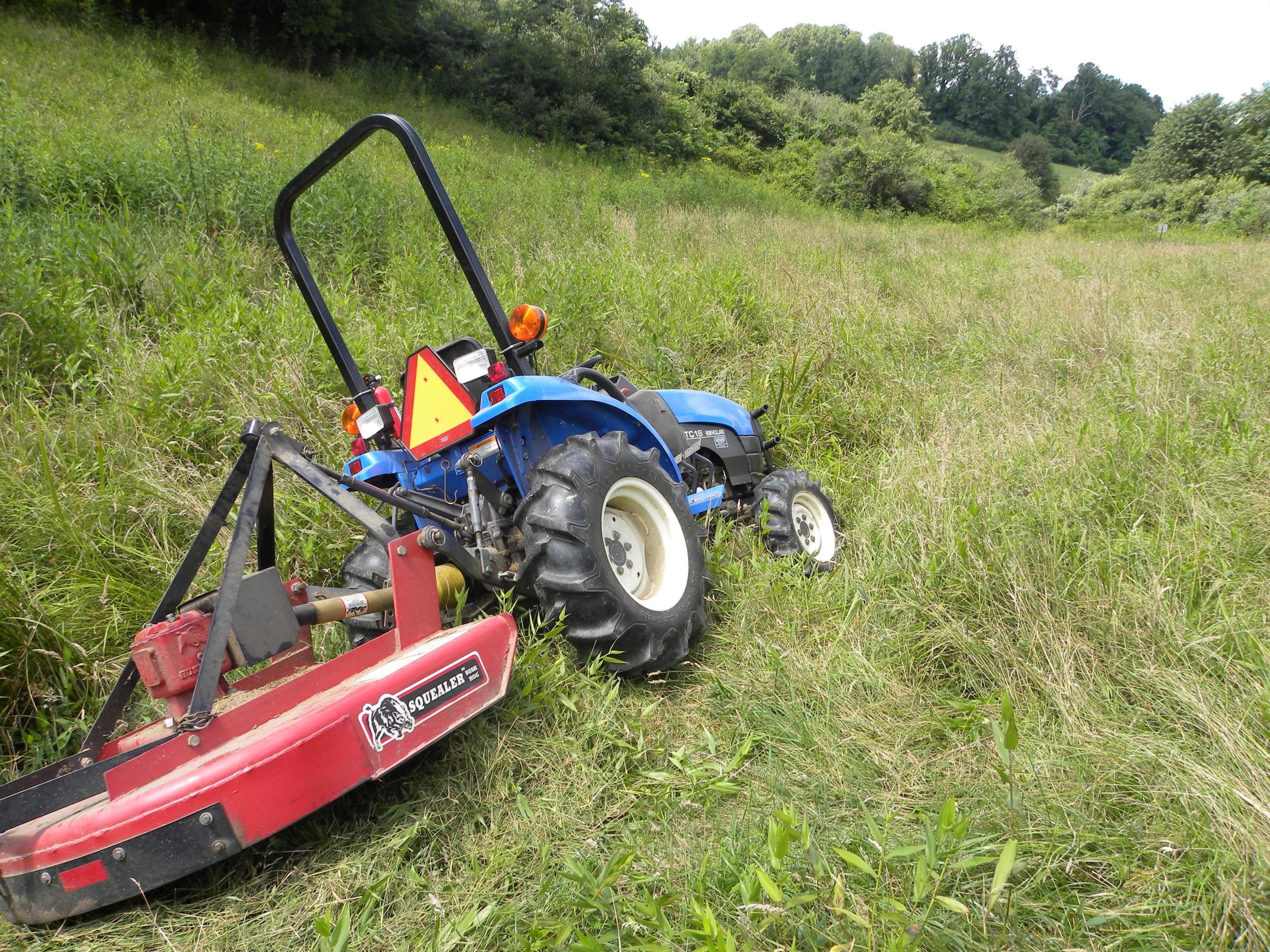

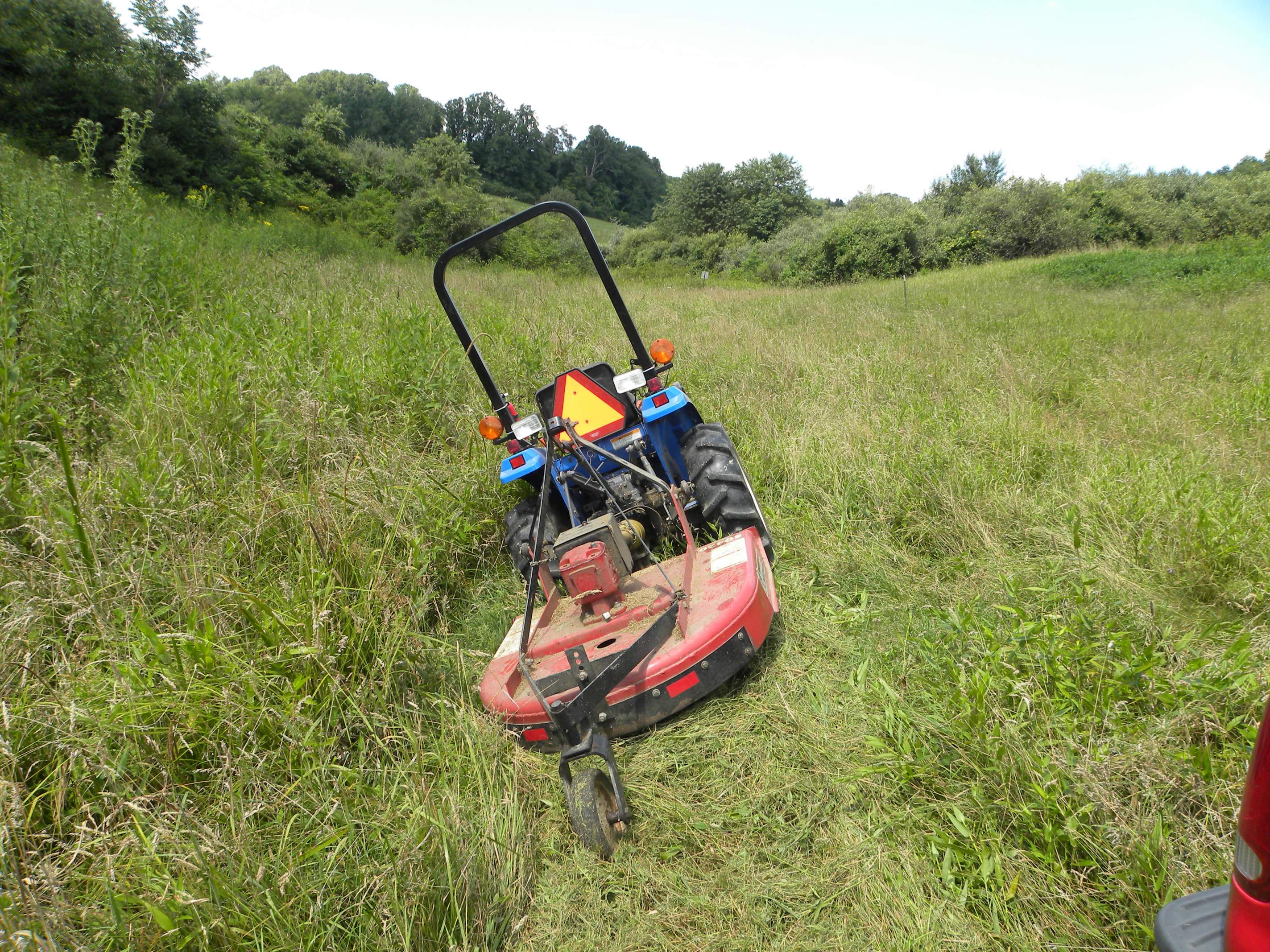

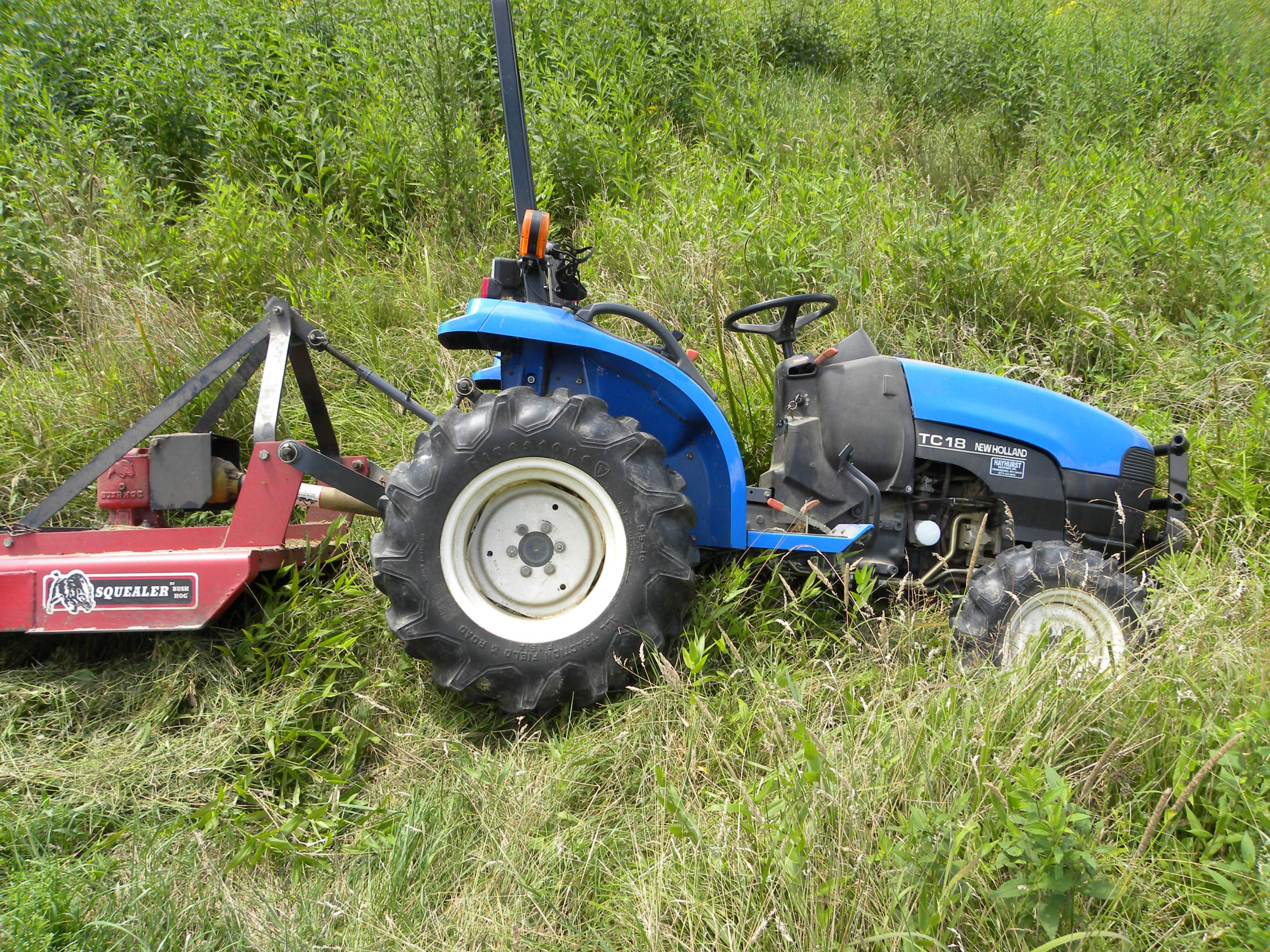

I had just started mowing. When all of a sudden. The ditch was a little closer than I expected.

Holy cow, that is way over on the tilt meter. Glad no rollover.

Fairly easy to get out (except looks like you have the individual brakes on the right side so can't use them).
Raise the rotary cutter (adds weight to the rear wheels). Hold right wheel brake on and back up. Locking the differential might work, but braking the right wheel will put all the torque on the left wheel while you back out. Turn the wheels to bring the cutter deck up hill.

I had to pull it out with my truck.

doesnt look that tippy... (could just be the pic angles)
looks like you could have picked the 3pt up, steared into the ditch and powered out of it.
