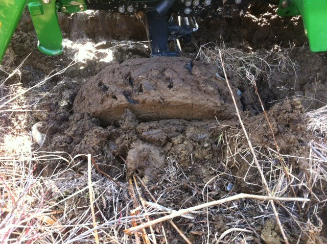

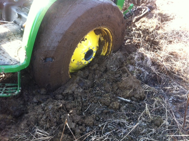

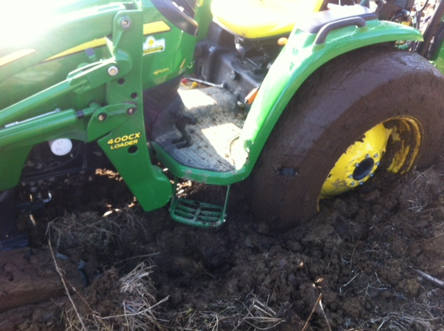

Our tractor is stuck. I work in Prudhoe Bay Alaska. My wife got stuck and sent me these pics.I hope she gets it out before I come home.

yep, gotta get them front wheels up out of the muck.. try to find a big flat piece of plywood, and some good big boards and put under the loader for it to push down on to get those fronts up before you even pull on the rear of the tractor. or if you have enough wood you can put under the front wheels once you get them up. might be able to shove some wood under the backs and get going. If you only had a backhoe on the rear to bring the rears up.

Looks like there is a backhoe on there, should be able to lift the rear enough. Between the front bucket and hoe, it'll come out, just takes some practice!
/ Stuck #8
That is what I was thinking. If that is a backhoe on back you should be able to raise the back. Not sure what your surrounding soil is like but with the loader and backhoe you should be able to raise the whole tractor and swing the back end out to one side. May need some planks as suggested above. Good luck.

I thought you guys would like those photos. I'm hoping she hasn't done any damage to the tractor. The forks are on I'm hoping she didn't bend those trying to pick up her front end. She placed a firewood round 12"x15" under the SSQA and pushed down on it. The round has disappeared from sight. The backhoe apparently wont pick up the back end?? She says she wants to use the tractor before I get home, so she wants to get it out. I suggested to her get some 4x4 blocking and put a beam across them to put under the forks for lifting up the front end then hopefully she can get some wood under the front tires. Place larger 12"x12" blocks of wood under the outriggers and use the outriggers to help the backhoe pick up the back end. Then Put some wood under the back tires, and drive out. I gave her other options such as wait for our friend to get back Friday(tomorrow) from the slope and he would get her out. Or wait patiently till next thursday for me to come home.

Blocks as she found out just push down into the mud.
Some larger pads like a pallet might be better under the forks.
Still is going to be tricky to get wood packed under the tires as that mud doesn't make it easy at all.
And once the wood is under there, driving off over it may do damage to the "underlings" whereas the mud prolly doesn't.
All to often, it is a wise choice to wait until the mud dries some (if there is any hope for that).
