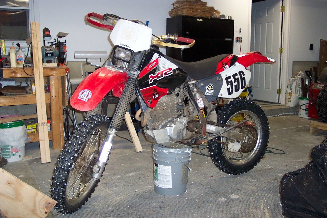

Is it dirt or asphalt? If it's dirt, you don't really need the carbide studs - regular ice screws would probably work just as well for less dough. I never put screws in a tractor, but I have put them into a couple of dirtbikes before - I use hex-head zip screws from my local HVAC place. The screws cost about $15/thousand - cheap experiment, if nothing else.
I'd imagine they'd make a big difference on ice - the traction available on a bike is astounding.
