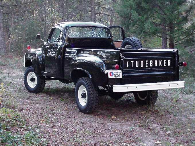

Just wanted to update the thread. I brought home the truck I started the thread about. It is a 55 E series truck. I found two little tags in the pile of parts, one says model E- C2, the other says E7-12. ??? I don't know. It is in pretty good shape, there is basically no rust. Only exception being that in some point in the past someone tack welded in flat sheetmetal in the bed to cover the original corrugated bed floor. But looking up from the bottom it has some small rust holes. The old man that started it did a good job with the metal. He also had already replaced all the brake stuff and rebuilt the engine. When I first saw it I was worried because all the trim and stuff was stripped. But then found it all piled in the inside. I have pretty much every last piece of the truck, except the windshield. It even came with original Studebaker parts manuals, service manuals, transmission repair manual, and 1956 repair manual. I am not 100% sure by reading the engine number but it looks like it has the larger 259'' V8. I was able to turn it over, but I can't get any fire. I am also unsure whether it is converted over to 12v, the old man that had it said it was, but it all looks original and when I pulled the cap off the distributor, the points were so hot they took the skin off my finger :mad: I read that the Studes were originally 6v with a positive ground, so I am really unsure what to do at this point. I can't tell what the truck is set up for. I really don't want to hook up anything wrong and burn something up. I am going to join a Stude forum and start a thread over there and maybe someone can help me out. I am not ready to start work on the body on it, I have a 73 convertible Blazer that I am frame-offing right now that I have to complete and get out of the way. But I would like to get it running well, so I can move it around and maybe run to town on it or what-not. Here are a few pics. Judging by the original color choice thing that was with the paperwork, it was originally "clover green". Not my favorite choice. I know basically nothing about Studebakers, so I am learning a good deal about them. The manuals are great, and full of tons of info. Now if I could only take those part #s out of my manuals and run up to the dealer and buy parts. :laughing:

They are definately different, I think it is growing on me. I have managed to get the truck running, the firing order was jacked, and had to clean all the points and stuff. And the rotor button was worn out. But after I got it to fire and run, found out that the fuel pump diaphram was rotted, so had to get a new pump. And it didn't come in before I had to come to work.

I also found out by running the block numbers that mine has the 1955 259" motor. That was the big V8 for that year, which was suprising. There was a 99% chance that it would have the 224" (Economiser) V8, the old man that had it said he was sure it was 100% original, so I don't know if it was ordered that way or not. I read that basically Stude would build whatever you wanted as long as you had the money. So idk. And also I have so many irons in the fire, I really need to get the Blazer done before I do anything with this truck. But I would like to atleast get it running decent. Then I am thinking of putting a quickie hot rod flat black primer job on it, paint the wheels red, a cherry bomb glass pack (you can't even hear it running now) and cruise around town sitting on the block of wood I have been using as a seat. I have the original seat, just needs some new foam and a cover. The ride should be fairly comfortable during these warm days as there will be good ventilation being there is no glass in it. :D
