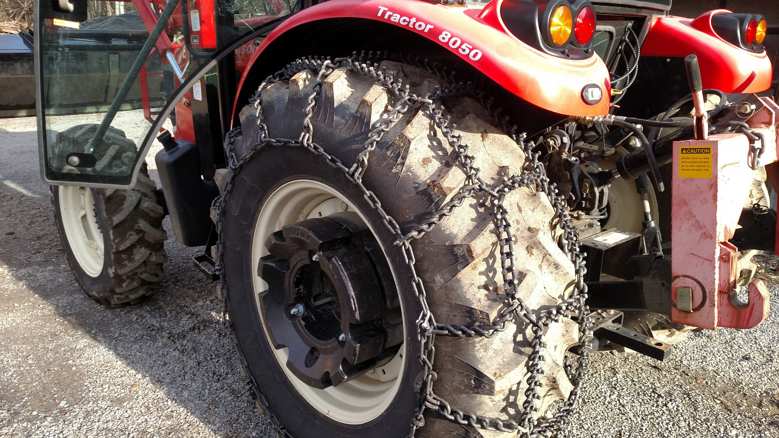

Chains are removable and generally penetrate deeper giving better performance on snow/ice. From what I have seen, studs are installed from the inside of the tire and not removable, and there's plenty of times that I would want to not have concrete and asphalt destroying studs/chains on my tractor.

I run chains on my driveway, the heavy Euro studded style.
I have not seen any damage to the paved roads which we do travel while chained up,
if you spin on a paved road, Yes, they will mark and chew on the pavement.
Normally good chains Euro studded chains will not spin unless you are pulling quite hard.
I road my tractor over 3 miles many times with the chains on with no issues, I do limit my speed to around 12-15 mph.

800' driveway, 80" rear snow blower and double ring chains on the rear. I have been quite happy with this setup for the past 25+ years. I'd like a cab.... Chained up I have significantly more traction in 2wd vs no chains and 4wd with the diff locked.

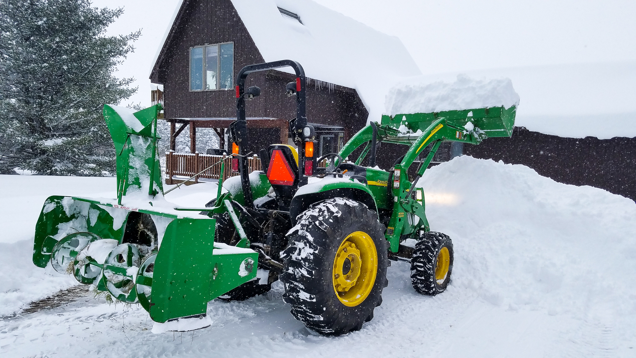

For the big jobs I use my JD4320. It has a loader and snowblower and I never need chains. However, I like to use the Kubota BX2680 for the lighter stuff. I have chains all the way around, and that little tractor is a tiny beast due to the traction the chains give her.
