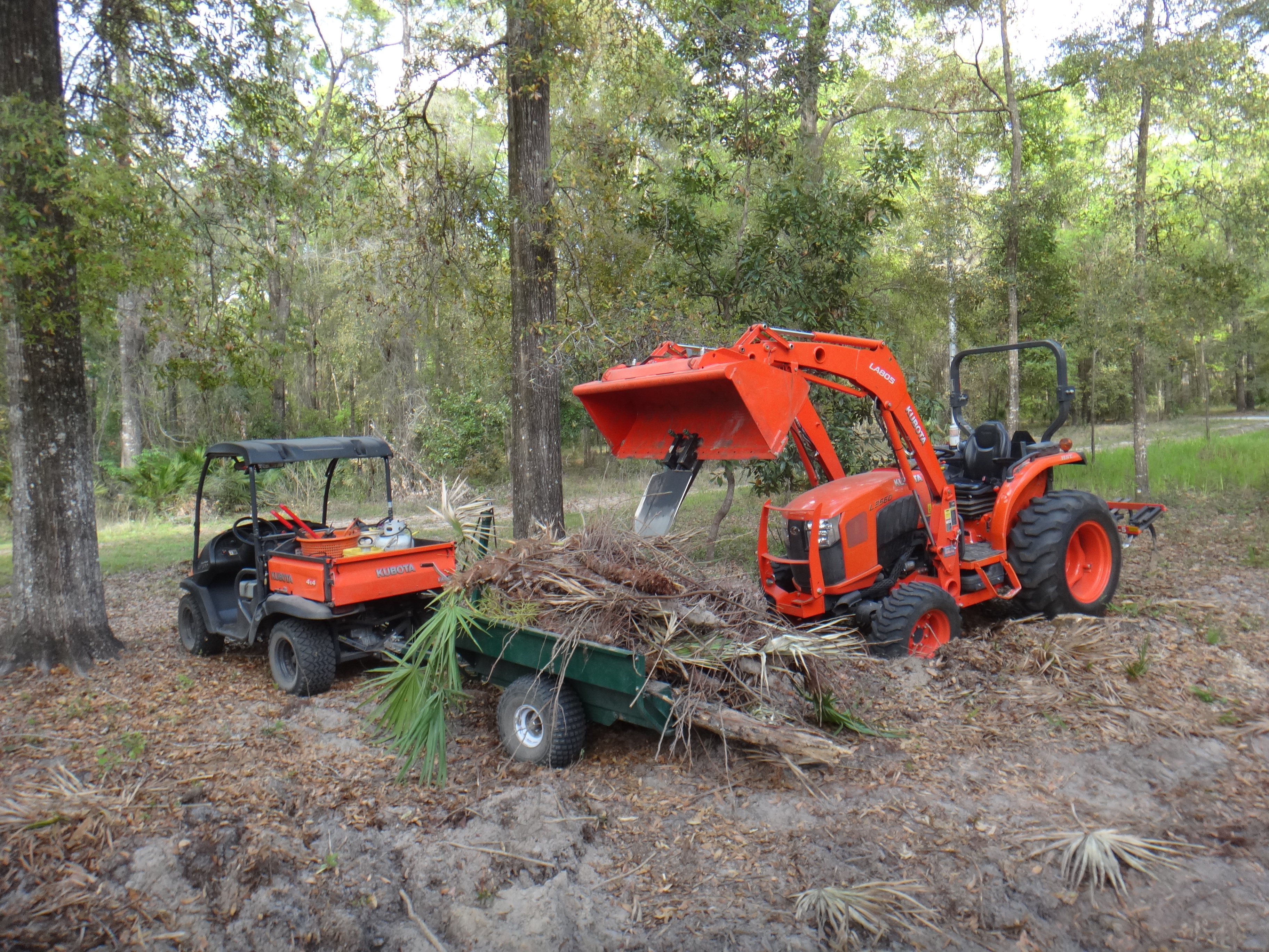

A Kubota L2501 does not have the tractor weight nor hydraulic power necessary to push a stump bucket into Florida soil, nor remove it.
Consider a clamp on Bucket Spade, which is critically shorter, and less critically narrower, than a stump bucket.
VENDERS: tractor bucket spade
