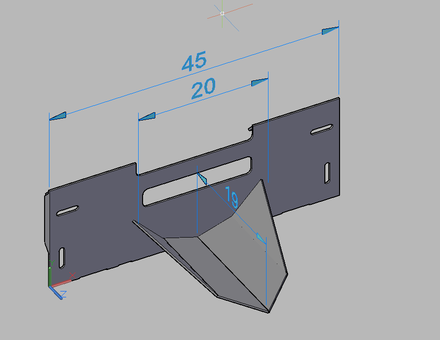

I just came across your bucket design. It looks like something I would like to build. Can you give me some specifics about your bucket?
Size of plates? Length and thickness, kind of steel used.
Thank you,
Jim
   / Stump bucket #13
Thank you,
Jim
Jim,
Here are the dimensions, the plate is a quick attach 1/4" I think, all the steel is roughly 1/4". It was cut out on a CNC Plasma machine and the sections were welded together, the teeth are pointing backwards to cut roots as you stab and pull back on the root. It really works great however I recently bought a 40hp heavier lift tractor and did bend it a bit, not too bad but I had to add some bracing at about 5 and 7 o'clockif you in front looking back on the tractor.Hope this helps

Your bucket looks good. Thank you for the information. I am going to build one. I have a little different idea.
Jim
