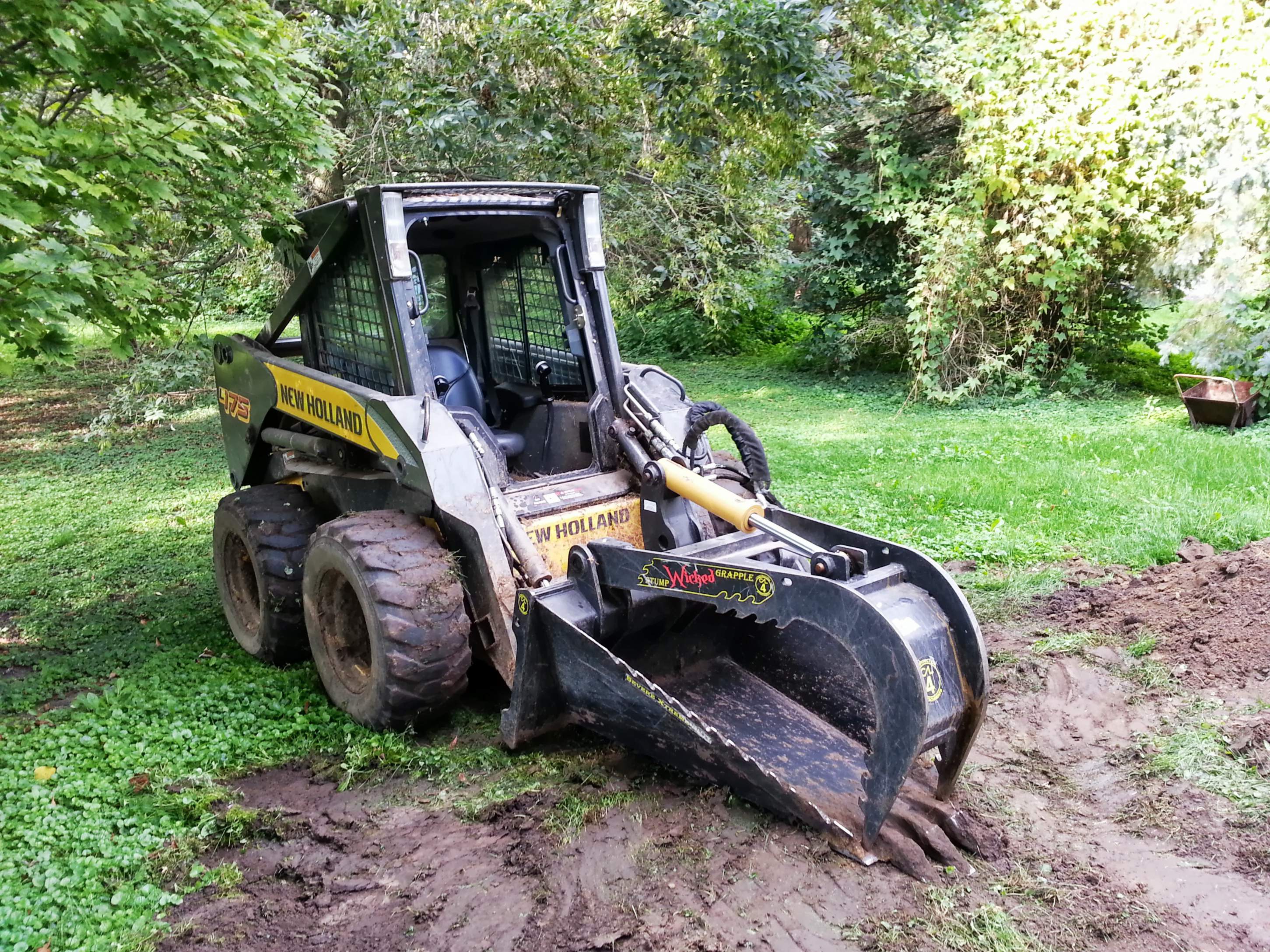

Well, I have a specific need for a grapple to remove cedar trees. I want something to do some digging around the roots to loosen them up so I can then push them over and haul them off. So, unlike a typical grapple user, I will need to dig a little with mine.
I figured that instead of trying to push a typical 50" or 60" grapple in the ground, something like the one in the link below might work better. Anybody have any experience with this one or something like it?
Skid Steer Stump Grapple
ETA has something similar but it weighs 978 pounds and costs almost $2,700. http://www.(Temporarily blocked due to reports of company closure)/Construction-Attachments-Stump-Grapple-Bucket-p/cal-grapple-wickstumpsxd.htm The one linked above from Unlimited Fabrication costs about 1/2 of that delivered to my door.

How big are the biggest of these cedar stumps you are wanting to dig out?. And are they stumps at this time or are they still trees? And if still trees, high high are they and how big around at the base? I have some reservations about how successful you are going to be digging out large stumps. It takes a lot of weight and hydraulic power to just scoop out stumps. More than you would think. Of course the type of ground these are set in will make a difference too. I am not trying to "pee" on your idea, but I would hate to see you spend a lot of money and be disappointed. I don't know how much tractor experience you have, and how many trees you have taken out. I have taken out quite a few cedars in particular.

tractor loader won't be near as strong as skidsteer, that grapple would work best on skidsteer
