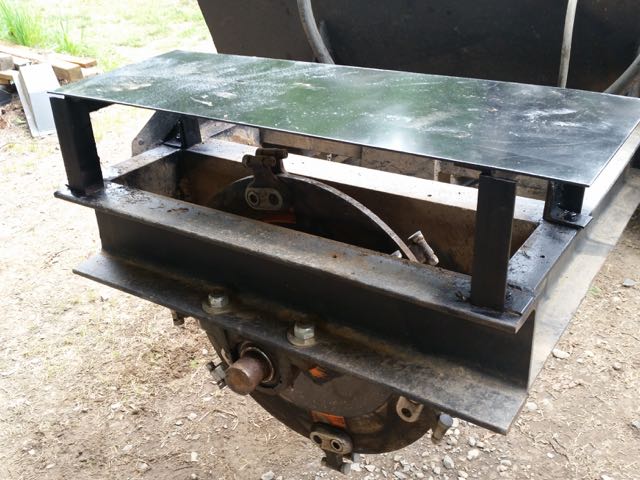

Bumping this back up, wanted to share some mods in case anyone is going to copy the plan.
Primarily the mods center around the use of the stump grinder as a trencher. We laid over 1800 ft of irrigation line and used the stump grinder as a trencher.
First realization was that the clay quality of our dirt clogged up the sealed version of the blade protective cover. So, I made this open air version. What you cannot see is the angle iron down the center that pushed the dirt off to the side.
Let me say this is a work in progress.... The inboard side dumps fine, the outboard side still sends tons of dirt everywhere. I am going to work on this item some more

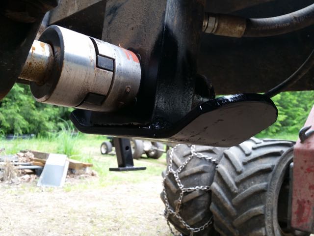

The second mod was a skid. The motor is mounted with c channel. when the grinder is all the way in the ground and pushing forward you get a nasty gouge in the ground (outside of the trench). So I pulled out some 1/2" scrap flatstock and bent it into a mini ski. Just remember you do not want it longer than your grinding wheel cause it will mess you up when you are stump grinding.

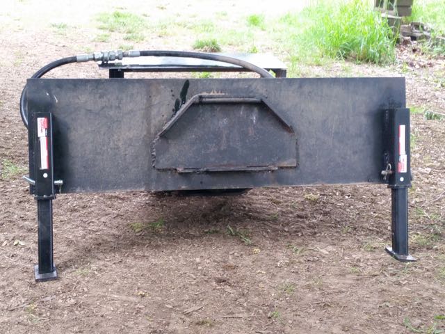

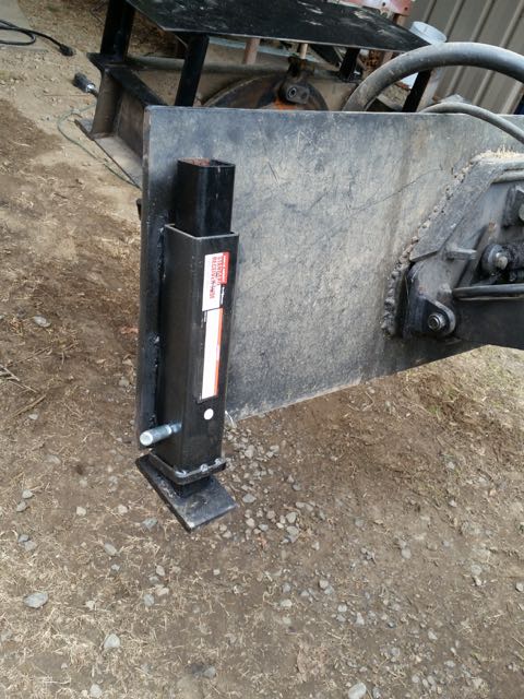

The final item was an aha moment. The attachment sits funny on the ground when you are trying to pick it up. I could honestly spend 2 or 3 minutes trying to grab the darn thing, getting off the tractor, moving it around. The neighbor suggested I build a cart. and that was the direction I was headed in, when I was looking at my trailer and realized I could probably rig up something attached to the grinder itself.
So a couple of HF hitch sleeves, a bit of 2" square and a couple of feet made of scrap and a few holes.
Pictures display standing and what happens when attached to the tractor.
