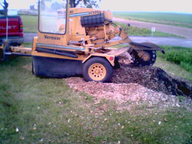

The fastest way to grind stumps is with a machine like this. He took 23 minutes to grind this 30 inch diameter stump 14 inches below ground level. The tree was cut down the day before and the stump was about 10 inches above ground. There was no dust, only chips.

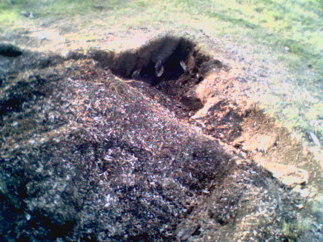

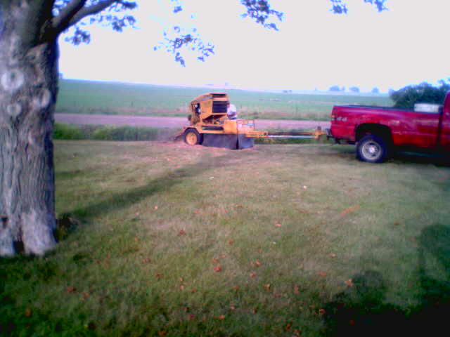

   / Stump Grinder Recommendations Wanted #7
more pics
